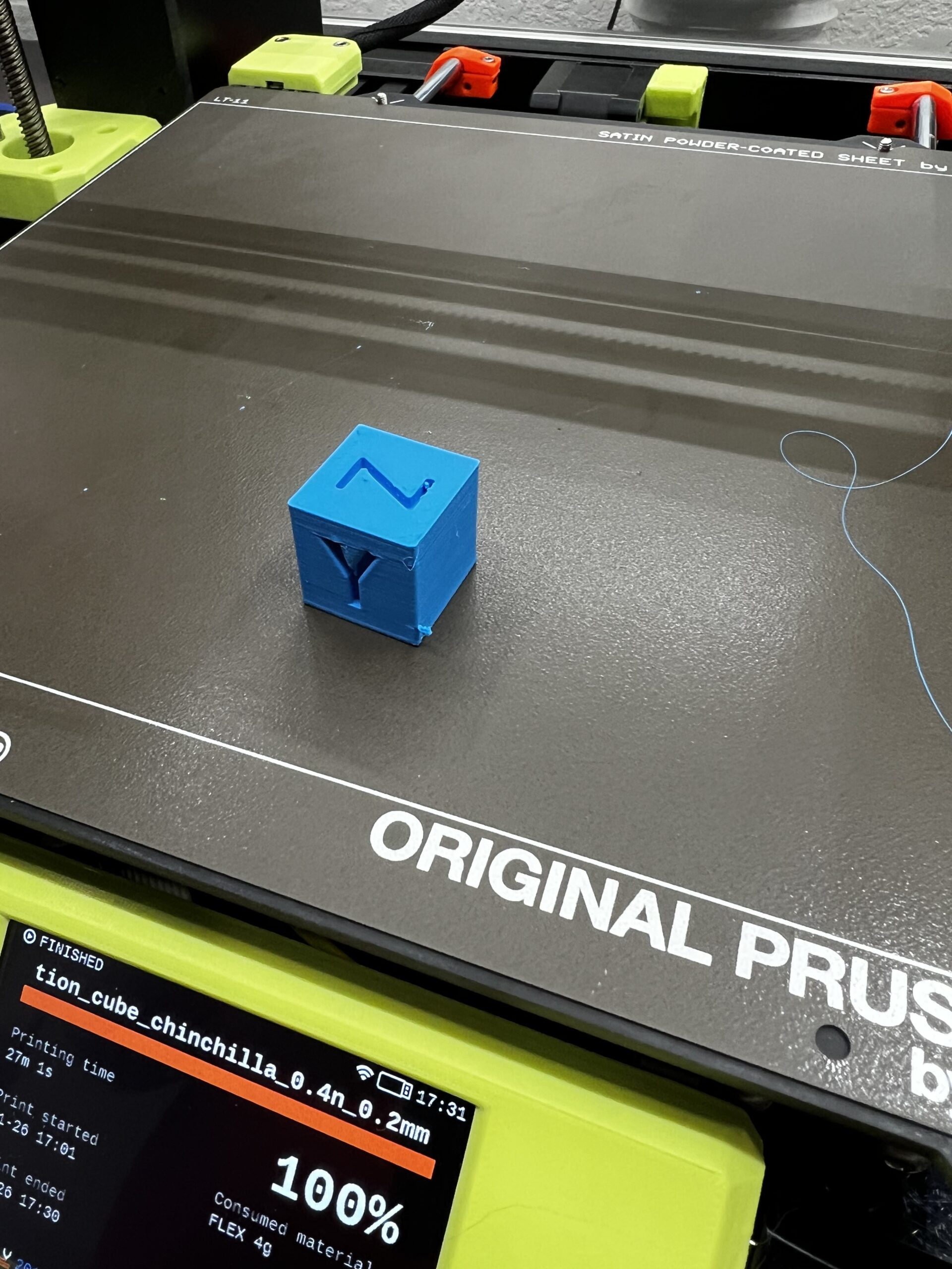

RE: NinjaTek Chinchilla TPE (75A)
I just got a spool in today in fact.  I'm trying an xyz cube on my MK4 first and so far it's going fine.  I took the ninjaflex profile I use and dropped the MVS to 2.5 from 3.  and it's about half way through the cube and looks good.  On the XL I do a way lower MVS now for ninjaflex since it's more reliable that way.  temp is the same, 238. I"ll probably try chinchilla on the XL this weekend.
Posted : 26/01/2024 11:19 pm
Not bad first result on the mk4. This weekend I’ll try on the xl.
Posted by: @ssill2
Posted : 27/01/2024 12:44 am
So something I'm noticing.
In this picture,  the bottom yellow cube is ninjaflex sun(yellow), printed on MK4 with 1.2MVS at 238C.  Extrusion multiplier 1.12
The second from the bottom is Ninjatek Chinchilla and was printed on MK4, at 2.5 MVS at 238C, Extrusion multiplier 1.2  This Worked, but the filament swatch above was printed at same settings and did start to back up into gears so that 2.5 MVS is too high.
The top cube is Ninjatek Chinchilla and was printed on XL,  1.2 MVS at 238C, Extrusion multiplier 1.12.   I've not tried reprinting the chinchilla cube with these settings on the MK4 yet.  I might do that today just to see.
What's interesting is that even though they all have the same extrusion multiplier, there are dimensional differences between the two chinchilla cubes, one from xl and one from mk4.   I'm curious if the extrusion multiplier needs to be higher on the xl by some small amount.
T
Posted : 27/01/2024 3:28 pm

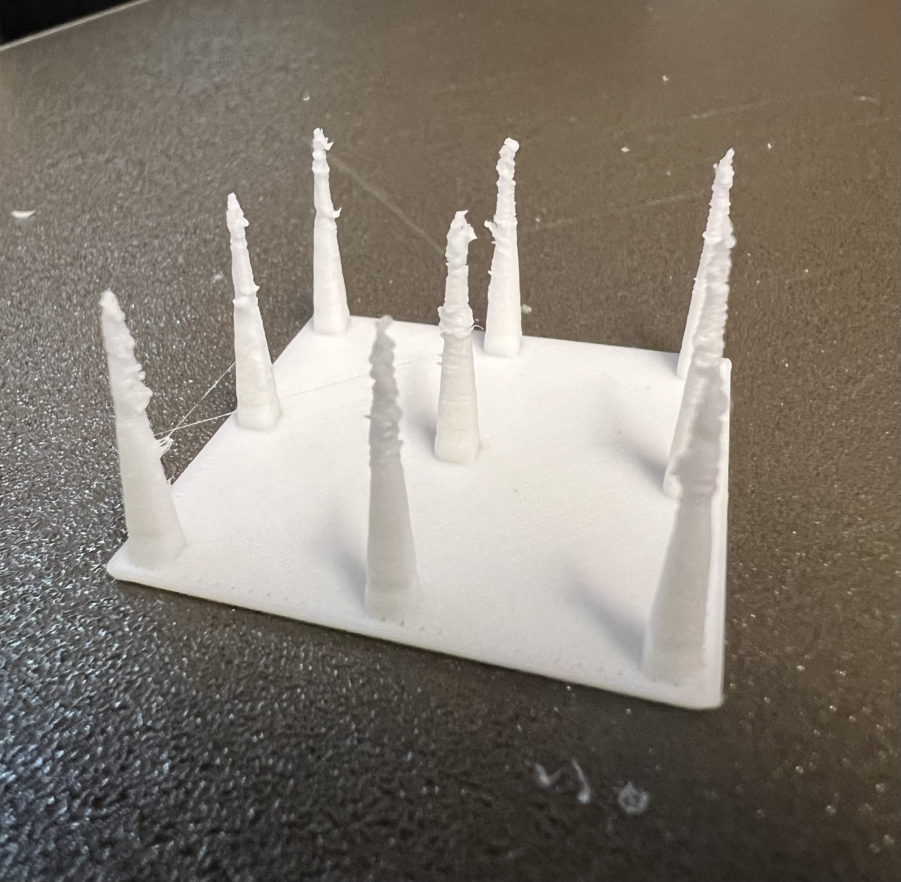

So I have some pretty good progress.   This is for ninjaflex but I feel like it's also going to be similar for chinchilla.
Reducing the ninjaflex retraction amount to 1.5mm from 3.5 and the speed from 60 to 20, got me better results.  if you look at this picture.  you can see a coaster I printed with the previous settings where there are gaps in the top fill for both the red and white ninjaflex.   and I put a xyz cube printed in white ninjaflex that used to show the same problem, but now with the updated retraction settings.. it looks good!,  about to fire off another coaster with with these settings and see if that translates to the finished coaster.   I think not retracting as much or as fast SHOULD help with jams.   fingers crossed.
Posted : 27/01/2024 10:11 pm
