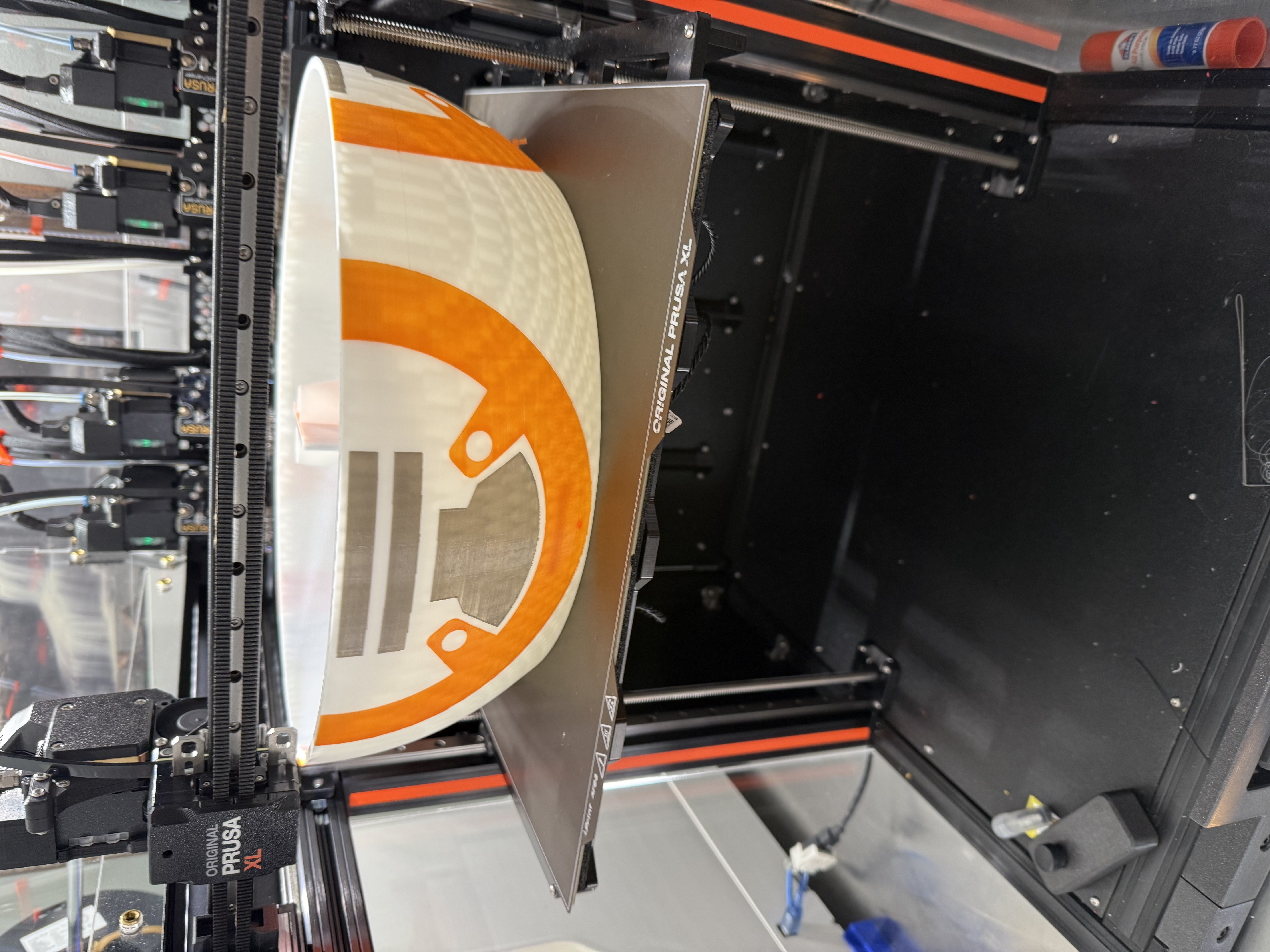

Tough one to put into words…. Anyway I have an XL multi tool.  I am printing a multipart print.  It is the Star Wars robot  BB8, see attached.  I have a white shelled sphere as a part and the orange and gray “decals” as other parts. The Sphere is 6mm thick and the “decals” are 5mm thick.   The “decal” parts are positions so that they stick out .20mm outside the sphere.  What I want, is for the decals to be orange and gray through out their 5mm thickness.  What is happening is white is taking priority at the intersection of these parts.   See the image attached.   Is there a setting or technique in the Prusa slicer to specify what happens at the intersection of parts, ie which parts take priority?  Hope this makes sense.
Thanks in advance,
carmine

The issue is your 'decals' overlap the white base sphere rather than each part having their own dedicated space. When multiple parts (not objects) overlap their order on the model list dictates which part overrides the other.
When the "sphere part" is on the bottom of the list it has priority over all other parts, so you only get your ".2mm extra" of the decals:
When the "sphere part" is on the top of the list it has the least priority, so all the decals get their full shape printed:

Thank you I’ll give that a try.  When you say top of the list you mean the top of the tree?  So I need to import them so that the MainBody (sphere part) is the root of the tree.

Confirmed.  this worked well.  thank you!
Carmine
