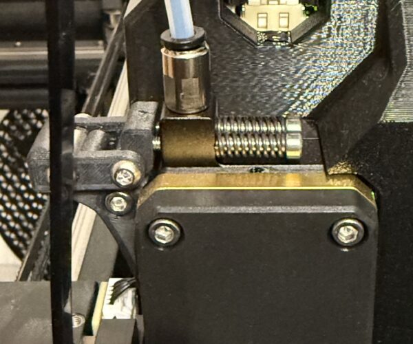

How do I release the PTFE tube?
I would like to print something from FLEX material, so I try to follow the procedure on this site: https://help.prusa3d.com/article/flexible-materials_2057 , unfortunately I can't release the PTFE tube... I don't have the "blue" thing there, mine is black... And it looks like I can't even press it to release the tube... What am I doing wrong?

pressing  the black ring to release your PTFE should work,
That doesn't look like a prusa connector has it been changed already? (maybe they have more than one supplier)
on My MMU1, i found that after a while, the constant side to side movement of the nozzle assembly would cause the fitting to score a groove in the PTFE tube, making removal increasingly difficult until eventually removal was impossible
I never found a good solution to this issue, so I would try and change the PTFE before it jammed, and I kept a stock of fittings on hand, in case I got a jam that I could not clear.
I also kept a spanner on hand, to undo the fitting, if I didn't have time to replace the fitting and PTFE, or couldn't find a new fitting or PTFE.
there are fittings with integral bearings which may have resolved the issue, but the samples I located, were restricted in internal diameter, and would not let filament pass through on the MMU2
the Festo rotary fitting only has a 1.6mm bore (and it's a bit expensive)
Aliexpress also seem to stock a different brand, but I have not had chance to try these
the cost is more acceptable and they do make a 4mm tube, 5mm thread version

I didn't change anything - this is what I received when I bought this printer.
I tried all 5 tubes again, but still no success. And besides, I really can't seem to press the black one, it just won't move.

Years ago, when I first had my MMU1 I made a small tool to make PTFE removal easier....    I havent got a clue where the STL is now...
BUT i Found this on Printables, which is similar.
https://www.printables.com/model/1034798-ptfe-out
it's shown with a creality, but should work with a Prusa

I found the black plastic fittings PRUSA switched to require over 40KG of force to release the tube. I measured this by putting the fitting with the tube on a scale and using a wrench to press down on the black plastic. PRUSA is not admitting they have a problem with these fittings. The blue fittings reportedly  release with simple hand pressure. I do not have a blue fitting so I could not measure the release pressure with the scale.

I have the exact same issue, and it just doesn't make sense that Prusa shipped all these printers with these non-functioning black Bowden connectors.
Did you ever find a solution? Removing runout filament is a nightmare, making that aspect of the printer's functionality essentially useless.

I have been working on this for awhile. Here is a tool that allows you press down on the fitting allowing the tube to be removed from head:
https://www.printables.com/model/1389559-remove-the-pft-tube-from-the-xl-tool
The other tool allows you to measure the force required to separate the tube from the fitting. Using an archery bow scale. It proves the necessary force is well over finger pressure.

I might try this, but I've tried using other hard metal devices (e.g. adjustable spanners opened enough to fit the black fitting), and it just feels like I'm going to break the extender assembly, so much force is required.
