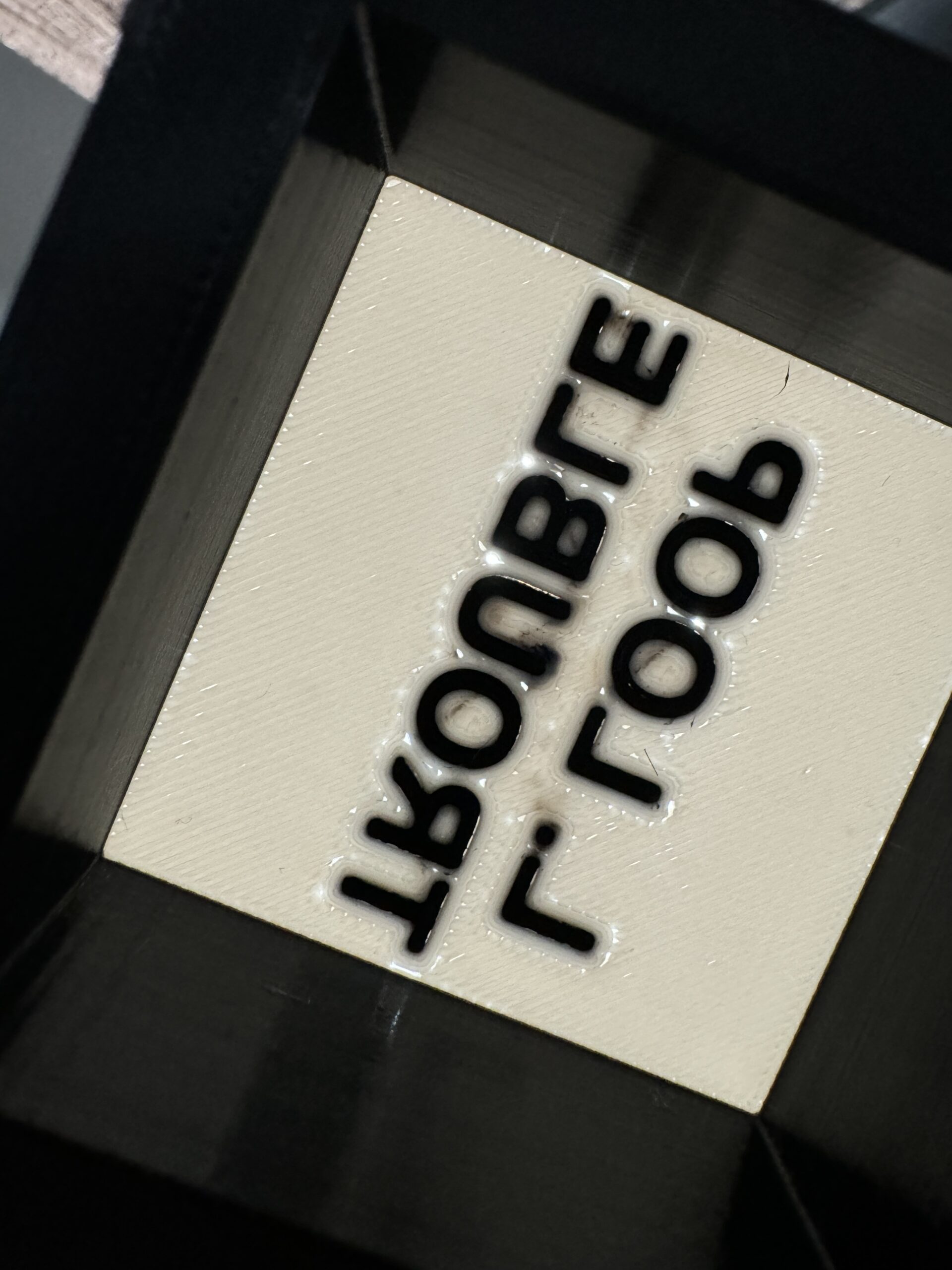

Gaps in first layer

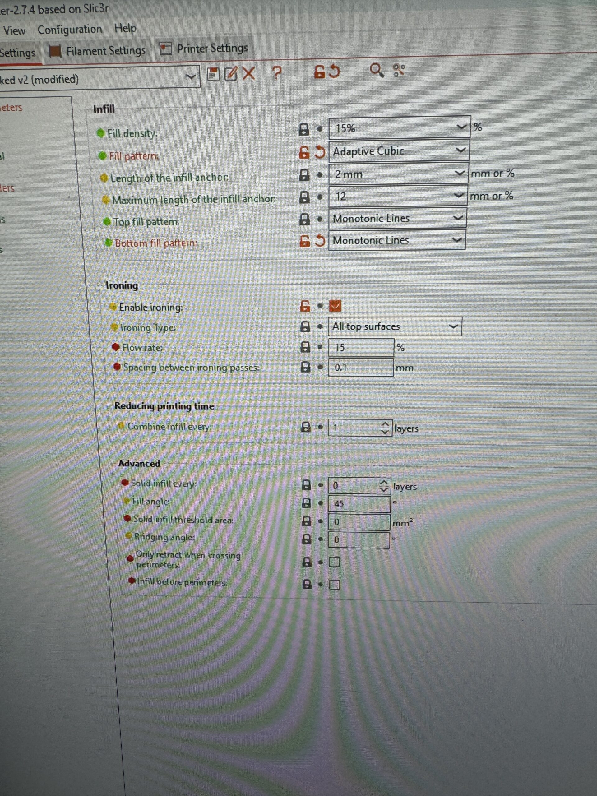

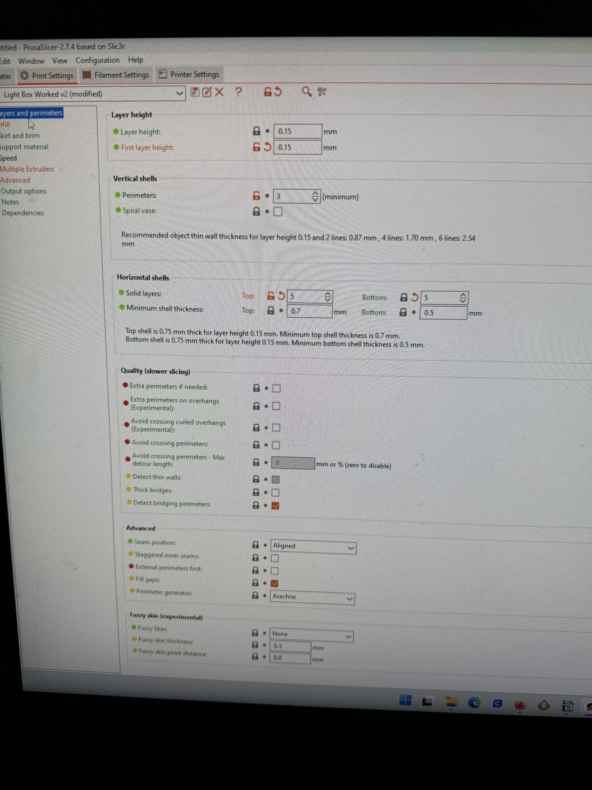

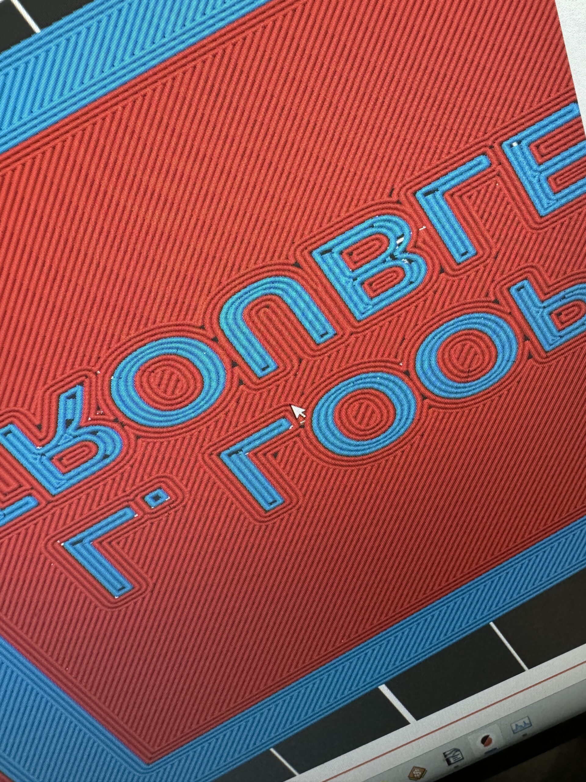

I am trying to print a light box but I cannot for the life of my get all the gaps out of my first layer anyone have any ideas or suggestions it seems not the be in the infil but in the small perimeters of the letters I have attached my settings as well

Use a modifier to reduce the number of perimeters in that area.
Try a different fount with less variation of stroke thickness.
And use larger print, about 10mm is the smallest reliable size for a standard nozzle.
If you want anything finer use yuur inkjet/laser to print on transparent sheets and 3D print a frame.
