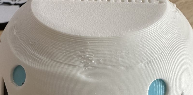

Bottom of Egg overhang print is horrible
Why does the bottom of my eggs print this way? The over hang isn't that steep. Any suggestion on what I can try to fix this in Prusa Slicer?
Posted : 11/05/2025 1:49 pm
But of course it *is* that steep; there is too little space under the curve for any support to fit.
If you don't want to chamfer the bottom of the curve the solution is to print it the other way up - of course an egg is curved all the way round so use the cut tool to separate it into two halves, print both curved side up and assemble with glue.
