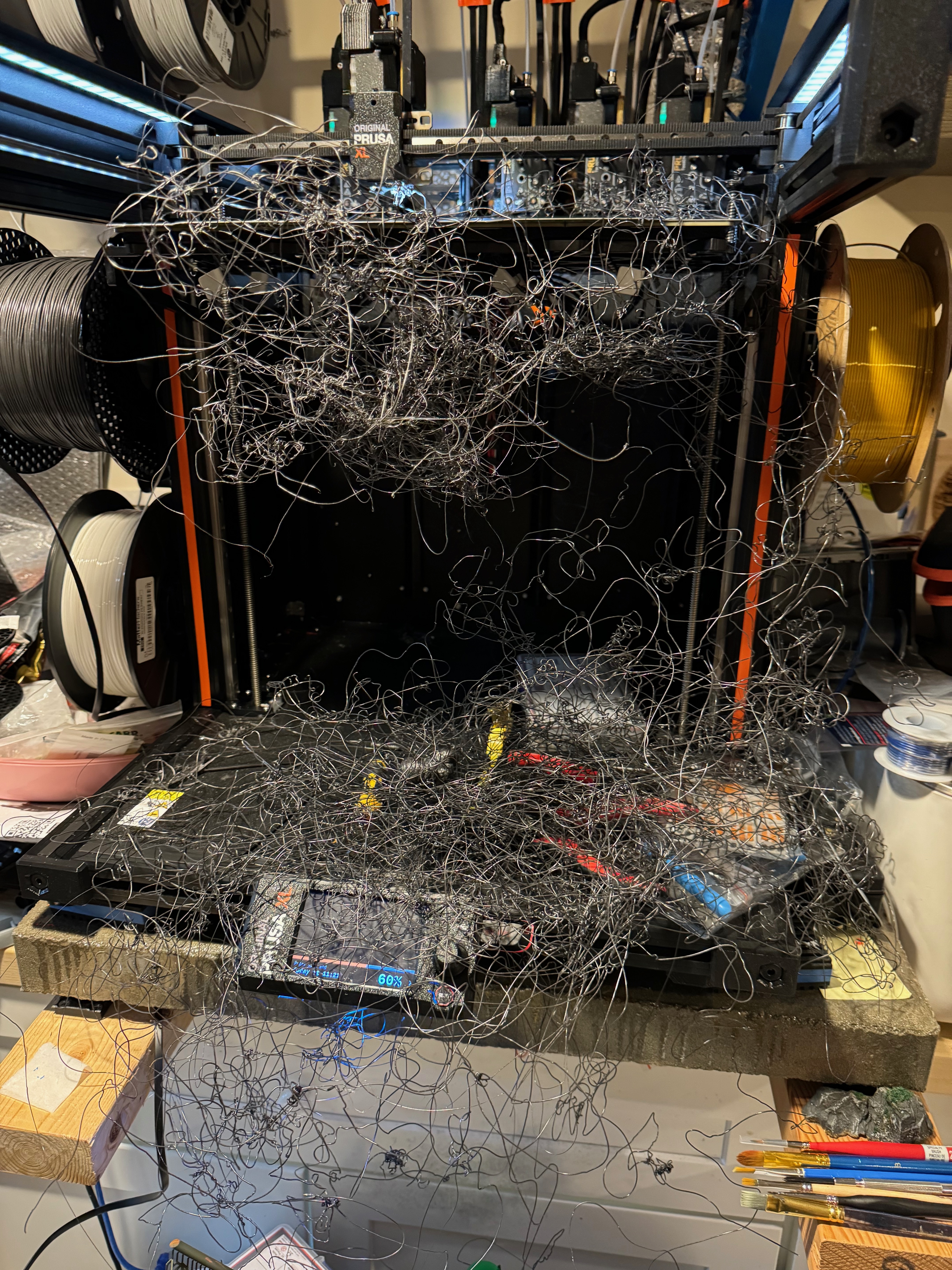

I had my first "real" failure on the XL this week, and while the failure itself wasn't my question clearly afterwards that extruder (#2) had an altered z-offset (I am assuming it had a collision prior to this failed print since the last material I tried to print was PA-CF, what I don't understand is the internal logic of the XL which is what I'd love to have someone who really knows). One of the greatest features of the MK4 and XL are the glass smooth 1st layers afforded by the load cell that detects that it is on the bed perfectly. Fine, but then I see a print where it seems to fail to squish the filament down (as in the failure) photograph here. So on my CNC milling machine I have a tool setter so when the spindle grabs a new tool from the tool changer it moves over and probes the length so unlike in days of old I don't need to manually measure each tool, and every time the tool is used it gets remeasured, so the offset is always correct (and detects a broken tool if the probe is ~1mm distance from prior). Does the load cell not serve the same purpose except continuous. Regardless that it got knocked, since it probes itself against the bed, how could it ever not have the correct z-height adjustment?

Ok, so final result. I did the whole dock calibration, and it failed on tool 5 (previously perfect) and then threw a “unable to perform precision movement” error and to check the belts. I ran the belt tuner site (kind of clever solution) and the right side was dead middle the left side took 2.5 turn to loosen (120hz!). It is very rare for a screw under tension to tighten due to vibration. But all is right with the world it seems.
