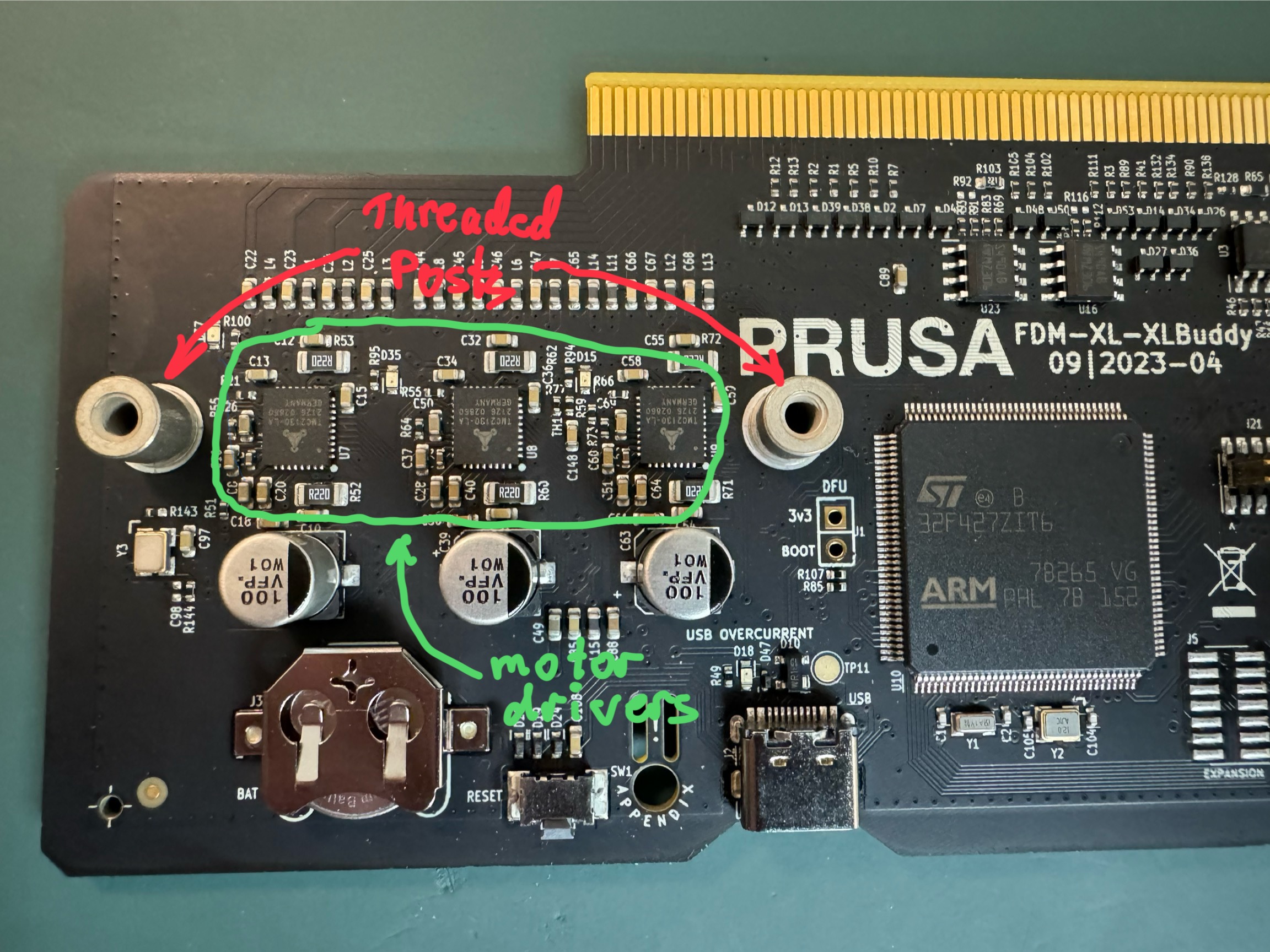

Are the XL Buddy boards running hot?  I see people designing new covers for the electronics box modified with cooling fans.
Looking at my failed XL Buddy board is see the stepper driver chips have no heat sinks, etc.  (Something I see on many other printer controller boards).  There are a pair of mounting posts straddling the driver chips, are they intended for holding a heat sink against those chips?  (Mine had nothing there.)

Photo I meant to include...

From the assembly manual.. doesn't look like a heatsink is there.. Click to see a bit more.
