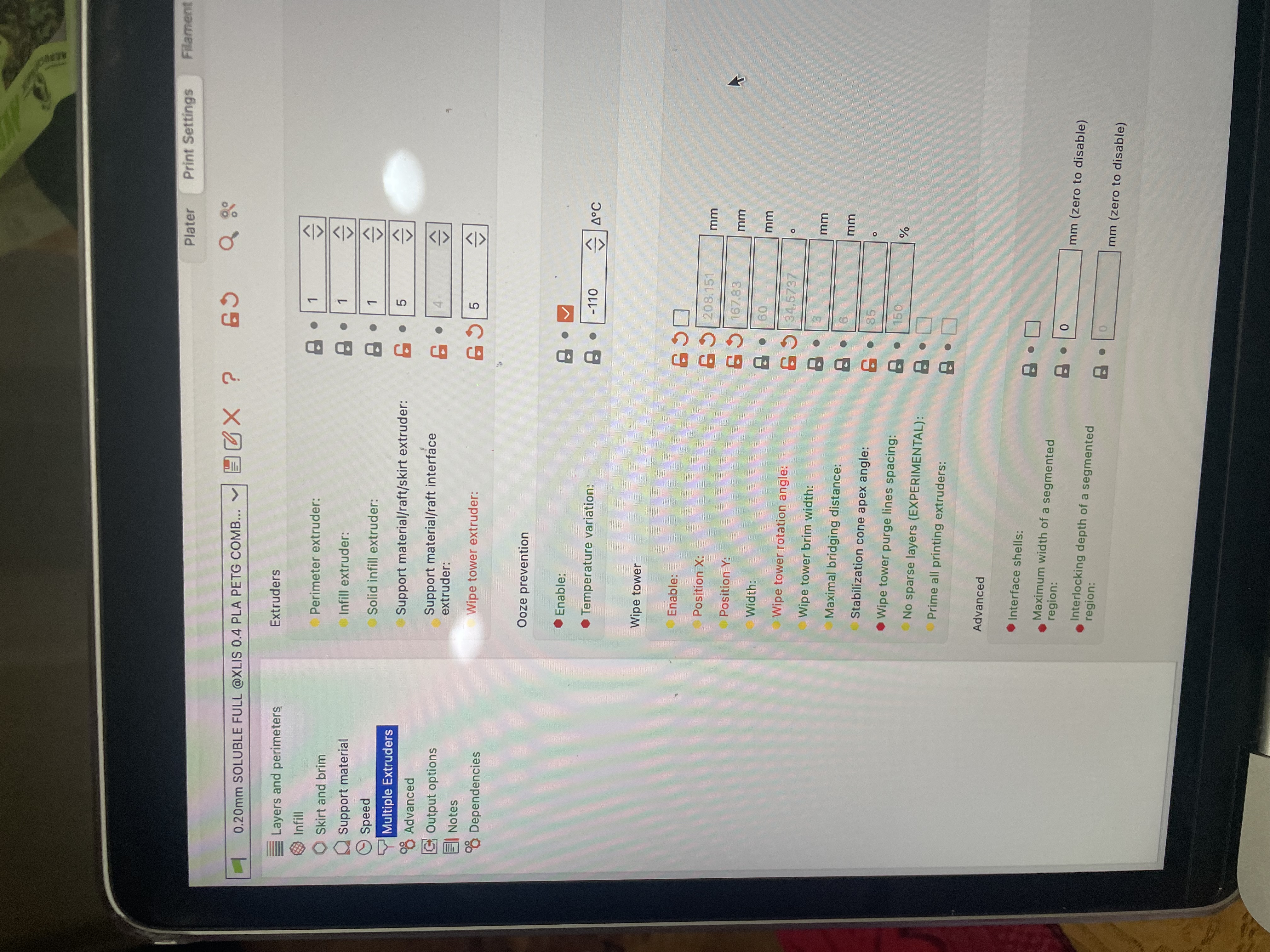

i just tried printing PLA with PETG organic supports using SOLUBLE profile, and the print came out with "whiskers" coming out from the model with disabling the wipe tower. any stock setting i should try? or any setting i need to change?
i also just followed this guide here: https://help.prusa3d.com/article/combining-materials-xl_498103

Can I trust that (given that each color doesn't cover a tiny area) Prusa Slicer will start each color change inside the print such as in an infill area?
This is a setting.
Right click on an ojbect in the slicer > Add Settings > Wipe Options > Wipe into this object's infill

Ira S
(@ira-s)
RE: Why even use a wipetower?
Posted by: @diem
This is a setting.
Thanks for finding that. I was looking in the area under Multiple Extruders and Wipe Tower settings are. Never would have thought to find more wipe options under object settings.
