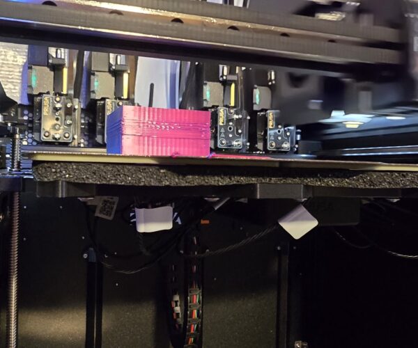

I also had the same VFA problems on my multi-tool XL.  I have not completely eliminated it, but was able to minimize it by:
  1. Make sure the belts on the rear of the XL are not rubbing on the dock cable routers that are used to keep the toolheads parked.  On mine, the top of each dock cable router was slightly cantered towards the rear of the printer.  It caused the top locknut that sticks out of the dock cable routers to ever so slightly rub on the belt.  And if I deliberately push on the belt in the rear, I can physically see the gantry shift in the Y direction.  Even some subtle rubbing on the heads of the locknuts can lead to mild shifting in the Y direction.  I followed advice on another thread, and wiggled each dock cable router towards the front and rear while tightening the Torx bolt to properly align and secure it to the silver metal plate inside the rear aluminum channel.
  2. Make sure the left/right sides of the X gantry are aligned.  When the gantry is pushed the whole way to the front, there should be no gap on the left & right.  The gap can be closed by slightly tightening the belt idler on the side with the gap.
  3. Check & correct the belt tension.  I did it with a combination of the Prusa app which listens for the frequency of the belt and the MK3S belt tension gauge.  The sweet spot on the MK3S gauge is when the arrow is just above the MIN marking on the gauge.  Mine were too tight.  I will be ordering a more accurate belt gauge in the future as I prefer a direct reading vs using the Prusa app that just listens for the correct frequency.  I believe a belt that is too tight causes the belt teeth to compress more on the 2 smooth idler pulleys on the X axis.  Note, that steps 2 & 3 are iterative.  You may have to go back and forth a few times to find the sweet spot.
  4. Don't use stealth mode.  I believe the slower print speed is causing some type of resonance to dominate when in stealth mode.  At first I thought the input shaper was calibrating differently depending on whether stealth was enabled or not.  However, I went through all 4 combinations of stealth & input shaper calibration, and the dominant factor was stealth mode.
With the above changes, the VFAs are almost completely eliminated.  To improve further, at some point in the future, i will also replace the two X axis idler pulleys that are smooth with a toothed version (Gates 6mm, toothed, bore diameter=3mm)  (Example:  https://www.filastruder.com/products/gates-2gt-idler?_pos=1&_sid=1d42bf29e&_ss=r&variant=15443755728967)

RE: Ringing/ Ghosting pattern all over my prints :/
<Reposting pic of test print since it didn't take in the last post.>
This is a test print with improvements 1-3 from my previous post applied.  The bottom 2/3 of the print is with stealth off and the top 1/3 is with stealth on.  The VFAs are evident in the middle of the print on the top 1/3.  There is some subtly evidence of VFAs on the bottom 1/3 (where stealth is off).  But it's a big improvement compared to before the tuning was done.
