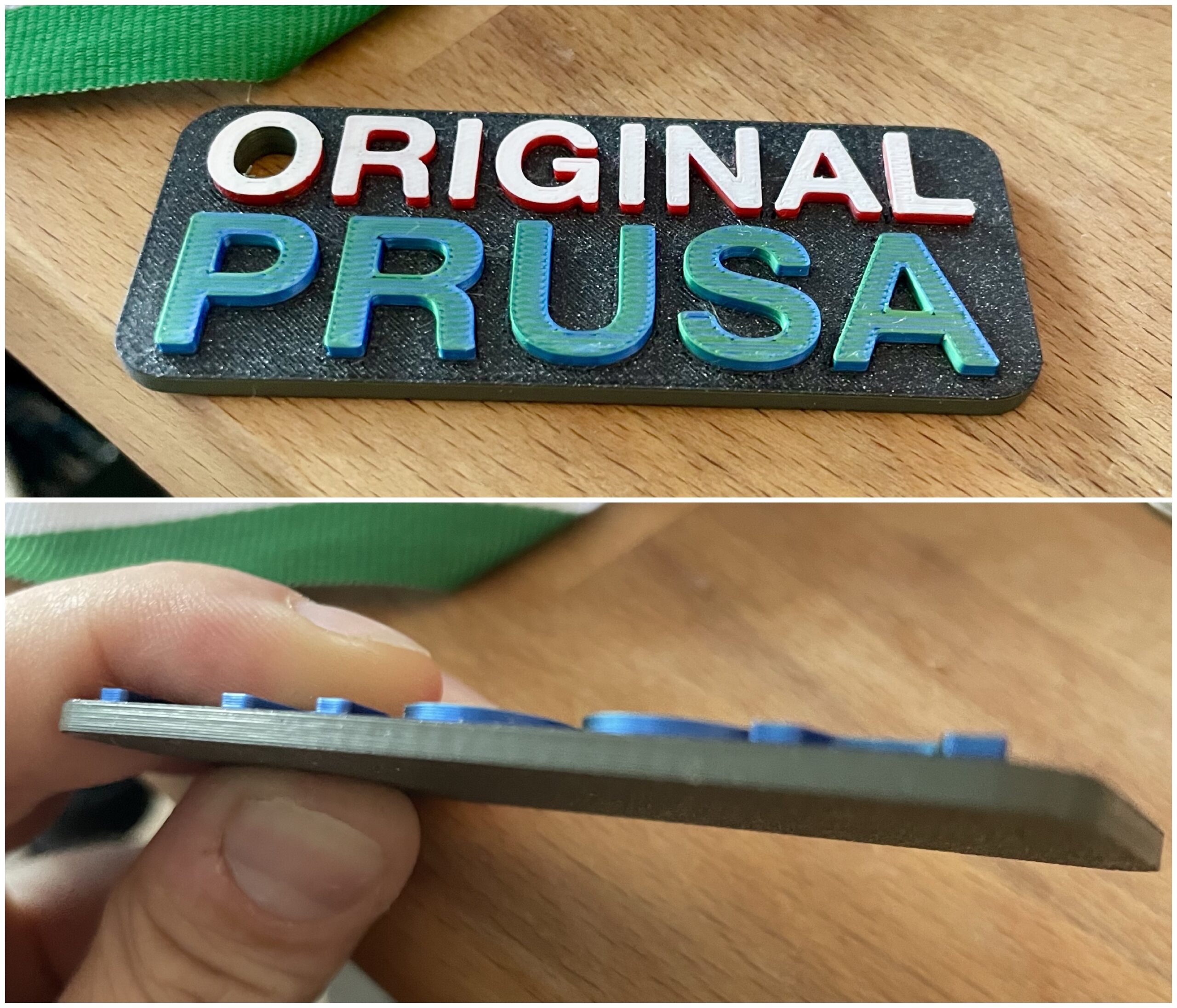

Also, by coincidence, I just found the pre sliced "Original Prusa" tag, that came with the printer's USB stick. I printed it on March 1 2024, just after finishing the assembly. It shows exactly the same pattern, so it has been there from day 0.

Thanks four your reply. Since Prusa XL is supported by Orca Slicer now (only one toolhead though), I was able to quickly produce the Orca VFA test. With the VFA test and the pre-sliced Prusa homing tower I will be able to see, how loose or tight I can adjust the belts.
Here is a nice documention of the problem: https://github.com/AndrewEllis93/Print-Tuning-Guide/blob/main/articles/troubleshooting/vfas.md
So by now I am pretty sure this is 2mm VFAs (Vertical Fine Artifacts), that are caused by the belt or the pulleys / idlers. The idlers on the X carriage seem to be the only idlers that are positioned in a way, where the teeth of the belt rub against the smooth idler. This could produce the pattern, especially, when the rubber on the tooth compresses during the passing of the pulley and then quickly releases the energy after passing.
