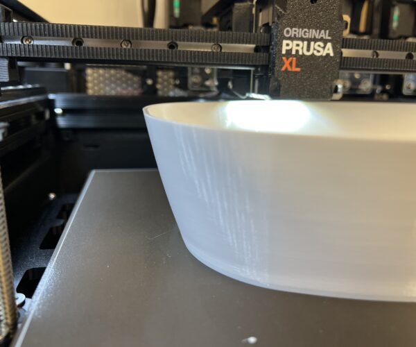

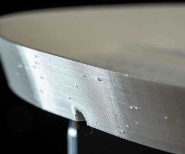

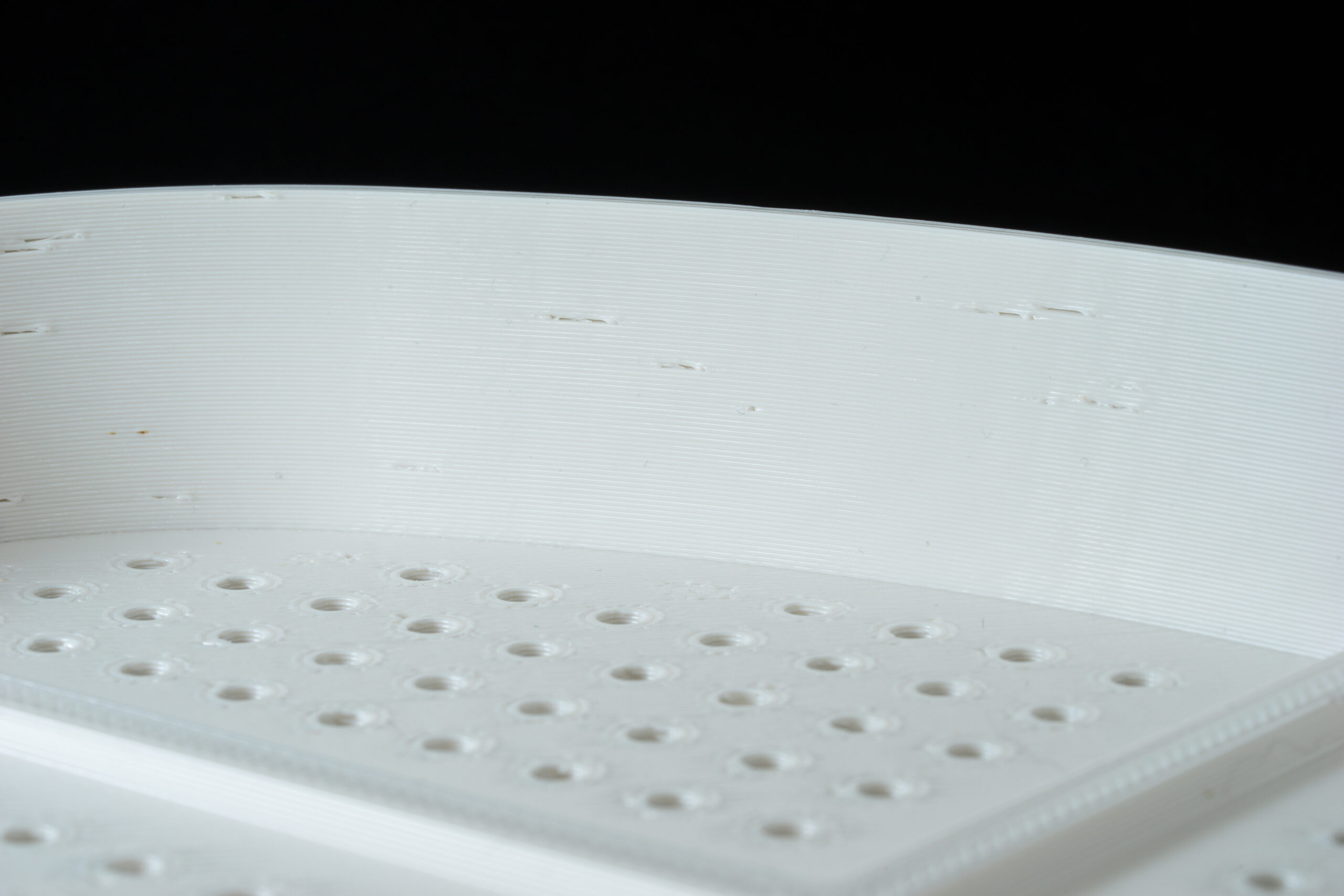

I'm currently attempting to print a large planter (X:320mm, Y:220mm, Z:200mm) using the PrusaXL 5-tool machine with a 0.8mm nozzle. I'm up to date with the latest firmware, including input shaper, and the most recent Prusa Slicer release. For this project, I'm using Prusament PETG Signal White filament.

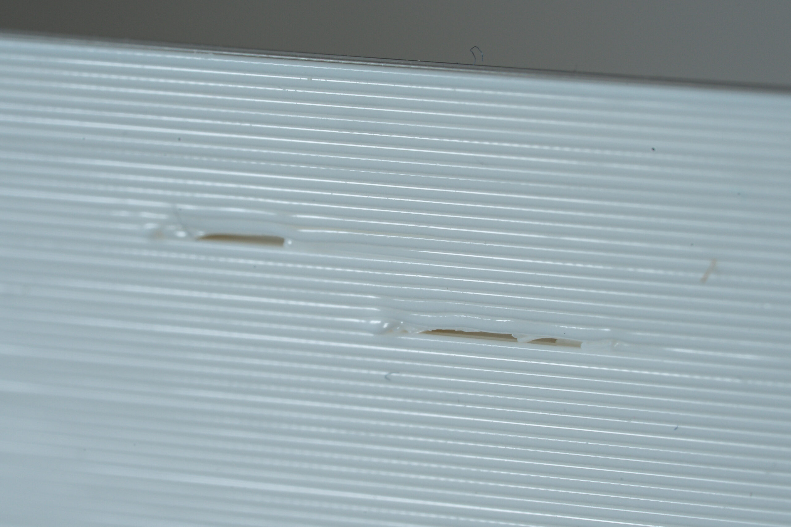

Typically, for round objects with opaque filaments, I prefer setting the seam position to "Random" for a visually smoother finish compared to a single seam line. However, I had to halt the print due to large holes appearing at the seam positions.

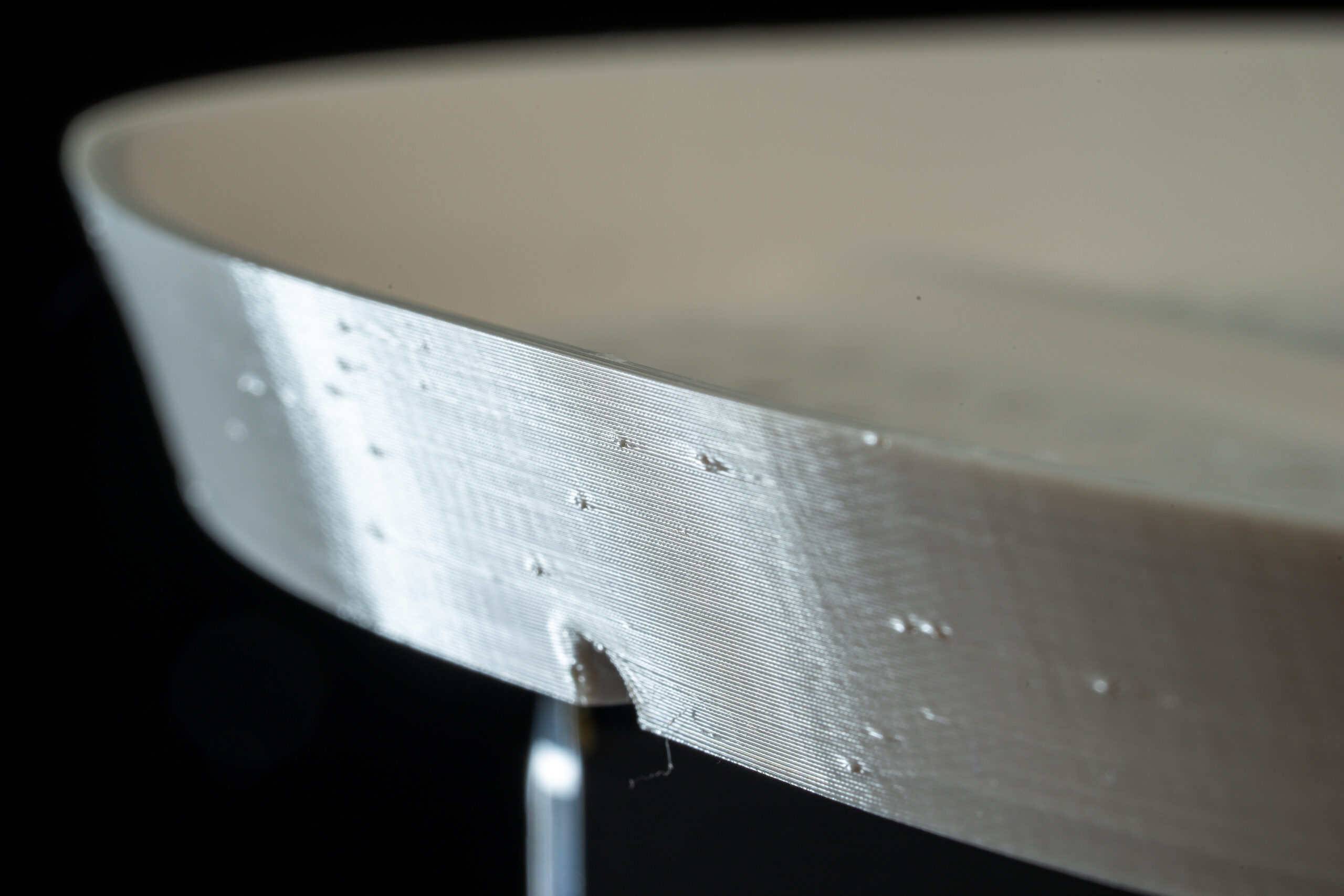

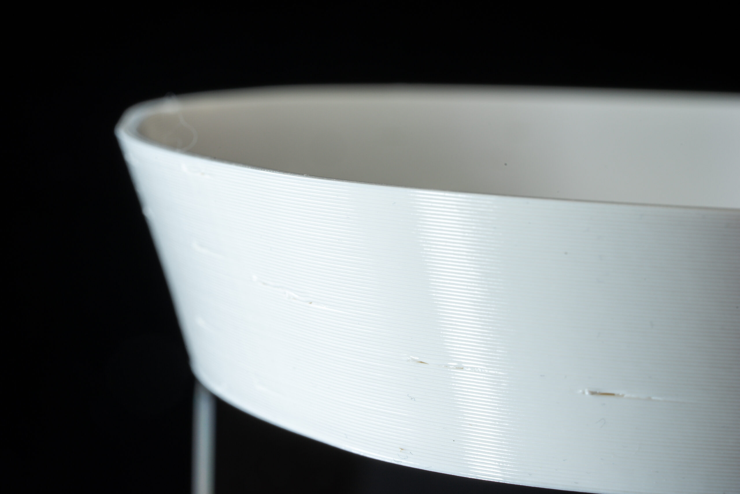

I utilized the "0.4mm QUALITY" profile for this print. Here's a close-up of two such holes:
It's quite disappointing, as the perimeters with the large layer height printed beautifully. My theory is that due to the "large" movement of the printer head, stringing occurs, leaving insufficient material in the nozzle to continue at the new point. But I'm not experienced enough to confirm this.

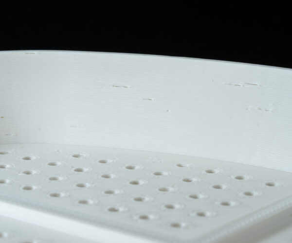

Here's how it looks on the inside:
Therefore, I've temporarily given up on using the 0.8mm nozzle (due to this and the over-extrusion of infill mentioned in another post).

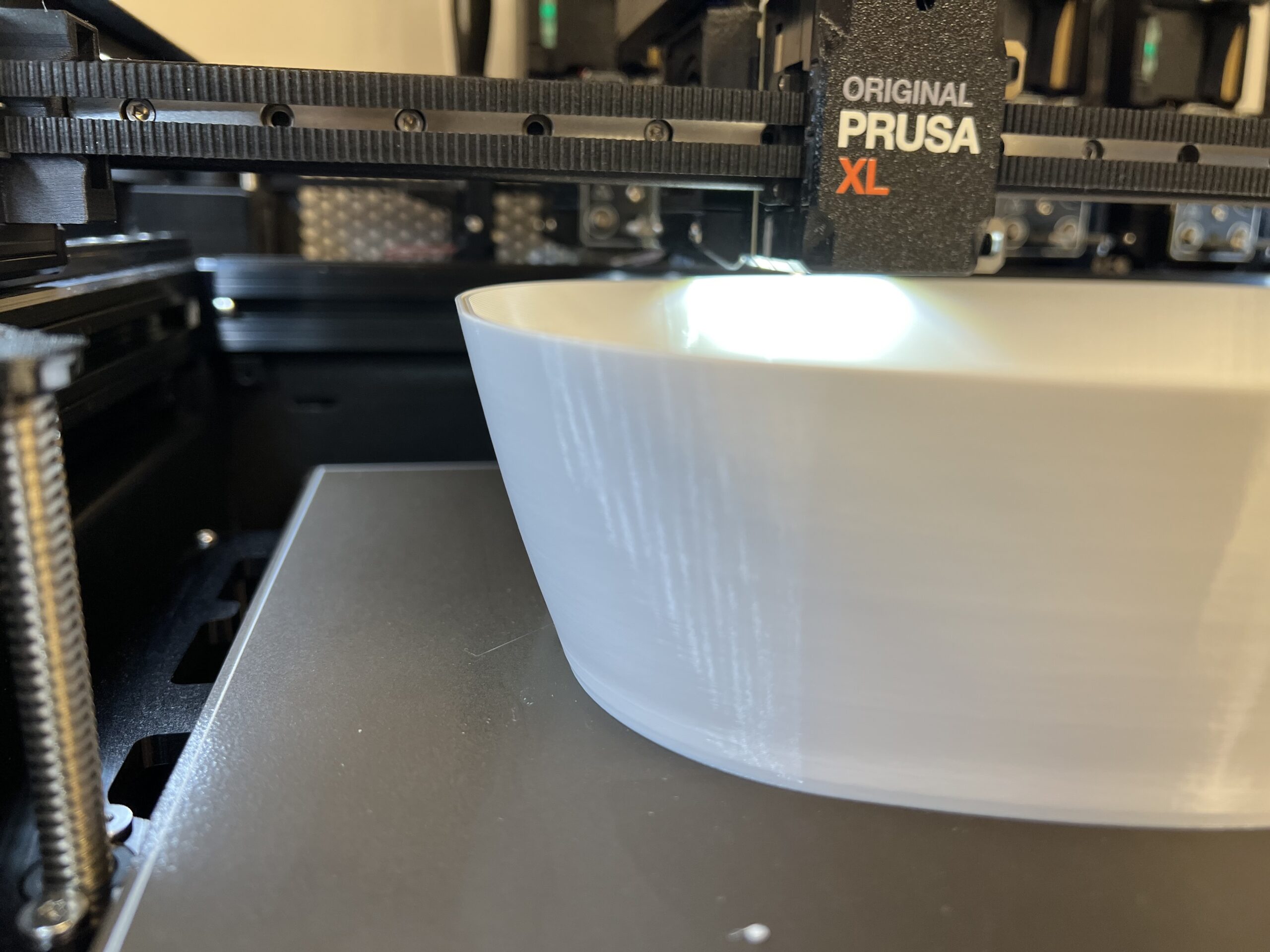

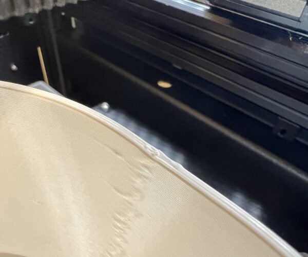

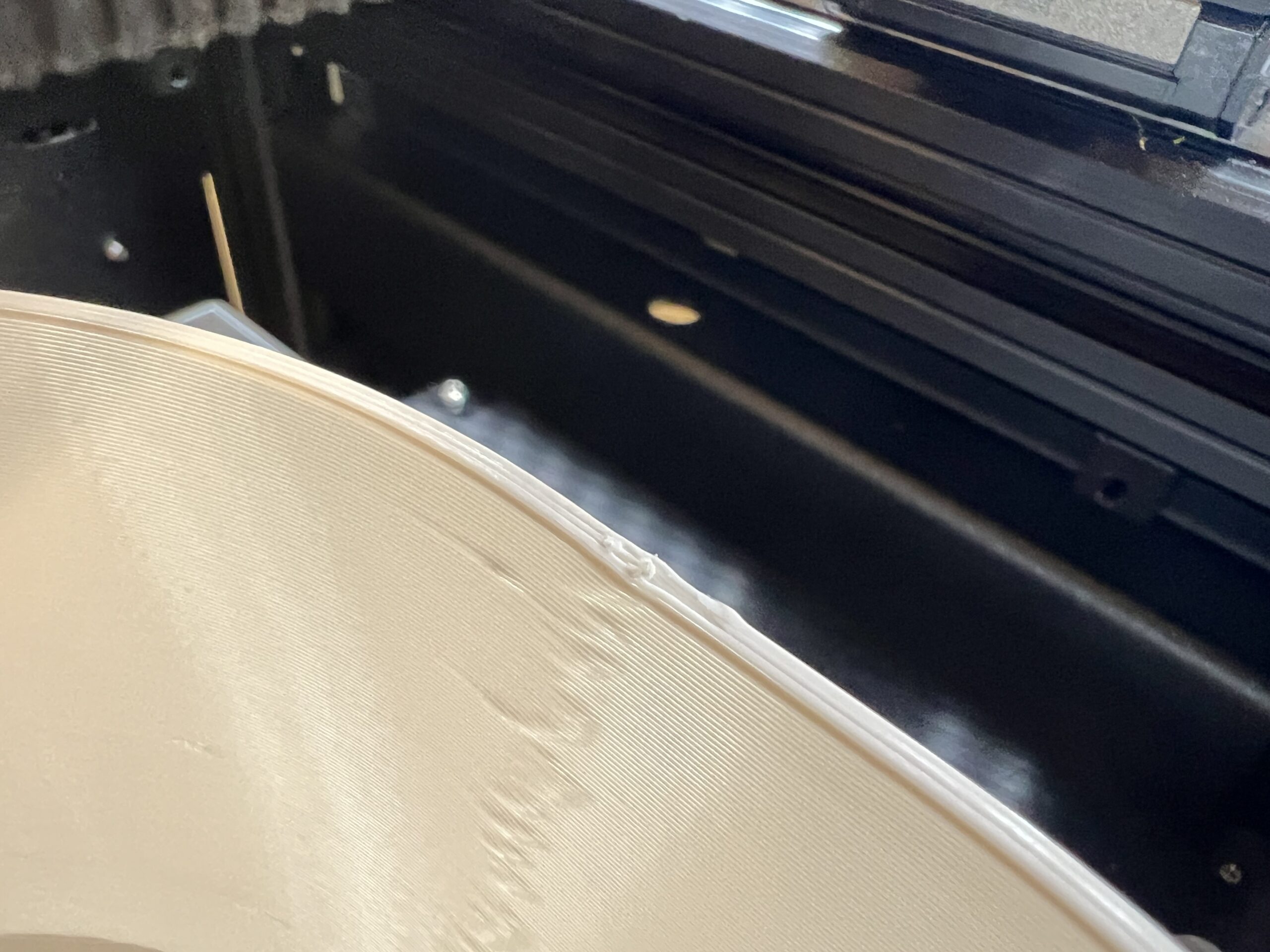

For my next attempt with the 0.6mm nozzle, I switched to the "0.32mm STRUCTURAL" profile, again using Prusament PETG Signal White.
With the 0.6mm nozzle, the issue seems to be the opposite. There's a thick blob of filament at the seam position, affecting not just that layer but also three or four layers above.
These blobs not only look bad but also appear to disrupt the overall print. The next photo shows the unevenness of the print, likely caused by dragging material from these blobs around the perimeter.

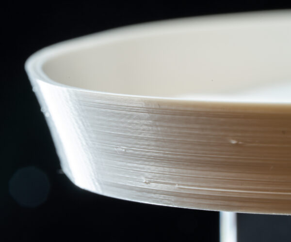

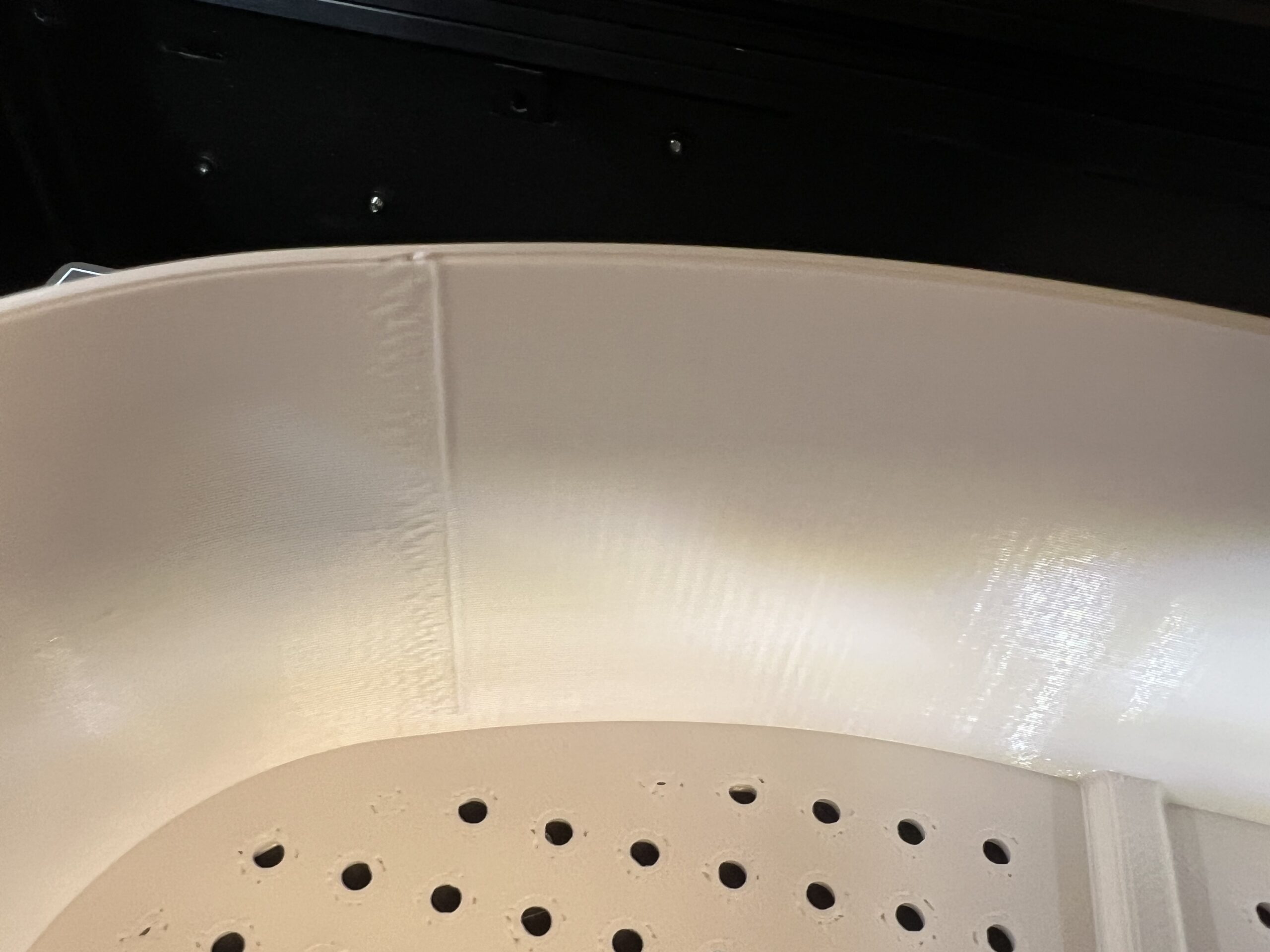

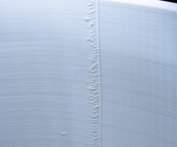

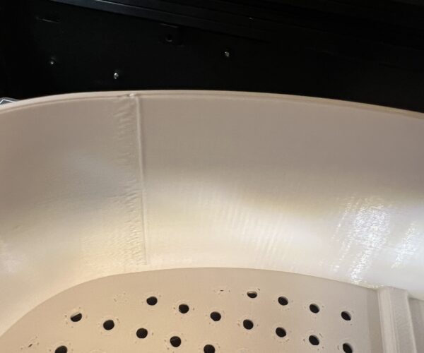

For another trial, I tried painted-on seams with the default "Align" setting, placing seams on the less visible outer side. I also opted for the "0.32mm SPEED" profile, hoping the faster speed would minimize blobs at the seams.
Indeed, the overall perimeter looks much better with aligned seams.
However, the seam itself is unsightly, with visible holes and defects dragged into the perimeter along the print direction.
The inner seam looks marginally better, but that's not my main concern.

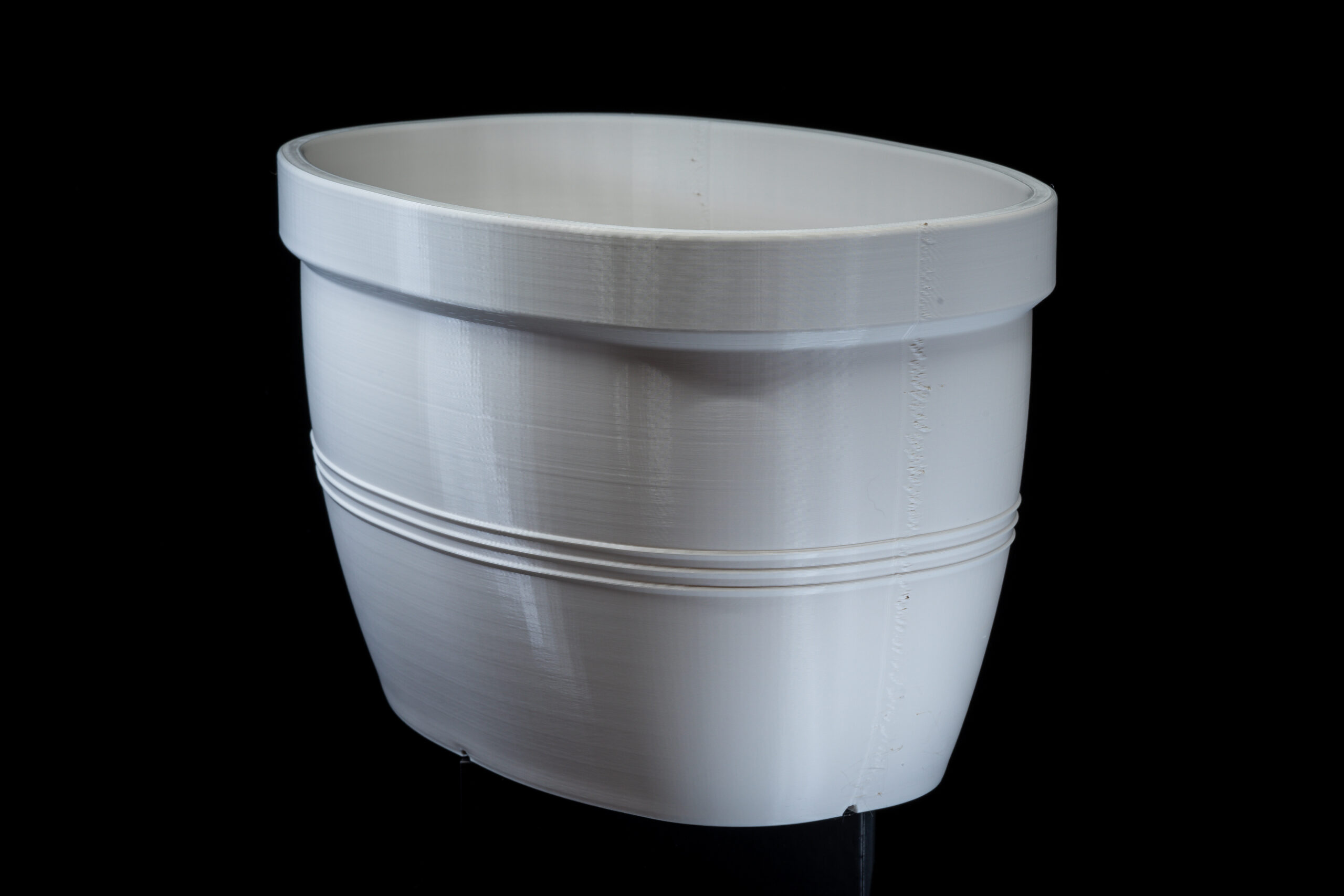

Detailed Photos of the Final Print and it's Issues

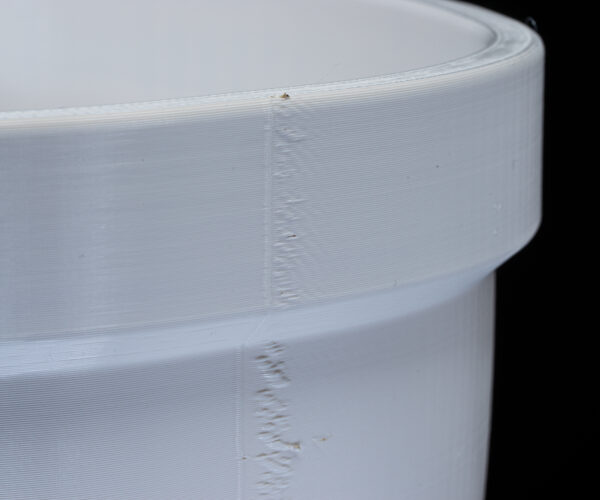

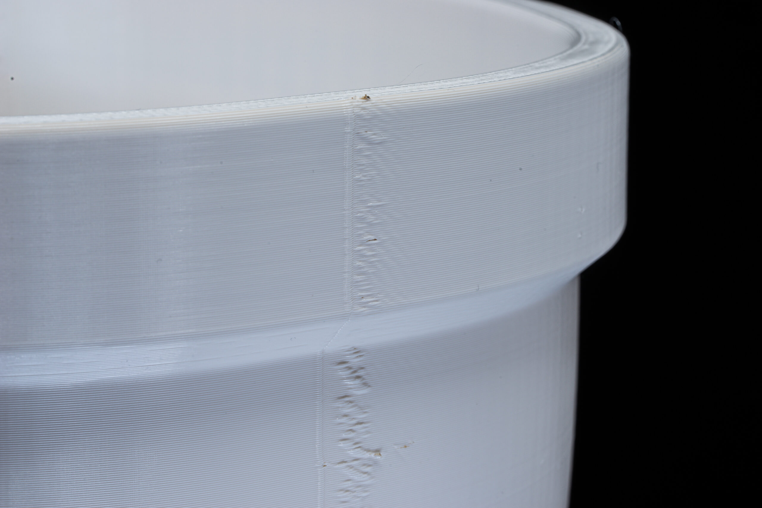

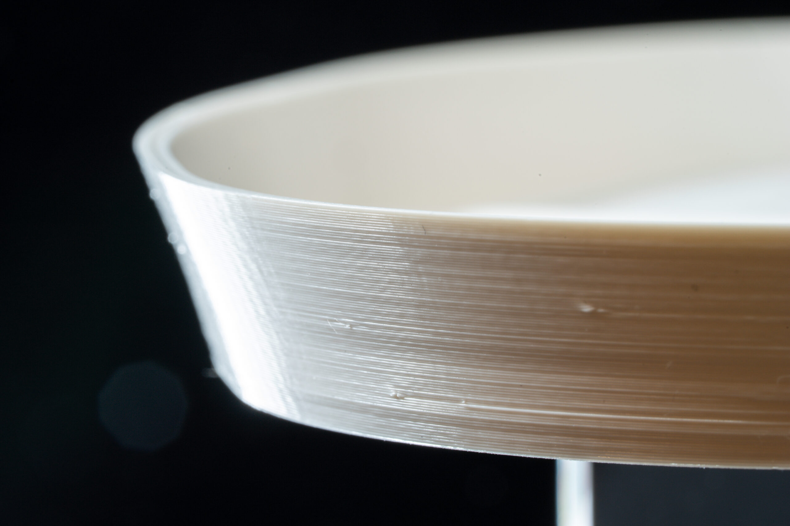

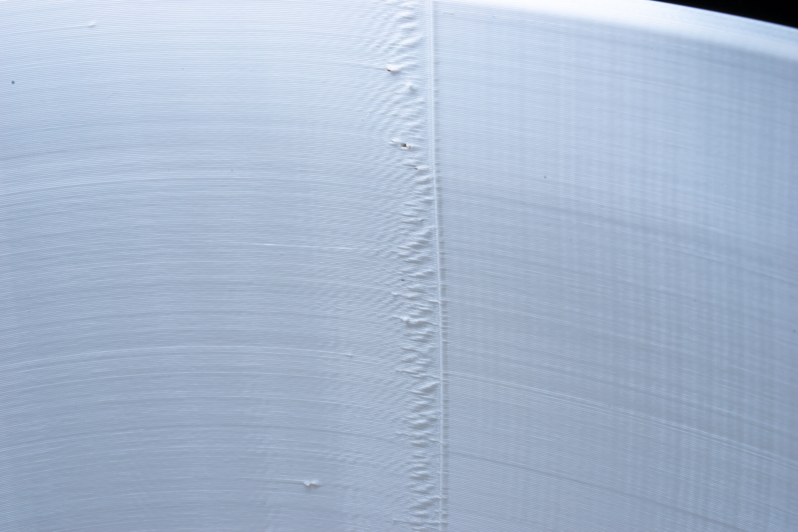

Here are photos of the finished prints, and close-ups of the issues at the seams.
While the overall quality of the print is OK, the seam looks horrible.
The strange part are these blobs after the seam.

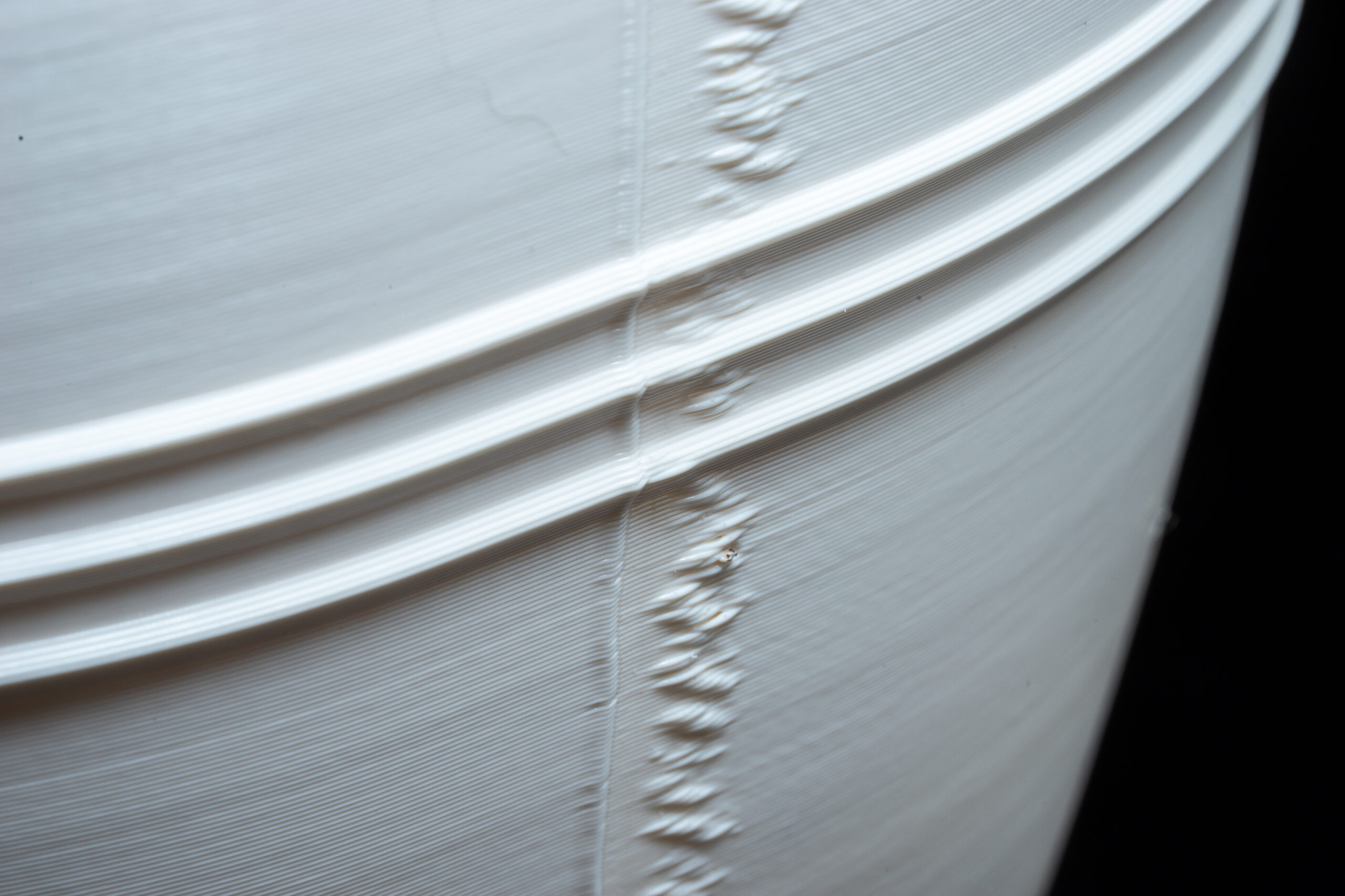

As you can see, the seam itself is a thin straight line, I could totally live with. But just after the seam, there are these large blobs of material that stick out of the print.
The same is true for the seam at the inside. Here, it isn't as bad as at the outside. But still, hard to ignore. These defects are also visible more or less on the other side of the planters wall.

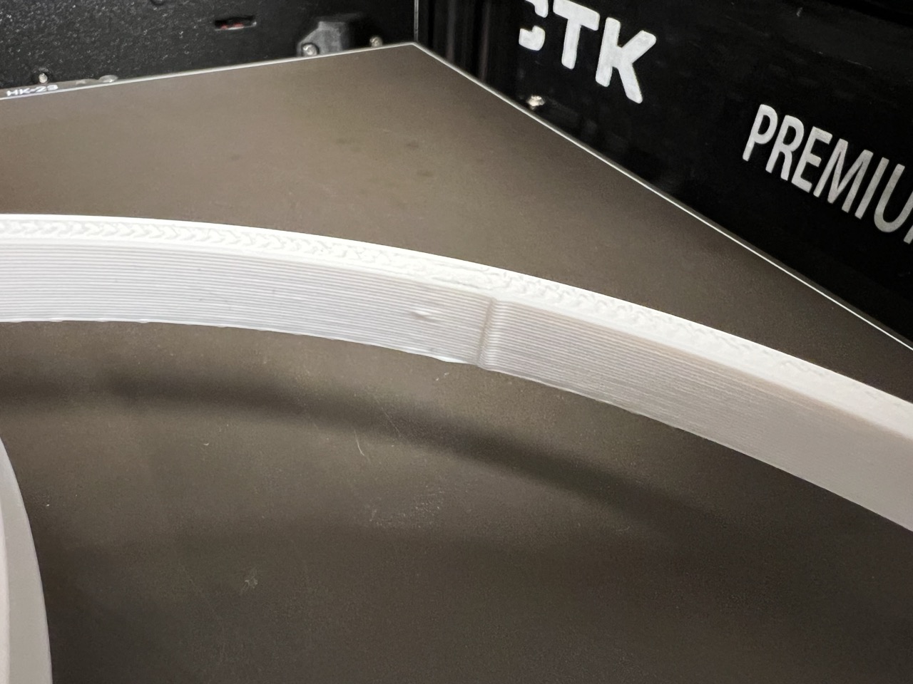

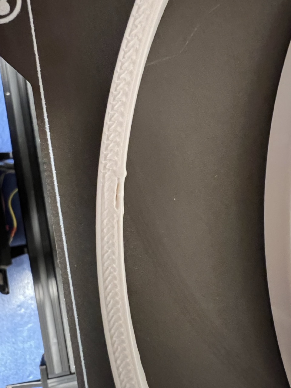

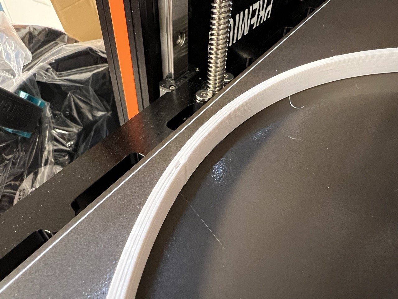

I printed two test rings, both with a diameter of 250mm. One with a thickness of 5mm, one with a thickness of 3.5mm. Both printed with the PrusaXL, Prusament PETG Signal White, with the 0.4mm Quality profile +aligned seams.
Here the 5mm one:
Here the 3.5mm one:
In both prints, there was a large gap at the inner perimeter that went through the whole ring vertically. The only difference between the 5mm and the 3.5mm version was, that in the 5mm version the top infill covered the gap, so it wasn't that well visible as in the print that only consists of perimeter lines. You can also see, the blobs after the seam, already start forming in the 5mm version as well.
I'm pretty sure, that's not normal. There should be no gap in the (inner) perimeter like this.
The only difference between the two thicknesses is, that in one case the problem is clearly visible and in the other case, the defect is covered by the top and bottom infill. Yet, both prints have the same defect.

Try going to 6mm and randomise the seam.  You'll probably do better with clear, or dark coloured filament.  White is always tricky.

Thank you for your suggestions regarding my issue with the print issues on the PrusaXL. I appreciate your input and the time you've taken to offer advice. Neither can I print objects with any wall strength to solve a printer issue, nor I can just switch the filament colour for that reason. Randomising the seam makes things worse, as the travel length of the printer head increases.
The issue depends on the travel length between seams, and has nothing to do with the thickness of the printed walls (as I demonstrated). If you think otherwise, please do a few prints yourself and show how it solves this issue. I attached the PrusaSlicer project that you can use to reproduce my print.

This I don't understand.  The move from one layer to another doesn't require any significant head movement - other than the characteristic wiggle.  I printed a 250mm hoop like yours with a thickness of 3.25mm - picked to suit a 0.6mm nozzle.  The filament came straight from the dryer, no IS, no excessive speed, and the results are, imo, acceptable - yes the 0.6mm seam bulge *is* noticeable but if that's an issue then a smaller nozzle will reduce it.
