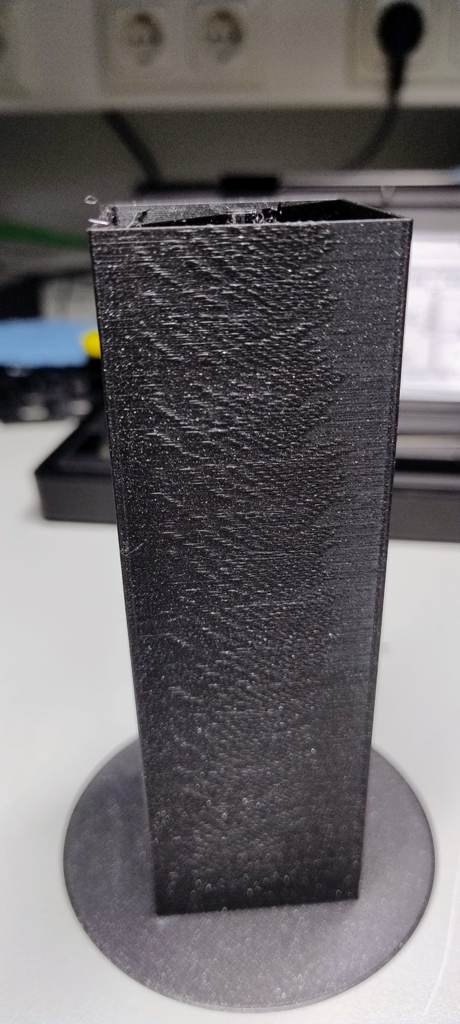

RE: Problems with Prusa XL since version 6.2.1
After performing the hard-reset, downgrading FW to 6.2.5, no homing errors, no z-callibration errors. All calibrations performed flawlessly, even home tower doesn't have weird artifact on the front wall as it used to have with 6.4.0 alpha - purely due to firmware because on the back X there is no artifact, both Ys also don't have that artifact. With 6.2.5. that weirdo is gone.
So yes, downgrading the firmware and recalibrating helped a big deal - prints finish successfuly.
Posted : 08/10/2025 8:14 am
