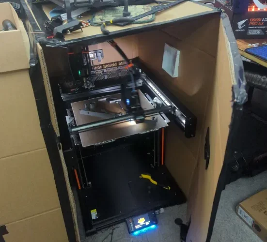

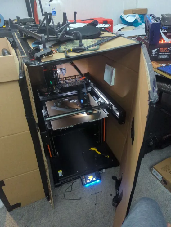

It sounds obvious now, but diagnosing it took forever. I used cardboard boxes to build an enclosure, and the heat inside seems to soften the filament to the point that the extruder gear digs into it, causing a failed print. It acts jammed, so that's how I tried to fix it, but no amount of tweaking worked. The prints would always fail about an hour in, which was my main clue.
Anyway, can anyone think of a way to prevent this? I'd like the least amount of warping possible, and the enclosure also serves as a fume hood with a duct running outside. The whole fume thing is moot with the door open, but I have to sleep next to it while it's printing. I'll try turning the fume fan up all the way in the mean time. Thanks in advanced.

I'd try to measure the temperature inside. My temp is always below 40C (carpet enclosure). You can also lower the nozzle and bed temperatures, I am usually lowering 5C nozzle and 3C bed for pla - the difference however always depends on outer conditions and used profile.

I'm printing with PC. So the bed temp wants to be 105C, with the nozzle 290C. Is it possible to record the heat break temp? The extruder assembly might be getting hotter than the air because of it's proximity to the bed and nozzle. Maybe I just need an additional exhaust fan. Like you said, I should record the air temp right when it stops, so I can share the PSA "printer jams at X enclosure temp"

Prusa's Carbon fiber blend polycarbonate. My mk3.9 didn't have any issues either. I wonder if it's because the whole bed was heated to the max? It radiates an incredible amount of heat. Even the tool carriage was hot to the touch, and that doesn't produce any heat itself.

I had a similar issue with mine printing ABS in the Sumo Enclosure. I ended up needing to replace the tensioner parts with ABS due to the original PETG parts warping. Since switching to ABS I don't have jamming problems.
RE: Printer jams when enclosed
I had same problem. Reprinting below parts with ABS - resolved an issue.
