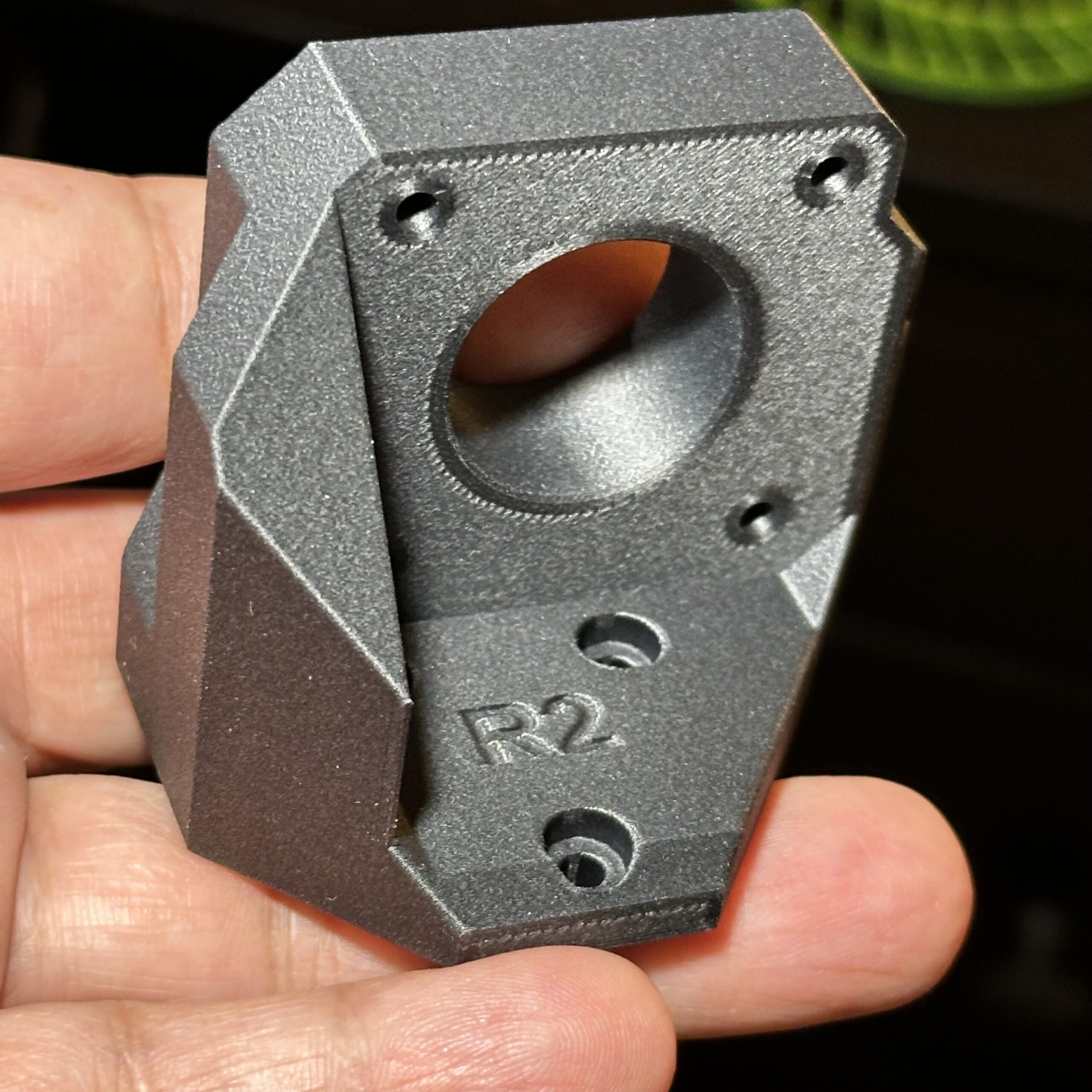

ppespepe
(@ppespepe)
Themenstarter answered:
If OP means original post... I guess I can welcome you to mess this mess as much as you need! 😀
Posted by: @4x4dually
My apologies to the OP for completely high jacking the thread. I hate to start a new thread for the same issue, but I've made a mess of this one. 😎
My beloved XL monster suffered from most (if not all) of the symptoms you mentioned. I put a sensor to measure the temperature everywhere inside the enclosure, used proper VoC and PM2.5-10 sensors, torched my blocked nozzles, looked on the internet to learn more effective ways to curse in different languages and dialects, and created new rated R insults to no avail.
The only thing that worked for me was to print the extruder's PC-CF upgraded parts that came with the enclosure myself using the best parameters I could come up with, like a lot more infill and the structural 0.10 or 0.15 (I don't remember) using a 0.4mm nozzle. I used all the new cursing language created in my previous steps while assembling my five tool heads --again-- with utmost care—the same care I used the first time—and voilà!!
That thing prints so freakingly beautiful ever since that I recovered my voice after all the aforementioned use of cursing language!
Seriously, that's all I did. Below is a PCCF part I printed on my previously known as sir-clog-a-lot XL to upgrade my MK4 to MK4S. Nope, I no longer use the printed PCCF parts from a Prusa upgrade.
Just print the upgraded parts the best you can. My printer still prints wonderfully; it is, by far and away, my favorite printer!!!!
I hope this helps!
Happy all to everyone!!!
