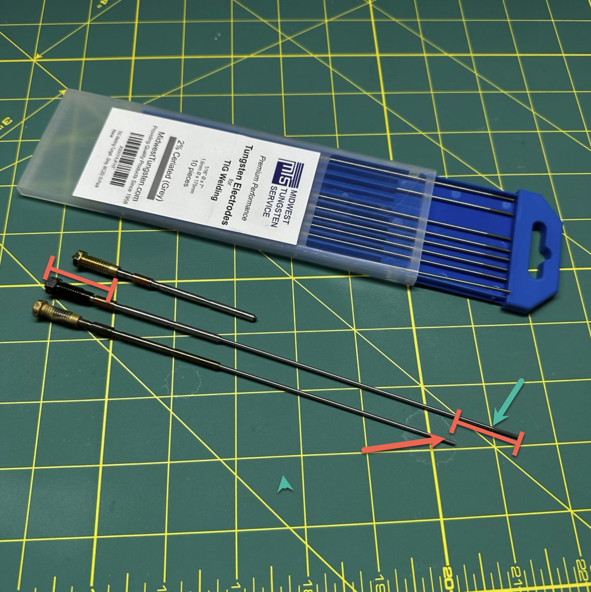

Hello everyone,
I've been having issues with my XL-5T clogging nozzles right and left, and I mean a complete and utter clog that renders the nozzle unusable. Replacement is the only solution. It all began once I made the enclosure/firmware upgrade, so I'm not sure which one did what.
I contacted support, but they just gave me the canned message, "Nozzles clog and are a consumable," without any further help on why this was happening. They only assumed I was an idiot and called it a day. This XL is not my only printer, nor my first, and it has only 17 days of pampered printing on the clock. I have replaced two completely clogged nozzles already and am now dealing with a third one, and this printer is only six months old. Any ideas on what this should be happening?
My MK4 works like a charm; I'm using mostly Prusament filaments, but all-in-all, the cheapest filament I use is Jessie, and all of my nozzles are 0.4, so I'm guessing I may be able to use a printer without constant clogging.
I've performed manual cold pulls and all of that, including, but not limited to, the use of the acupuncture needle, to no avail. It keeps clogging with both a closed enclosure and an open one.
Thanks in advance!

My second entirely clogged nozzle:
This severe under-extrusion is happening to my third nozzle in two weeks today. It's not completely clogged yet, but it's struggling even after proper cleaning, cold pull, needle, etc.

Sorry if this is a stupid question, but are you certain it's a clog? When you replace the nozzle, is it not possible to push the needle fully through? I've not had a single clogged-past-the-point-of-redemption nozzle on the XL after several thousand hours of printing, however I have had similar kinds of under-extrusion happen for a few reasons including too low a temperature, broken filament just after the extruder gear, tension settings on the extrusion door, etc.
The rare occasion I have had filament stuck in the nozzle I can usually overdrive the nozzle temperature and manually feed a piece of filament in and push it through.

Thanks, LD. That is entirely my point: What is happening is weird and uncommon and has not happened to me before.
Yes, I tried pushing the filament downwards with the door open; I even used PC filament after cranking up the temp to 290c to no avail.
Below are the tungsten bars I had to buy; the first one is the same as the photo on the original post, but after some severe torch intervention (look at the color of the nozzle), it is now unclogged. You'll see the difference if you look at the bars coming out of them. The block starts (almost invariably) in the middle of the reinforcing ring:
This is not simply a good old clog, making me wonder if something went terribly wrong here when pushing a filament through a hot nozzle will only make matters worse, and I had to use a little metal bar with serious heat to unclog the thing. Unrelated but fun to mention, burning clogged filaments smell, and the nozzle will separate from the metal tube with excessive heat.

Wow, that's wild. Are these all the stock nozzles that came with the printer? If you hadn't already had days of printing on the printer I'd suspect a bad batch of nozzles, or a contaminated roll of filament.

I get these very often if I print with any filament containing additive like carbon fiber with a 0.4 nozzle.  So far I have never had a plug using filaments with a 0.6 nozzle.
Across the various forums the filament plugs are usually occurring exactingly as indicated in your pics. Now I only get one of theses plugs if I forget that a hybrid filament is loaded and I us a 0.4 nozzle.

As someone who has ruined several nozzles due to this exact thing...... are you possibly overtightening the grub screw and denting the nozzle at the locking collar?
I found that I had one grub screw that was a bit sharp on the outer ring of the contact zone, and was able to begin a dent in the nozzle with much less force compared to the rest. Once that happened, it shows all the signs of underextrusion/heat creep/clog.

Hello everyone,
This situation has been solved!!! In case somebody else runs into this peculiar problem, I just printed all the PCCF parts for the Nextruder on my MK4 using the best quality available and Prusament PCCF, and now it is working as it should: Brilliantly!
I tried everything suggested by you above, plus disassembling the whole enclosure and reassembling it again, disassembling the extruder's upgrade parts, and reassembling them again with extreme care, to no avail. Then, I did two things simultaneously: reassembled the Nextruder's upgrade parts with my home-printed ones and performed the firmware upgrade to 6.1.3. Now it is working!!!
Which one was responsible for my printer's coming back to life? The release notes do not mention Nextruder issues, so my money is on the parts. I'm sure as hell I'm not going back to the previous parts to test it out.
