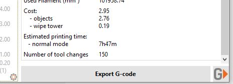

Why does it take ~8minutes to transfer ~11MB over ethernet?
Publié : 08/10/2023 8:47 pm
Blotzil
(@blotzil)
How do you transfer from PrusaSlicer, or from the Connect page?
I am exporting from Prusa slicer directly and it doesn't take that long.
In PrusaSlicer, you have to have the icon in the bottom right to export directly.
