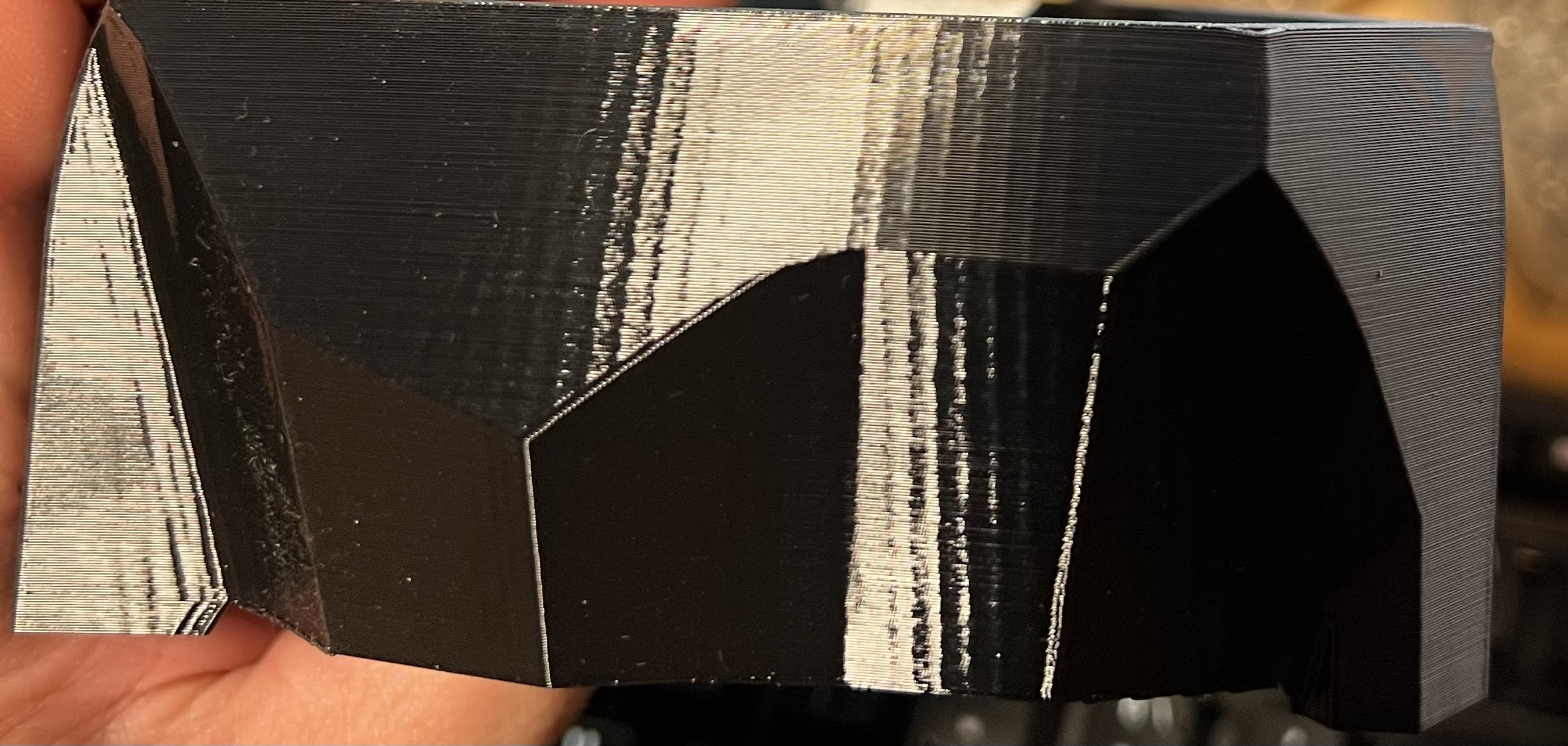

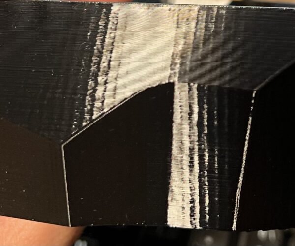

I also had the issue. After talking to Prusa support and tightening the belt a bit tighter than spec the quality did improve. I replaced the smooth idlers with toothed ones and the vfa's are pretty much gone.
1. This is how it initially was
2. This was after Prusa support was involved. (A lot better but still present; ok for functional prints but not for detailed visual prints)
3. After installing the toothed idlers
Posted : 30/01/2025 2:06 pm

Just search Amazon for 2GT 6mm 3mm bore toothed. And like JoanTabb mentioned they need to have 2 bearings.
It's not my invention, I took inspiration from this topic:
https://forum.prusa3d.com/forum/original-prusa-xl-tool-changer-hardware-firmware-and-software-help/ringing-ghosting-pattern-all-over-my-prints/
As with everything, after installing them make sure the belts are still aligned properly. With the motors disabled I moved the toolhead (carrier?) around to make sure the belt is routed properly and everything moves as it should. After that I re-ran the x and y calibrations to make sure the printer itself was satisfied.
