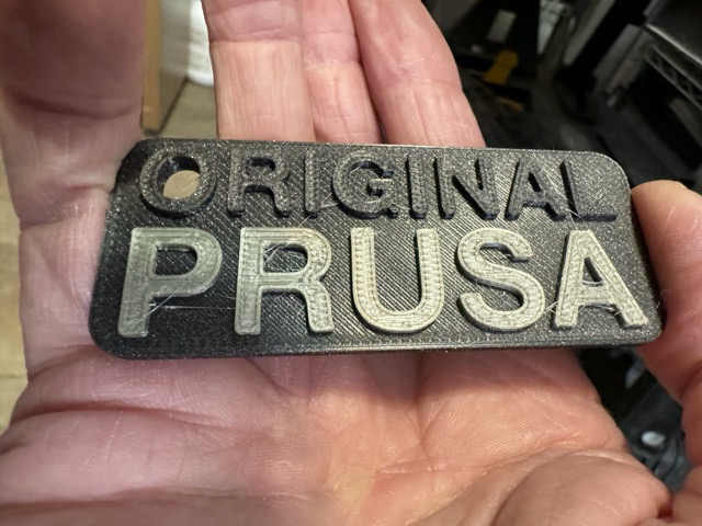

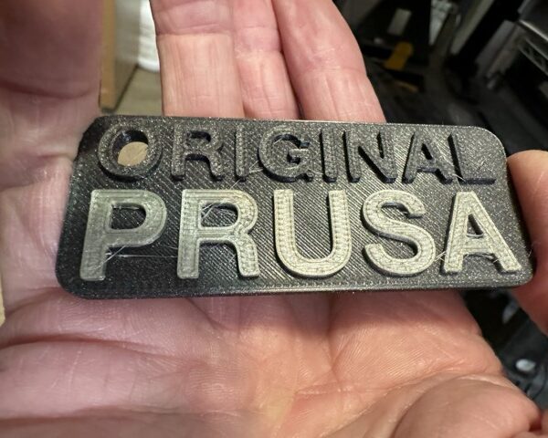

The XL arrived yesterday.
  1. Assembly was approximately 8 hours
  2. No big issues, instructions and comments were pretty good
  3. For torquing all the vertical/horizontal extrusions I used the 'wheel mounting method' of alternating screws as I found torquing one side loosened the other. Basically I did 3 strokes per side alternating between screws. Then I went back and re-torqued everything and found 1 loose screw.
  4. On self-test the only issue was my initial positioning of the extruder support bar had moved...so I removed the extruder, repositioned the bar, reinstalled the extruders and all was well.
  5. I migrated from a Qidi X-Max. The increase in machine quality and performance is astounding. The XL is a well done unit in my opinion.
  6. I suffer from essential tremors, so if I can assemble the XL anyone can.
