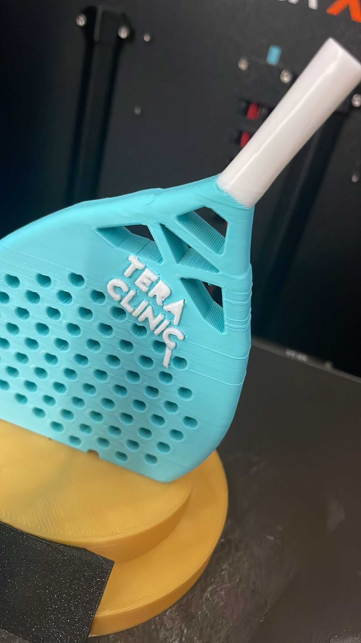

RE: its happening this to me in my prusa XL multitool, i dont know how to fix it. Its PLA
Belt tension?
Check the example on the belt tension adjustment page: https://help.prusa3d.com/article/adjusting-belt-tension-xl_401793
