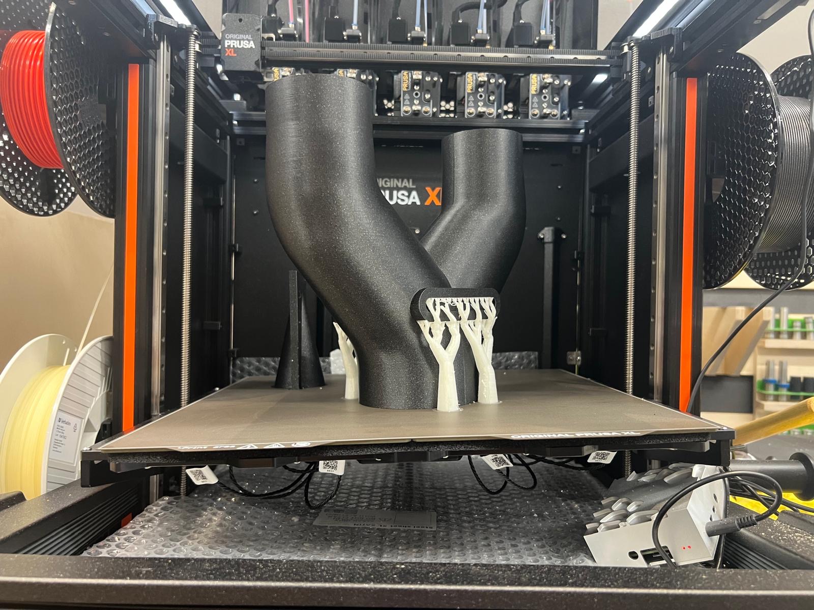

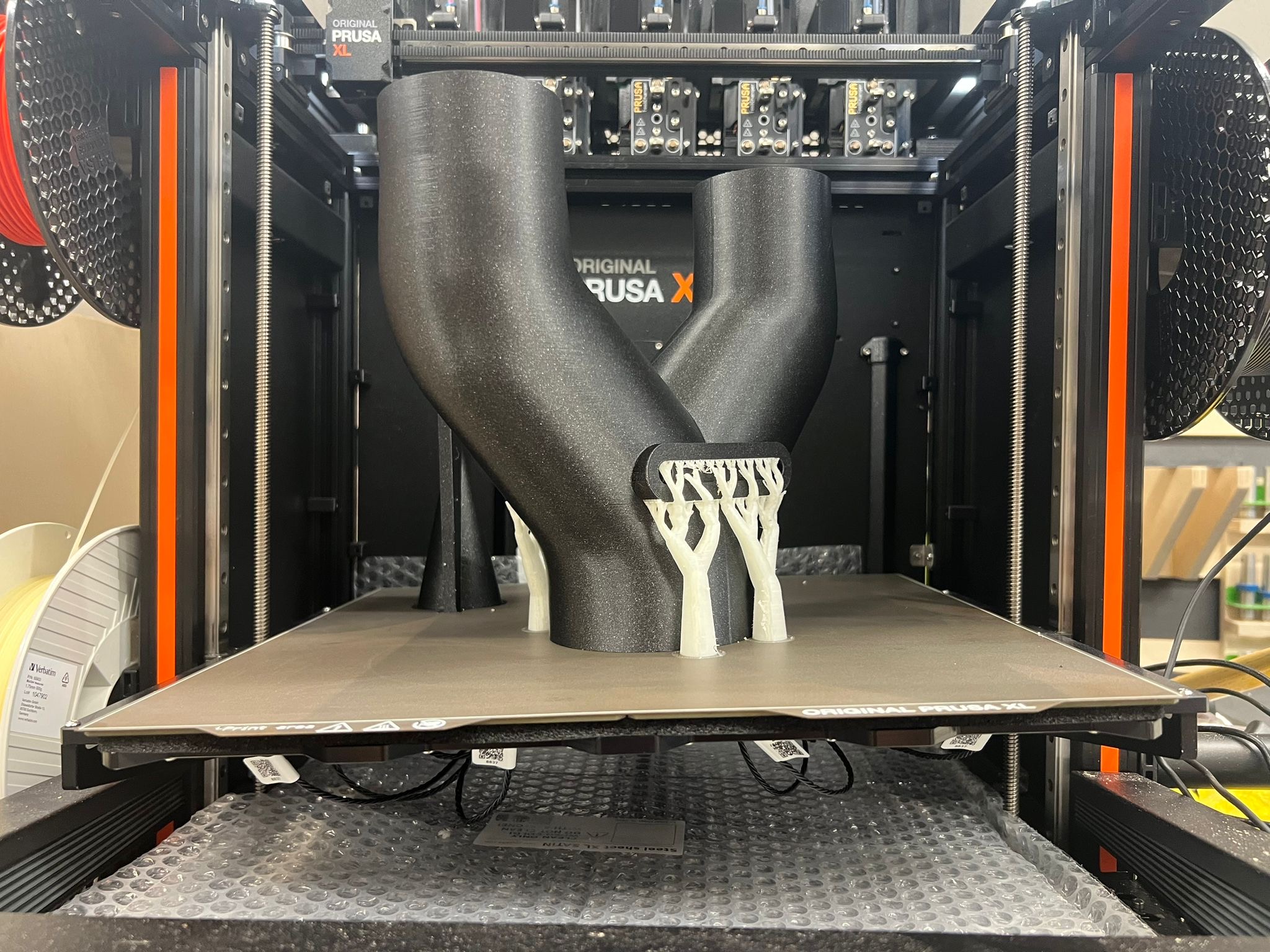

Hey Everyone,
Unfortunately my octoprint box got caught under the main platform and has bent things when the platform lowered after printing - anyone got any suggestions about how to proceed / what to order to fix / good tests to run after?
Ta
Chris

Remove the printed object, manually spin the left z rod to rise the plate (or right rod lower it) , then do a z calibration
