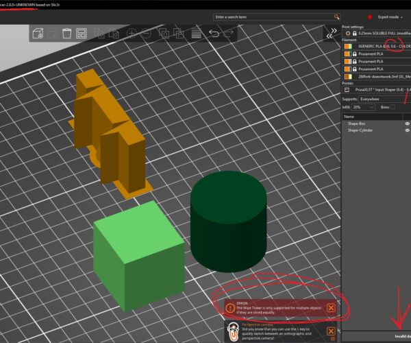

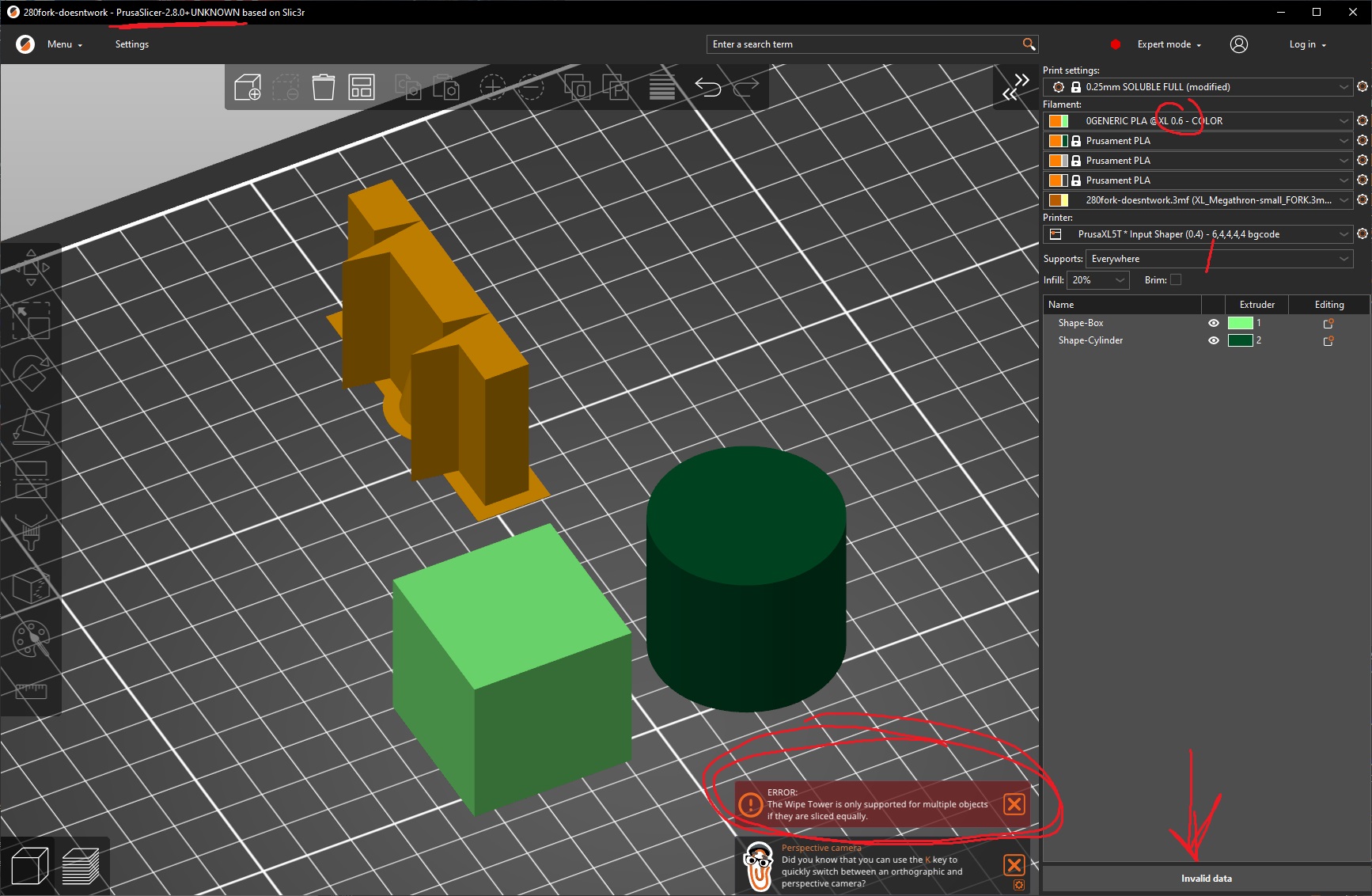

Your 2.8.0 release doesn't seem to be working for me.
Here's a quick example file. Just one box using a .6 nozzle and a cylinder using a .4
2.8.0 wont allow slicing because nozzles differ:
Old 2.7.2-a2 slices fine:

@nikhil-s
If it helps at all, it seems that two different Objects of different sized nozzles wont allow the wipe tower. However, different Parts within a single Object can have different sized nozzles and the wipe tower is allowed.

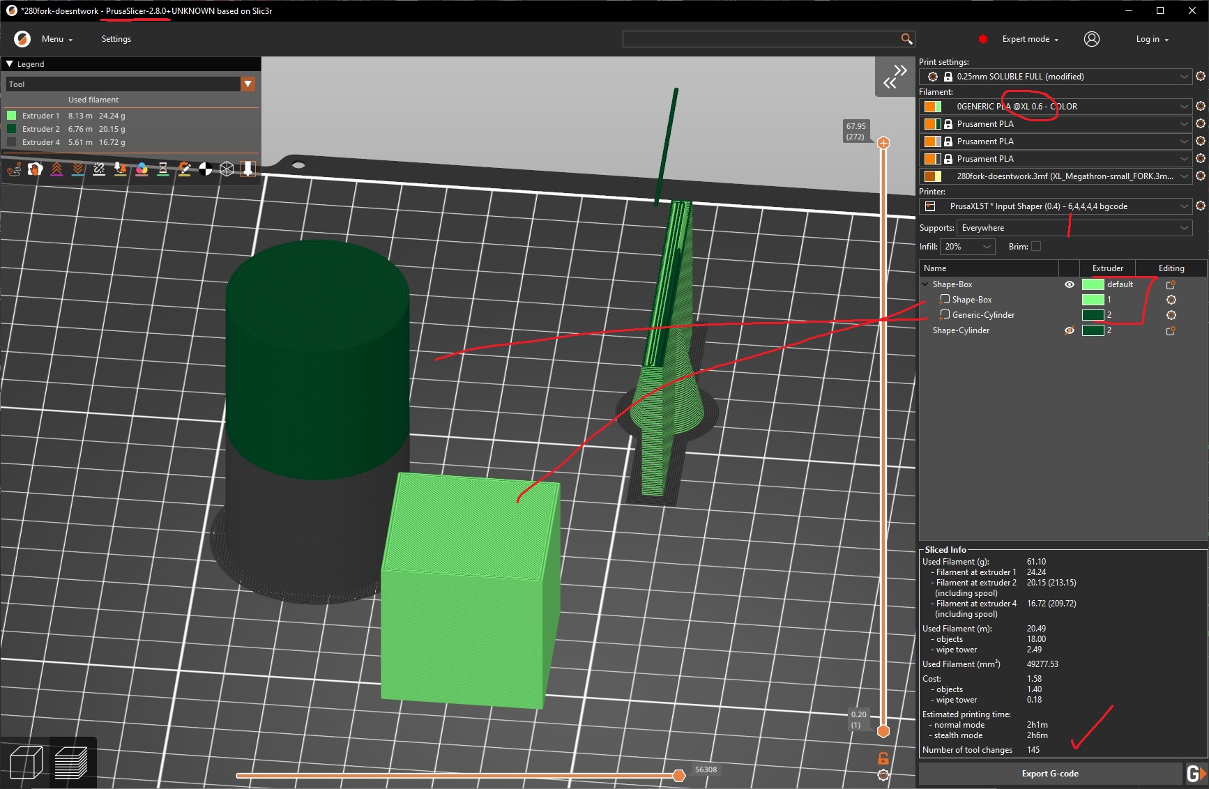

Figured out the problem (on your 2.8.1 full release at least). If the "Layer height limits" of all the Extruders in Printer Settings arn't all the same (ex: all Min set to 0.07 and all Max set to 0.3, except Extruder 1 with Min set to 0.69) then PS won't let you slice with multiple objects of different nozzle sizes.
Seems the easy thing to do is to just set all Mins and Maxes to zero. I don't know what those two parameters actually affect otherwise; the default layer heights in the Print Settings dropdowns seem to be based off the nozzle sizes rather than layer height limits anyway.

Wow - great catch! I was trying different combinations, but since mine were set to 0 by default, I hadn't found the issue you did. I will put that in the project documentation on the front page of GitHub.
