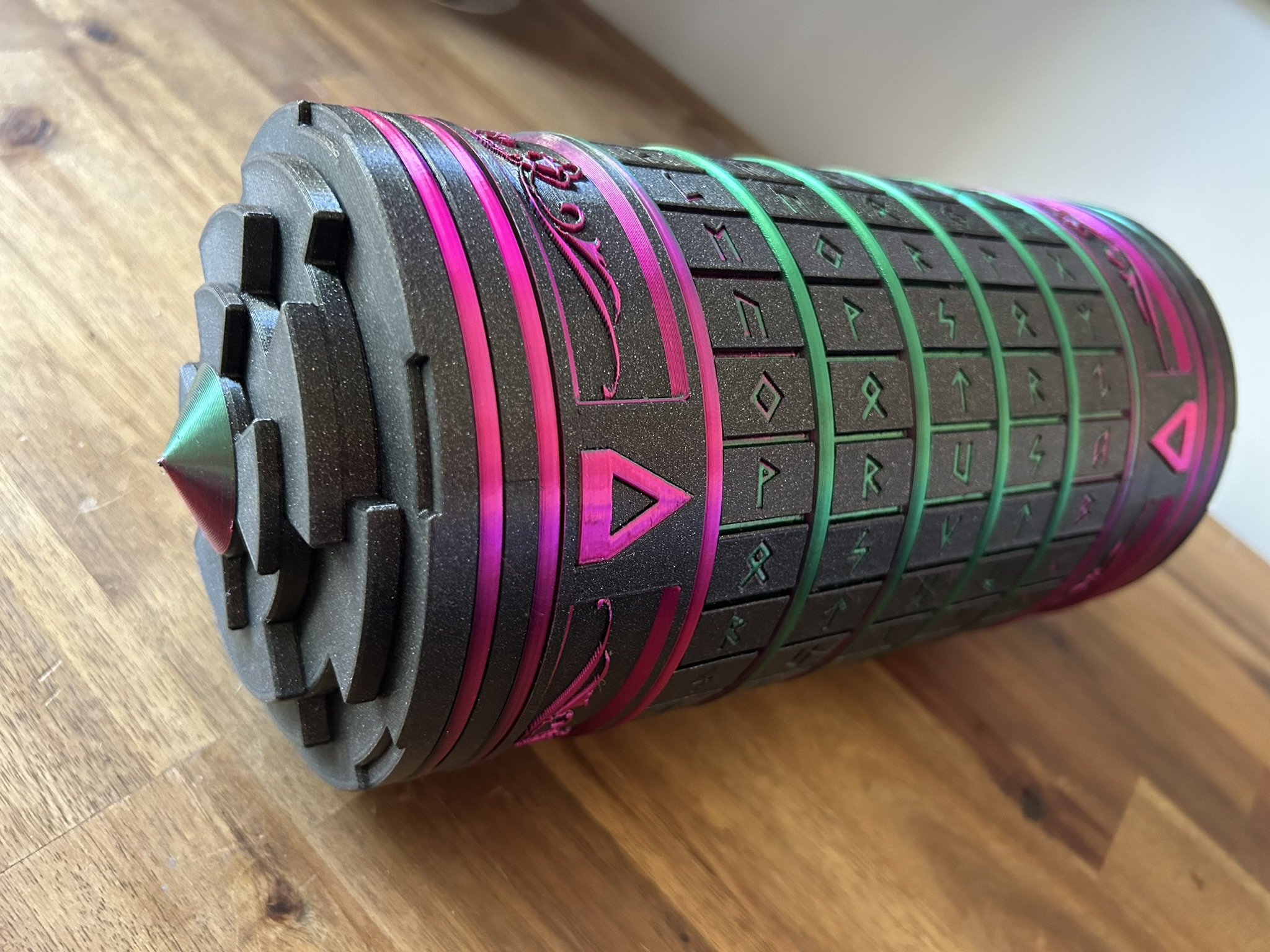

My first impression was I underestimated how large this was. I'd been considering building a Voron but put that idea on hold because the Prusa XL ticked all the same boxes and at a similar price (LDO 350 kit is $2400 AUD and Prusa XL single-toolhead was $2900 AUD). Now I've seen how big the Prusa XL is I'm glad I didn't buy the Voron because it must be gigantic. Prusa did an amazing job squeezing a 360x360x360 build volume into a relatively (!) small form factor.
Assembly had some head-scratching moments. I truly dislike the mounting method for the toolhead docks. The electronics layout is cramped despite there being so much available space. The frame design is very clever - using panels to reinforce a frame is standard practise in construction and it's more efficient (cost/weight) than over-engineered frames - but assembly of the frame/panels was frustrating. But those things aside there's not much to criticize with the hardware. IMO it's a better hardware design than the Voron (cue the angry mob).
I opted for the dual-toolhead and I'm now regretting not waiting for the five-toolhead. Multi-toolhead printing is a gamechanger for coloured prints. I had an MMU on my MK2 and although it worked it wasn't practical and was soon retired to a shelf to gather dust. With the Prusa XL I'm printing multi-material again. Many youtubers have experienced awful stringing but I've been one of the lucky ones because my multi-colour prints look great. When the 5TH upgrade kit is announced I'm not hesitating.
This cryptex was printed on the XL at 200% scale and it's better than I ever got with the MMU. I use my printers to enable my other hobbies (RC and electronics) and a large-format printer was all I had in mind initially, but the multi-toolhead has been an unexpected bonus.

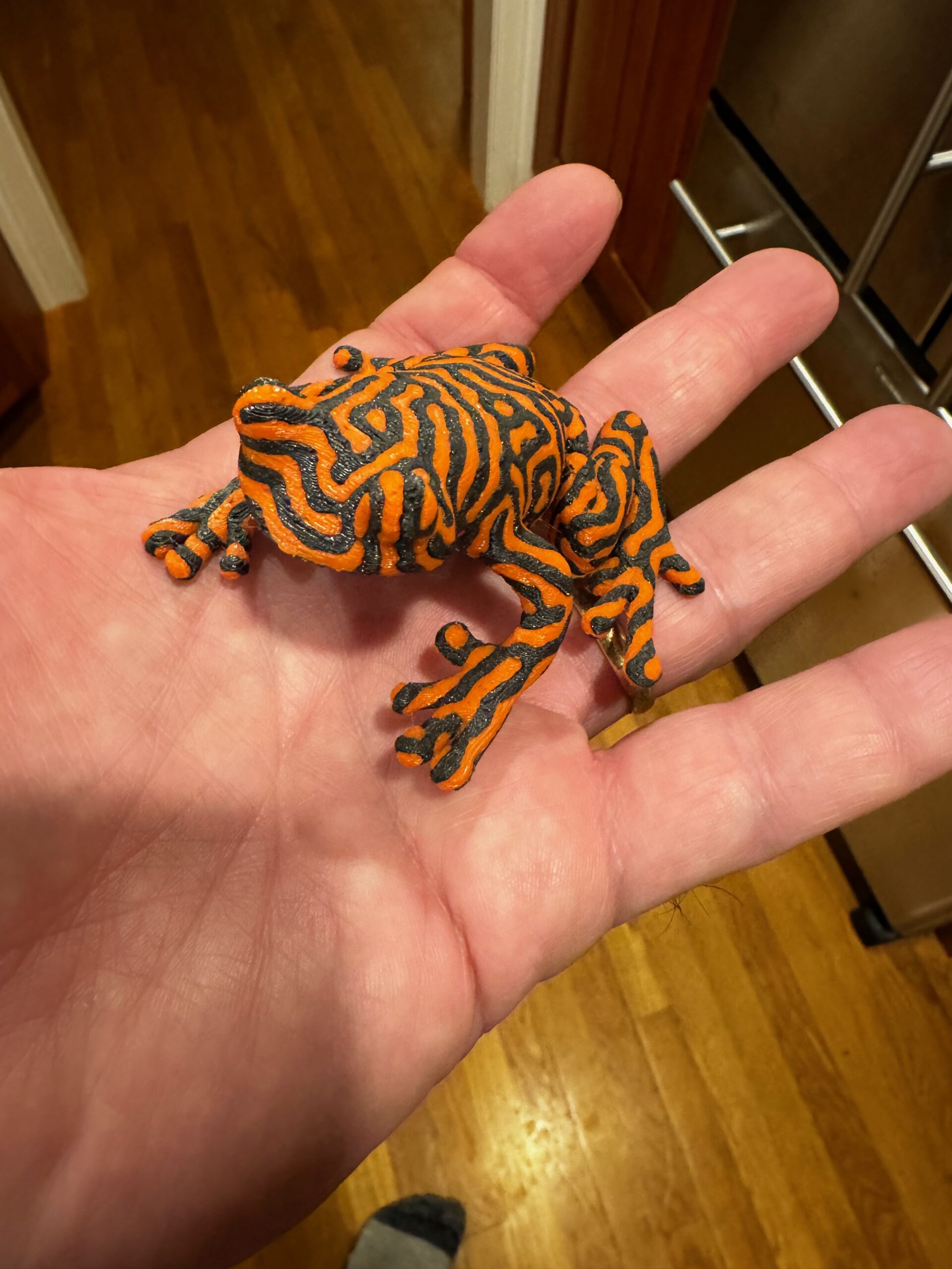

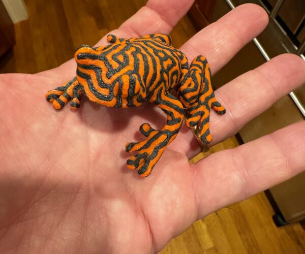

I had a pretty good first experience (it basically just worked). So The manual is way below typical standards of prusa printers (of which I own many). I also can only hear Mandy Patinkin going "I don't think that word means what you think it does" when finishing the "fully" assembled printer. That being said once it was all over and I managed to heft it into place onto the 24"x24" concrete paver I use as a dampener it worked perfectly. My first 2 tools have the obxidian nozzles as I frequently print with abrasives. The tree frog printed nicely in 2 colors of PLA as a test print (352 changes). My biggest complaint as others have noted the wires going into the buddy board box is overly tight for a printer the size that it is (The cable management is kind of poor for such a printer). The other 2 complaints I have is the PTFE going into the top of the extruder is pulled backwards by the loop of tubing and weight of the wire, and so the filament isn't coming straight down so often won't feed easily into the sensor (which I find is corrected by grabbing the tube right above the bowden clip and bending it back upright and it pops right in). Finally when running the tool changer calibration there is a UX issue where the button to acknowledge that the tool was calibrated switched to "abort" without an obvious change in button width and so we accidentally aborted the calibration by mistake as we didn't see the word changed. Going to try PLA/TPU mixed print this evening for a work-print, and see how that goes.
2 color tree frog
