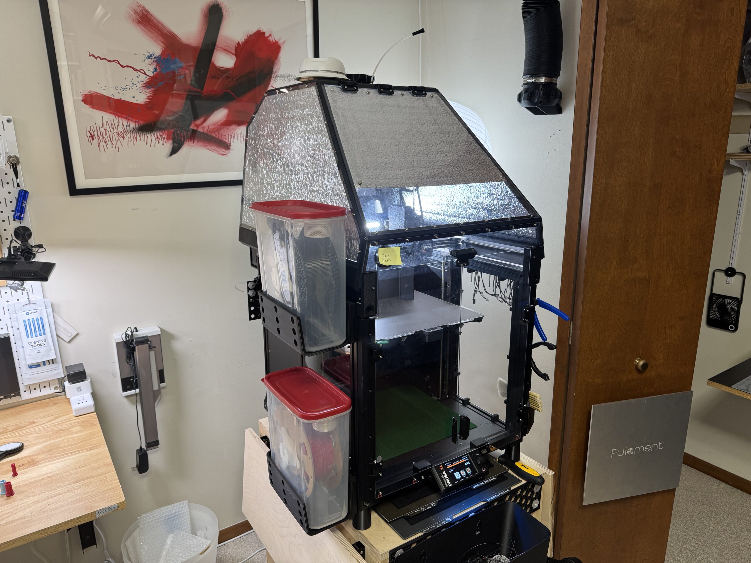

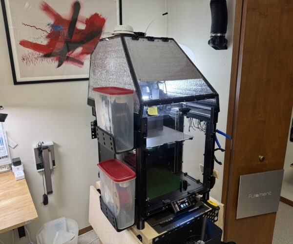

BarrittWorks
(@barrittworks)
@chicken-2 I've been away from the forum for a bit and am just seeing your posting now. Sorry I never followed up because the information left earlier is inaccurate for my XL.
When I had a chance to *carefully* measure the original extrusions (even though they were installed, a pain) I got 403mm. I ordered extrusions from 8020.net back in January  (at 403mm) and installed them and they fit perfectly. There was a bit of luck in this as 8020 doesn't promise extreme accuracy in their extrusion cuts (I've found them to be pretty close over the years). I'm not finding my notes from January, but my memory is that they came in just slightly under 403mm, 402 point something AND I had concluded after I placed my order that I might need just under 403, so it all worked out without my recutting them. Obviously getting the length right is important as when you tighten the end fittings on these extrusions you don't want them distorting the top rails.
This modification has been great on my printer. I easily installed the EnXlosure (with redesigned front pieces that mount the door hinges in the new corner t-track). As I said at on the original post, this was so that I could mount Rubbermaid 21 cup dry box holsters on these new front corner extrusions. I've also found them convenient for mounting other things to the t-tracks they provide (such as magnets for my side cutters and pliers on the right, etc.).
Here is the actual order description from my 8020.net order (in case that is helpful):
30-3030-Black
SKU: 30-3030-BLACK
30mm X 30mm T-Slotted Profile - Four
Open T-Slots
$36.30 2
Length - 15.87 Inches (403 Millimeters) x $0.53
Cut To Length - 1 x $2.79
Counterbores - 2 x 30-7044 x $3.45
Unit Of Measurement Millimeters
Order Description 30-7044 in A Left; 30-7044 in A Right;
