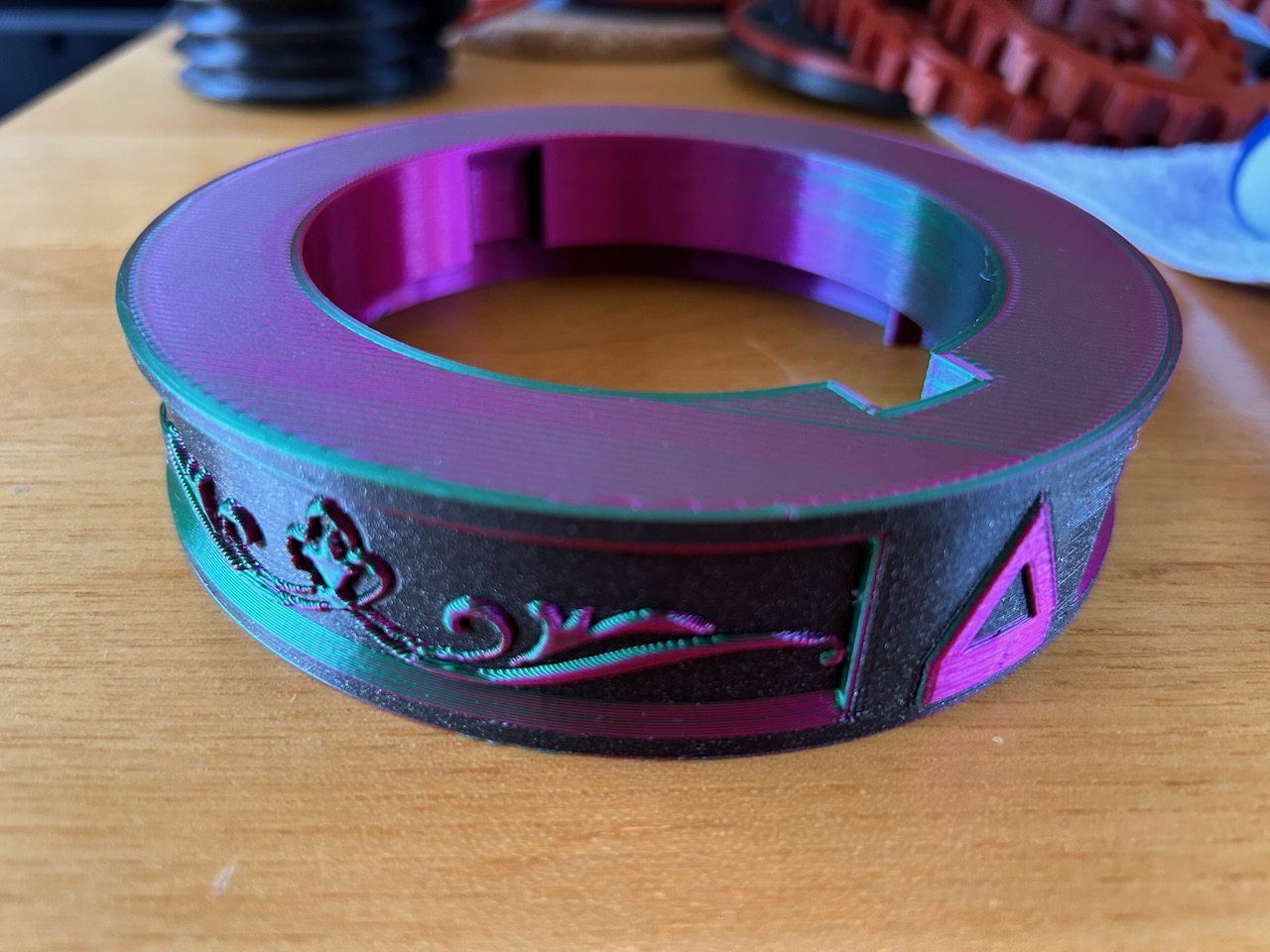

Here is a more complicated multi-material print with no wipe tower. This is printed with Prusament Galaxy Black and Kingroon Dual Silk Red/Green. Default temperatures and retractions. No stringing and no blobs. This model requires over 100 tool-changes for the filigree and would quickly highlight any issues. This photo shows the model underside because the filigree is unsupported. This is essentially the "worst" side.

Looks nice! I like the colors. I’m throwing every multi color file I’ve collected over the past 3.5 years with the E3d at my xl5. No priming. No wiping.  It’s printing each real nice… as if it were simply an appliance!
