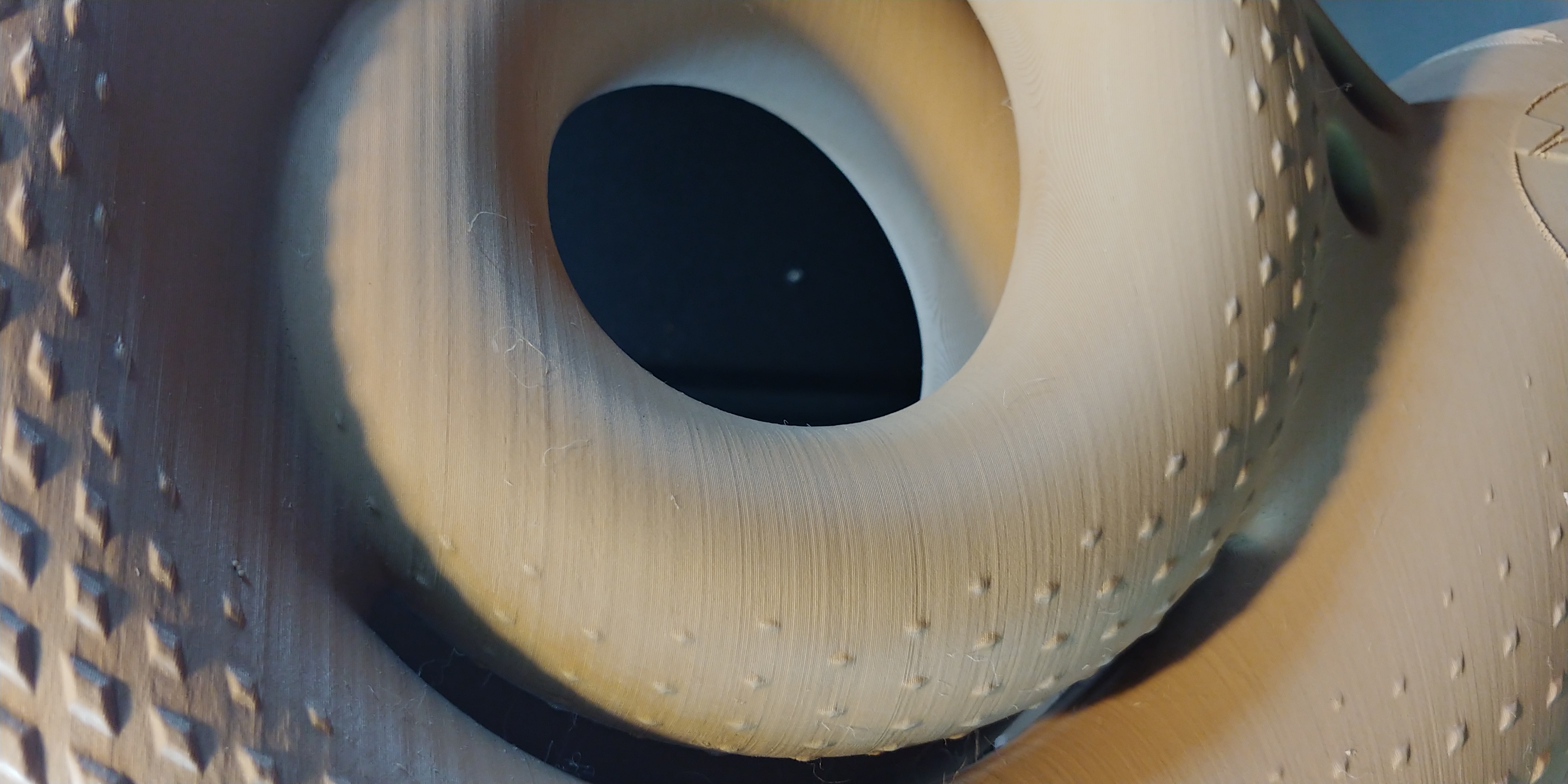

I've seen this posted many times for a variety of machines in other places, but strangely I'm not able to find it mentioned here, so I guess I'll do it. If you know of another thread regarding this issue, please link me, 'cus I'm not using the right search terms or something.
Anyway, this is the very regularly spaced horizonal banding that can be seen in pretty much all prints, usually becoming more pronounced as the layer height increases. I've attached a photo that exemplifies this issue. Aditional photos can be provided if necessary.
This is on my 5 tool machine, printing with just one tool. The problem happens with any kind of filament or print I've done to date. I keep all my filament in sealed bags with dessicant. The machine was semi-assembled, and passed all tests and calibrations first time with no problems after I finished assembling it. The issue has been present through firmware 4.7.2 with the release PrusaSlicer, and the alpha firmware and alpha slicer.
I've done a variety of screw adjustments as described in various articles here. While the banding isn't as bad as some that I've seen, it's certainly unsightly, and I'd like to eliminate it. I look forward to your assistance. Honestly, I expect this will take a hardware revision to solve, by decoupling the bed from the lead screws as has been done for a variety of other core-XY projects out there. I hope Prusa is already working on this.

The tops of the leadscrews are caged in Z axis bearing housings. As shown in this pic https://help.prusa3d.com/guide/4-heatbed-side-panels-assembly_487006#489641
Use the Control menu to move the z-axis from top to bottom and watch the Z axis bearing housings. They should be completely stationary. If they move you might have bent leadscrews.

Thanks! I didn't think it was bent, so I took video from above the bearing holders on each side.  Have you done the same on your machine? If so, do you notice ANY wobble on either of them? Here are the videos:

My left and right have zero wobble. If the banding in your first pic is spaced equally to the pitch on the z-axis leadscrew, that confirms it. Try uninstalling and reinstalling the wobbly z-axis. It might be installed crooked and that has similar symptoms to be a bent leadscrew. Check for any debris that is preventing it from sitting straight.

As I expected, there is no visible or tactile defect or debris that is keeping the left z-motor from mounting cleanly to the bracket. After reassembling, I made a video showing the deflection of the lead screw without the bearing bracket in place. Thinking about it, even if the motor were not properly secured to the bracket, turning the lead screw would have it rotating in place at whatever angle it ended up at. Only a bent lead screw, relative to the motor itself, or somewhere along its axis, would result in the end of it moving around as it does. Here's the video of that test.

I contacted support and shared the images and videos. they had me check tightness of screws and stuff, but in the end admitted that it looks bent. Andres wants to confirm with the "XL Specialists" before shipping a replacement.

I'm calling this one resolved. The replacement left z motor/screw arrived. I installed it, though that was a lot harder than it needed to be, if they would just go ahead and use connectors on the motor wiring AT the motor. But, after feeling like I undid half the assembly and re-did it, the new screw was installed (yes, I checked for straightness first). I've attached before and after photos. While the filament wasn't the same, and I threw away the before models and couldn't take a side by side under the exact same light, the prints look fantastic to me. Of course, photos make even the most minor variations stick out when lit from above, but I honestly don't believe the layering could be any better.

I found this thread while researching solutions for my own z-banding issues on my 5-tool XL.   I expected a Core-XY to have super silky walls compared to bed slingers, and from day one I've been greatly disappointed with rough walls.
I thought the idea that my lead screws were bent seemed likely, even though my banding isn't really cyclical (i.e. not every 4mm but random).  But I was surprised to observe that mine are straight as an arrow, almost zero movement at the caps through the entire vertical travel.
Luckily I did discover my issue.  I got a DIY-assembly XL, and knew ahead of time that tightening all the various screws and bolts was critical to a reliably working machine.  So I double and triple-checked every screw and bolt during assembly, and even tightened ones that came pre-assembled from Prusa.
Sure enough, I screwed things up.  There are two screws at the tops of each trapezoidal nut, and I remember being surprised that they were fairly loose from the factory, so I put some extra twist on them.  I now know that this causes heavy banding.  I did several z-wobble tower tests, and would adjust those screws tighter/looser during the test, and observed a direct correlation with how rough or smooth the walls came out.
The Prusa documentation on replacing the trapezoidal nuts cautions against overtightening, and indicates they should be gently tightened to prevent damage, but they neglect to mention is can also affect print quality.
Hopefully I didn't damage my trapezoidal nuts due to overtightening, but best I can tell it all seems good now.  Those screws are now barely tightened at all, almost to the point of being loose enough to back out on their own, and my vertical walls now print super smooth.  If you look at pictures of the trapezoidal nuts in the documentation, you will see that these screws almost are not even needed, they bed frame naturally rests on top of these nuts so gravity holds everything in place, so these screws really seem to prevent the frame from lifting off the nuts (probably when pulling off the magnetic sheet, but perhaps also during z-retracts).
The other part of the solution was making sure my lead screws were sufficiently lubricated with the supplied grease.  I don't recall the instructions mentioning to grease them, and I had already done a lot of printing without greasing the lead screws, so in case anyone else fails to grease them like me, know that it definitely makes a difference.

I've been hit by this too. I don't see it on regular prints, but do see it on vase mode prints. Prusa Support said they were aware of the issue and working on a proper guide for resolving it. In the mean time, they instructed the following procedure:
  1. On both sides, loosen the 2 screws holding the trapezoidal nut (picture 1), the 4 screws holding the Z-motor (picture 2), and the 2 screws holding the Z-top (picture 3).
  2. Move the Z-axis all the way up and down, or perform a Z-axis test which does exactly that.
  3. While the heatbed is down or moving down, equally tighten the trapezoidal nut and the Z-top parts.
  4. While the heatbed is up or moving up, equally tighten the Z-motors.
(pictures at end of post)
This worked well for me. After on left, before on right:
However, the improvement did not last. A similar print the next day had terrible banding:
It seems to me that there is nothing in the design of the printer to isolate the trapezoidal nuts from the thermal expansion of the print bed subframe. If any deflection of the leadscrews is relieved by the above procedure with the bed subframe warm, surely there will still be deflection of the leadscrews when the bed is cooler. I'm seriously considering adapting WobbleX to suit the XL. Currently, my XL is unusable at least for these vase mode prints.
