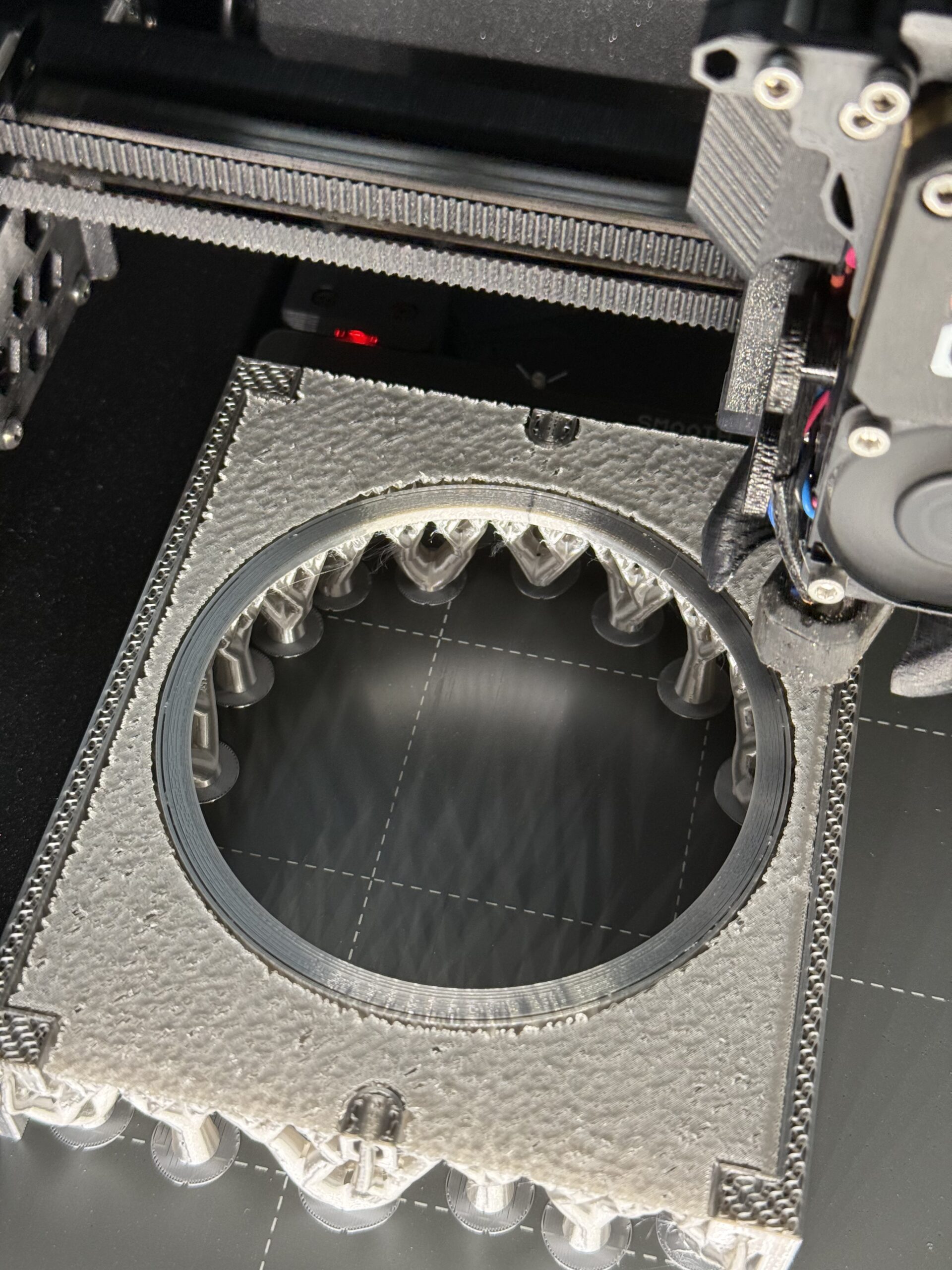

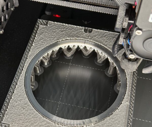

Finalfill
(@finalfill)
Miembro
RE: Trouble printing with soluble supports (PVA or Verbatim BVOH)
I got it working!
I was having a really frustrating time printing with BVOH. It was not adhering to itself, not creating clean lines, balling up all over and getting stuck/wrapped in the extruder on every unload.
I had actually given up on it and moved to painting on release agent for the support interfaces. That turned out to be unreliable and way too much work, so I thought I'd give the BVOH another go and finally got it laying down clean layers.
Setup:
Filament -Verbatim BVOH 1.75mm OD
Printer - Prusa Core One w/ MMU3 - below testing was done with 0.25mm nozzle.
Slicer - PrusaSlicer 2.9.4
Filament profile was a copy of the Prusa default Verbatim BVOH profile with the below changes made.
What helped:
1. Huge extrusion factor of 1.18. This was the thing that had the most impact on the result. With an EF of around 1.05, I saw a small improvement, so I kept pushing it.

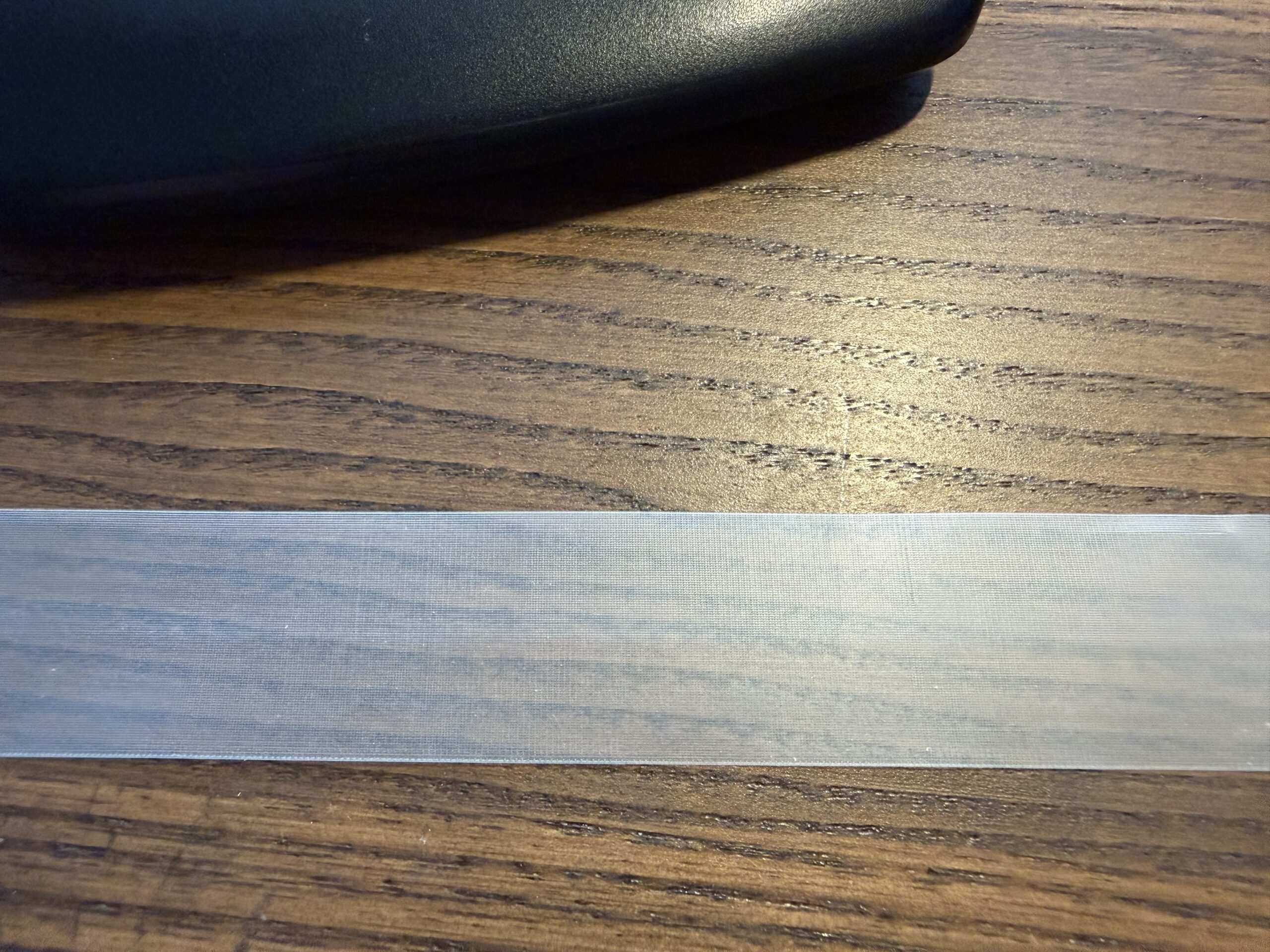

2. Low temperature gives cleaner results (smoother and more transparent). Benefits of this started showing below 200C. I have mine set to 178C - just above the melting point. I’m seeing no stringing and the prints are looking great.
3. The MMU unloading issue was solved by setting ramming time to the minimum so that“No Ramming At All” is displayed in the ramming customisation window. Setting is found in Filaments>Advanced>Ramming Parameters>Total ramming time (s). Note that this leads to oozing on the wipe tower but I can live with that. If I find a fix for that I’ll update.
Notes:
My filament is dry but not bone dry- I'm verifying the density by weighing 15cm lengths using a small digital scale, they’re averaging 0.41 grams. I'm also printing from a filament drier set to 50C.
Everyone says that you need to print BVOH slow, but I found it’s quite happy to print fast with the above settings. I pushed to 120mm/s with minimal loss in quality (I had to increase max volumetric flow to 6mm^3/sec for that speed).
Let me know if I missed anything.
Respondido : 13/02/2026 4:08 pm
1 les gusta
