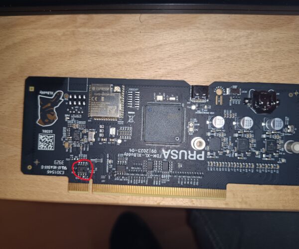

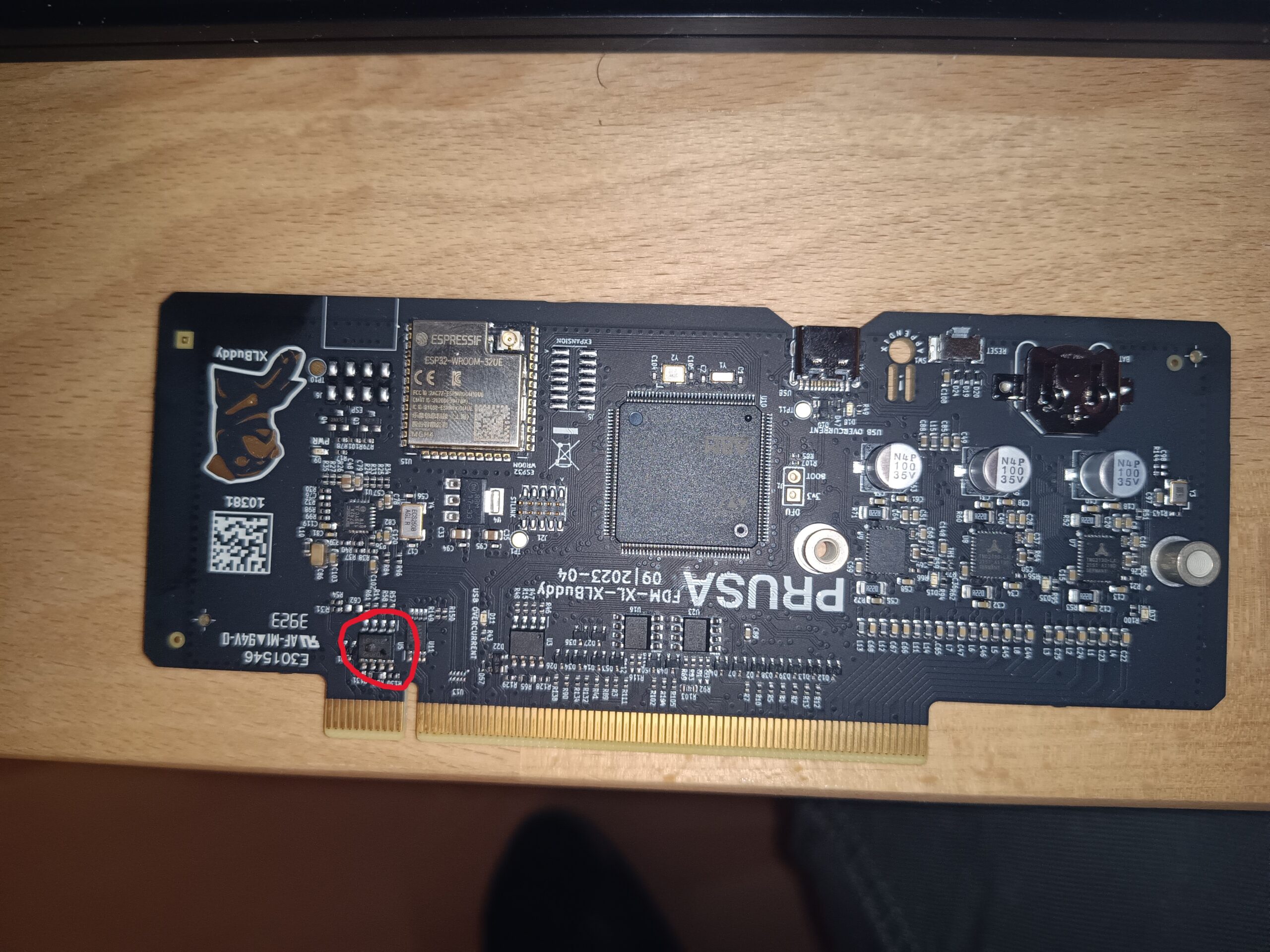

I tried to reset the Printer but no reaction. After Power off and on Printer it doesn't boot only Black screen.
After Removing the Housing of the electronics compartment, i smelld burnt electronics.
This is what i found:
The IC that burned is for RS422/485 BUS Communication.
That matches with our 17513 error.
Today I got a new BuddyBoard.
I testetd it a few hours ago.
It seems that there is a bigger Problem, the XL boots twice and then error 17513 pops up.
Reflashing does nothing, the error is now permanent.
Posted : 25/01/2024 3:59 pm

Were either of you able to find the culprit? I have the same issue, the IC for RS232/485 was burnt up, so they sent me another buddy board. Upon statup, I recieved the same error message.
