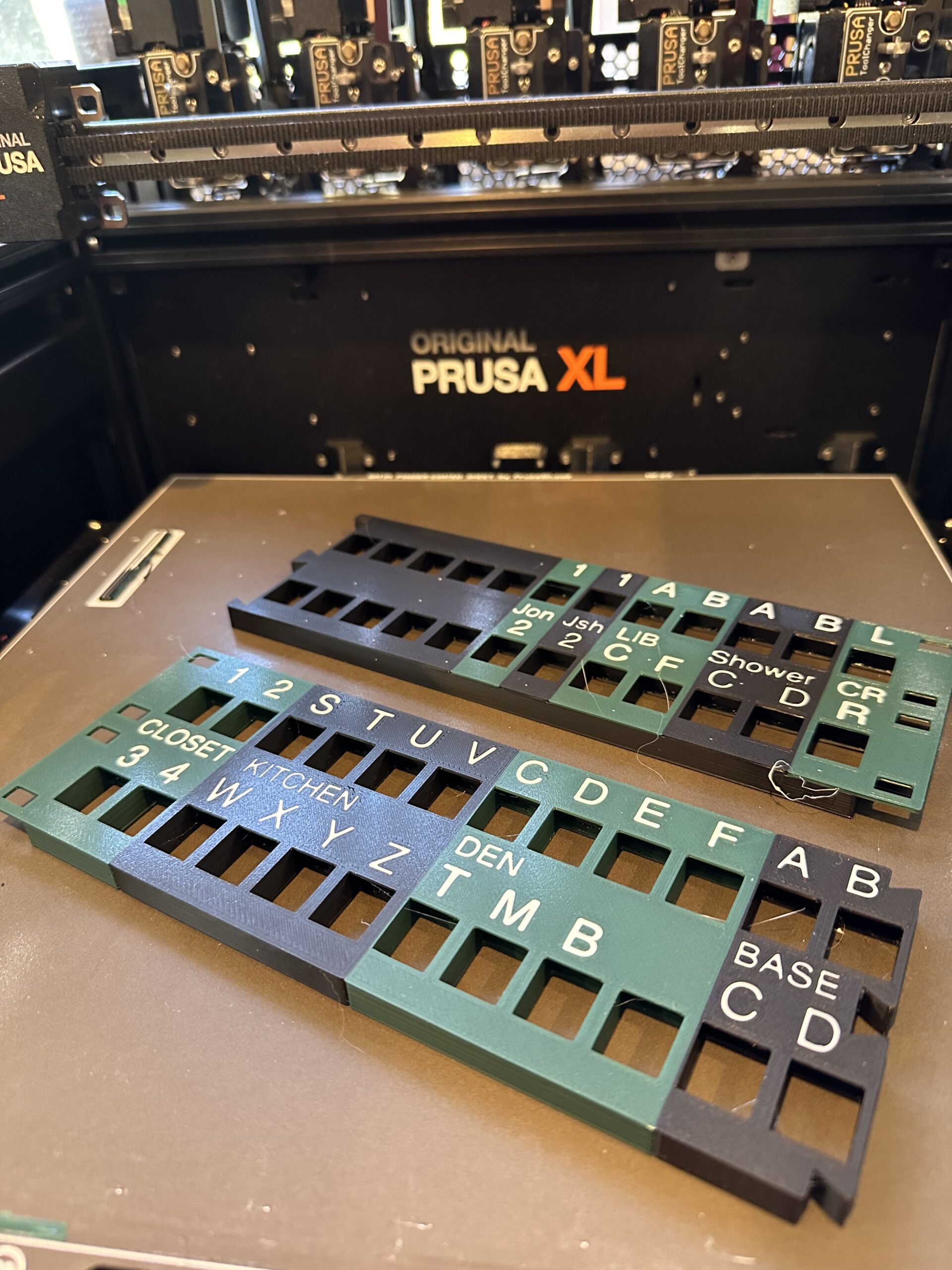

Dont underestimate how useful Modifers are. Instead of painting with a brush you can add various shapes as a modifier to your model and select a different color for the modifier.
For example, the entire model (black) is extruder #1.  The Green areas are next, I added  box modifier which I made 2mm thick across the build plate (the model prints face down) which I set to extruder #3.  Last I added the text as a modifier (backwards of course since it’s from the bottom) with extruder #2.

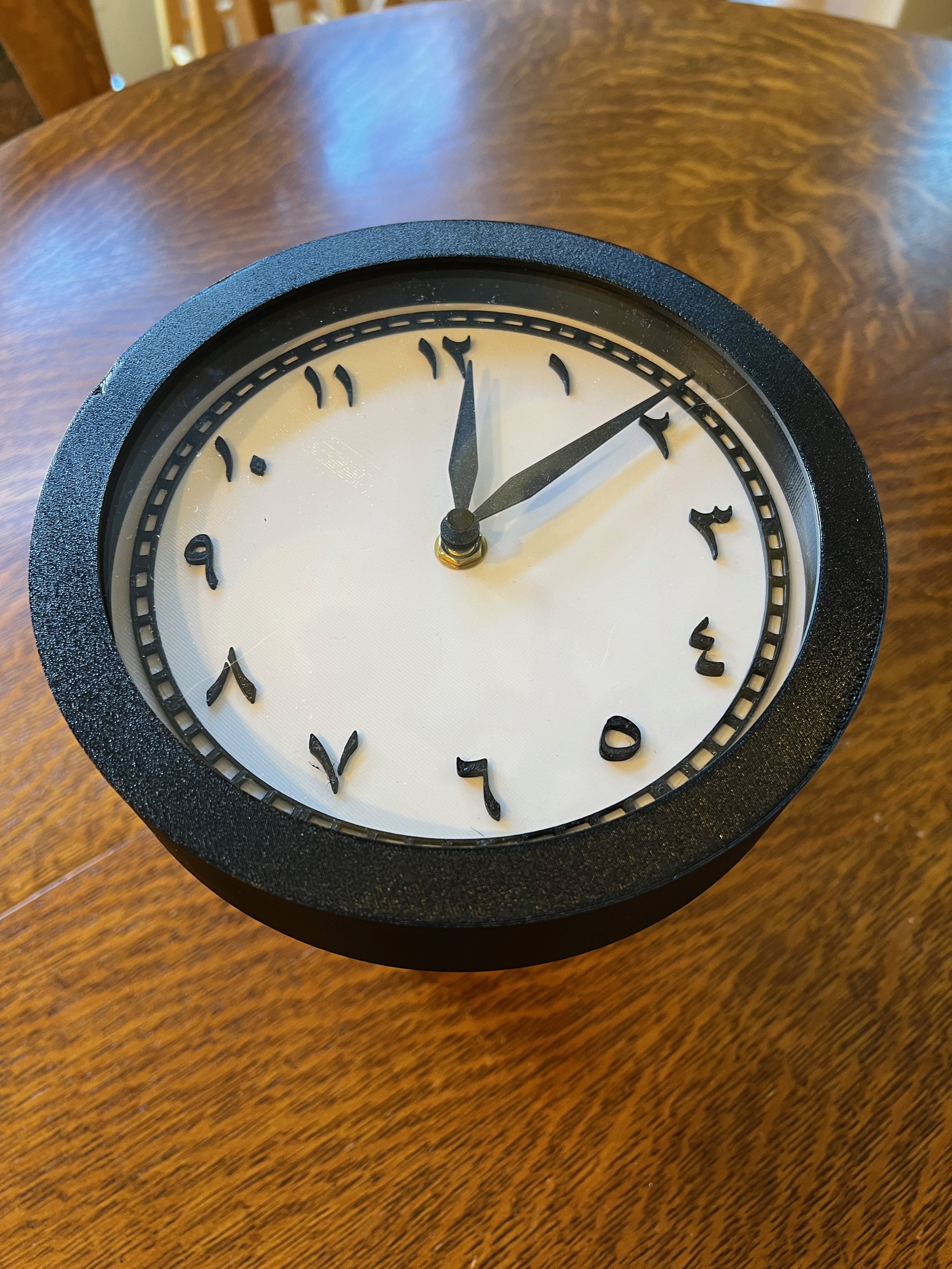

These functions result in individually selectable components in PrusaSlicer, which makes the editing "easy peasy" 😀 I'm about to alter the clock faces to do multi_color faces, plus a thin TPU layer between the case and the plexiglass. The clock in the attachment photo was made on a MK3S where I was restricted to about an 8" diameter. Now with the XL, I can go up to 13", which is great!

By the way, major bonus points if anyone can tell me the movie that inspired the clock face attached in my previous post! I have had a lot of fun trying to come up with clock faces that are weird, interesting and different. Would love any suggestions! Especially rare numerals from dead languages, stuff like that.

can you explain how you generated this ? I want to print something similar (Text on  black background, upside down on the first layer) but I have no idea how to generate the 3D model. Many Thanks.
Posted by: @kurt-gluck

Ok, so The model was derived from someone else’s model.  I did all of the work in this case in Prusaslicer.  The base object was already divided into two halves.   I took each half, doubled it, glued it back together.   I think I exported the STLs at this point.   Ok, then you import one of the STLs, in prusaslicer you can (like tinkercad) add simple shapes.   The difference is not only can you add them as positives or negatives but you can add them as “modifiers”.   A modifier is like a shape but has no realness, what it has instead is the definition of a region that you can then assign properties to.  In this case the property is a different extruder.  You could also change infill densities etc.     So for the green area I define rectangular prism modifiers  (started as cubes then resized) that define the region I wish to be green.  I then change the extruder in these areas.
To do the text, I next use the slicers text tool (after remembering to flip the view so I am looking from the underside)  but instead of embossing text, I add it as more modifiers defining yet a 3rd extruder.
If you search for KURTGLUCK in printables, you should be able to find my version of this model, see the simple STLs and the 3MF file
