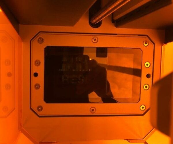

Display test appears to fail... but hasn't failed
Step 6 - Display test in Preflight check on Page 6 of 25 of the SL1 Assembly Instructions show a black and orange Prusa Research photo.
I thought my UV leds must have failed as mine looked like this photo but without the orange. Ie I could see the LCD was working but I had the wrong background colour.
As you can see from this photo, I was looking through the orange cover. There doesn't appear to be any light coming from under the LCD, but at least text can be made out;
Prusa Display Test Error
After reseating the connectors, I realised the UV leds and LCD were fine when I could see reflected UV light on the inside of the metal cover (I gave up screwing it on and off whilst troubleshooting errors).
Perhaps I had the orange cover up?

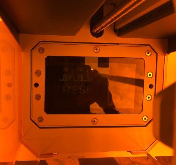

RE: Display test appears to fail... but hasn't failed
Prusa Display is working Prusa Display and UV LEDs are working
Here's that photo. As you can see, I was looking through the orange cover.
Sorry Olef
I mangled my edit. I was looking through the orange cover. I'm unable to correct my original post, but I posted a reply saying "
Prusa Display and UV LEDs are working[/caption] Here's that photo. As you can see, I was looking through the orange cover."
My point is that the LCD with the UV leds turned on looks like the photo I posted above, not like the photo in your reply or the manual. I thought my UV leds were broken, because the photo in the manual is misleading. They weren't broken; I've printed lots of prints now.

Going through the checklist, I've noticed that my display is very faint just like your picture, and not bright like the display-test example photo.
I've tried two of the built-in demo-prints with Prusa Tough Azure that haven't even produced build-up on the FEP (whereas it's not even adhering to the build-plate.)
I plan to do more testing, but if it's not even building up on the FEP after ~4 minutes of run-time, then it's not curing at all..
IF the display is not as bright as the example photo but it is still visible, should I expect everything is fine?
