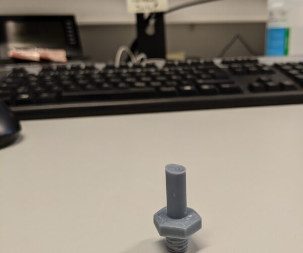

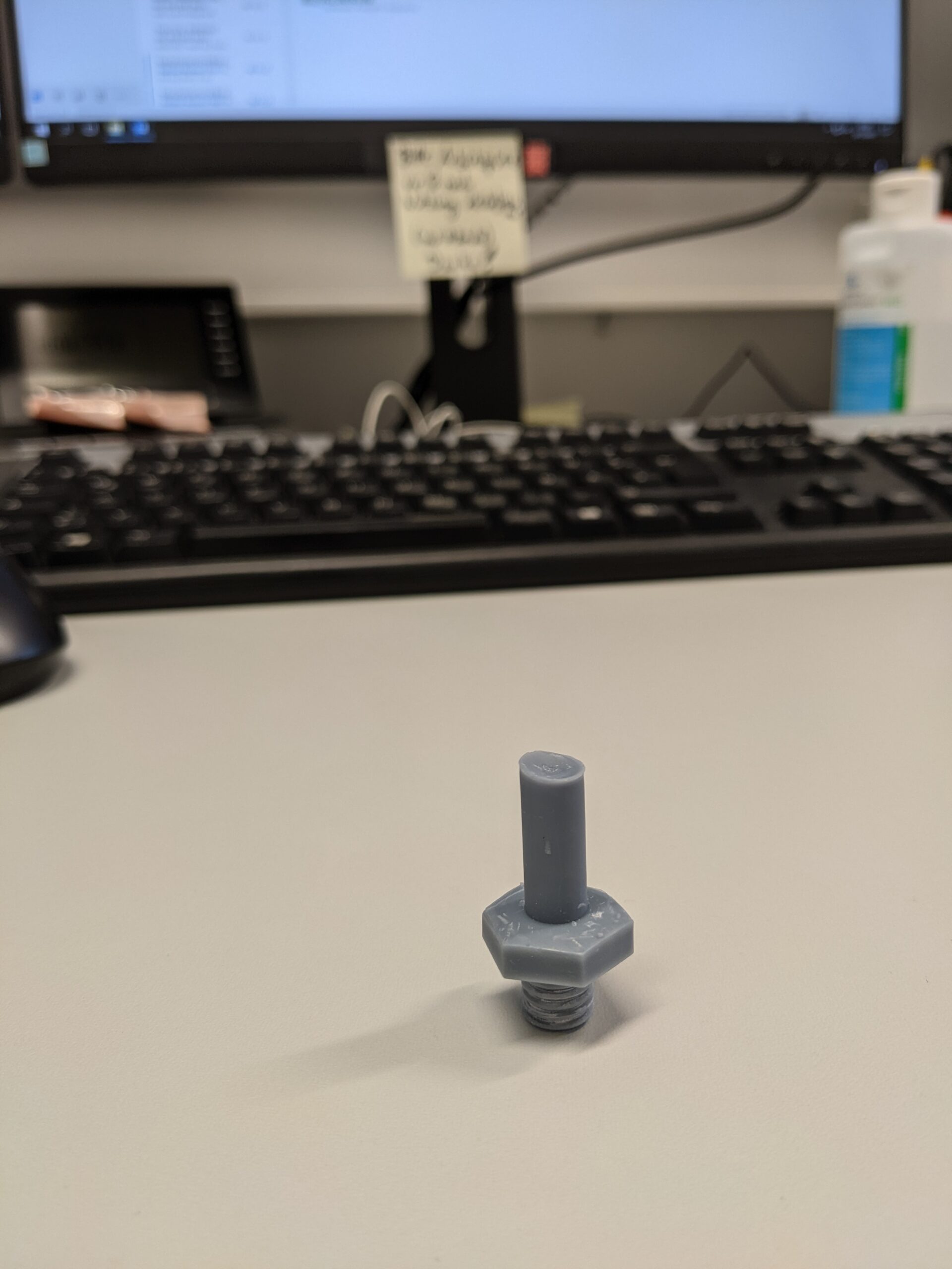

Hello,
I am getting bad Quality on the bottom side of my prints. The surface isn't as clean and straight as it should be.
Straight walls look like bumpy roads basically.
I also included a picture where you can see how I had the benchy orientated while printing.
Also on the 3rd picture there is something that looks like a wet spot but it isn't.
If someone has a solution to any of my problems I'd be thankful for a reply
(Layer height: 0,05mm, relatively fresh resin)
Thanks!

Looks like bubbles. Maybe you have too many air bubbles trapped in the resin? Surface of the liquid resin in the vat should be smooth.
Is it like this before you wash and cure the part?

Thanks for the answer,
I dont have any bubbles under the surface of my resin.
When I take it out of the printer it is like that, so its not a washing/curing problem.
I also raised the exposure time by 1.5 sec but that didnt help eighter.

sorry for the late answer, more supports in areas where a new surface is getting printed helped for me
Posted : 13/11/2019 6:55 am

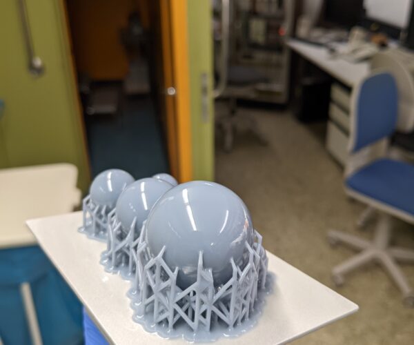

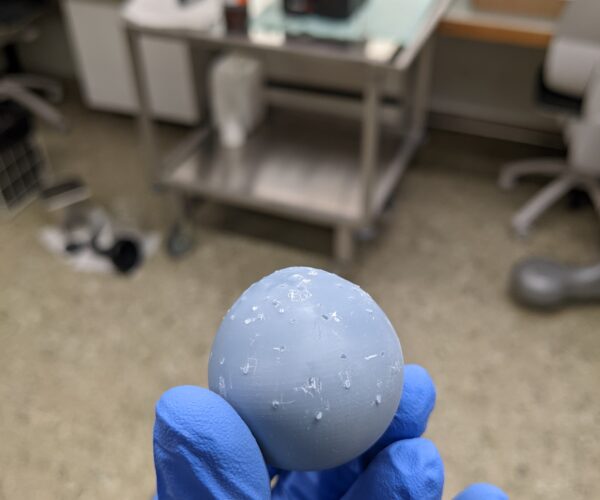

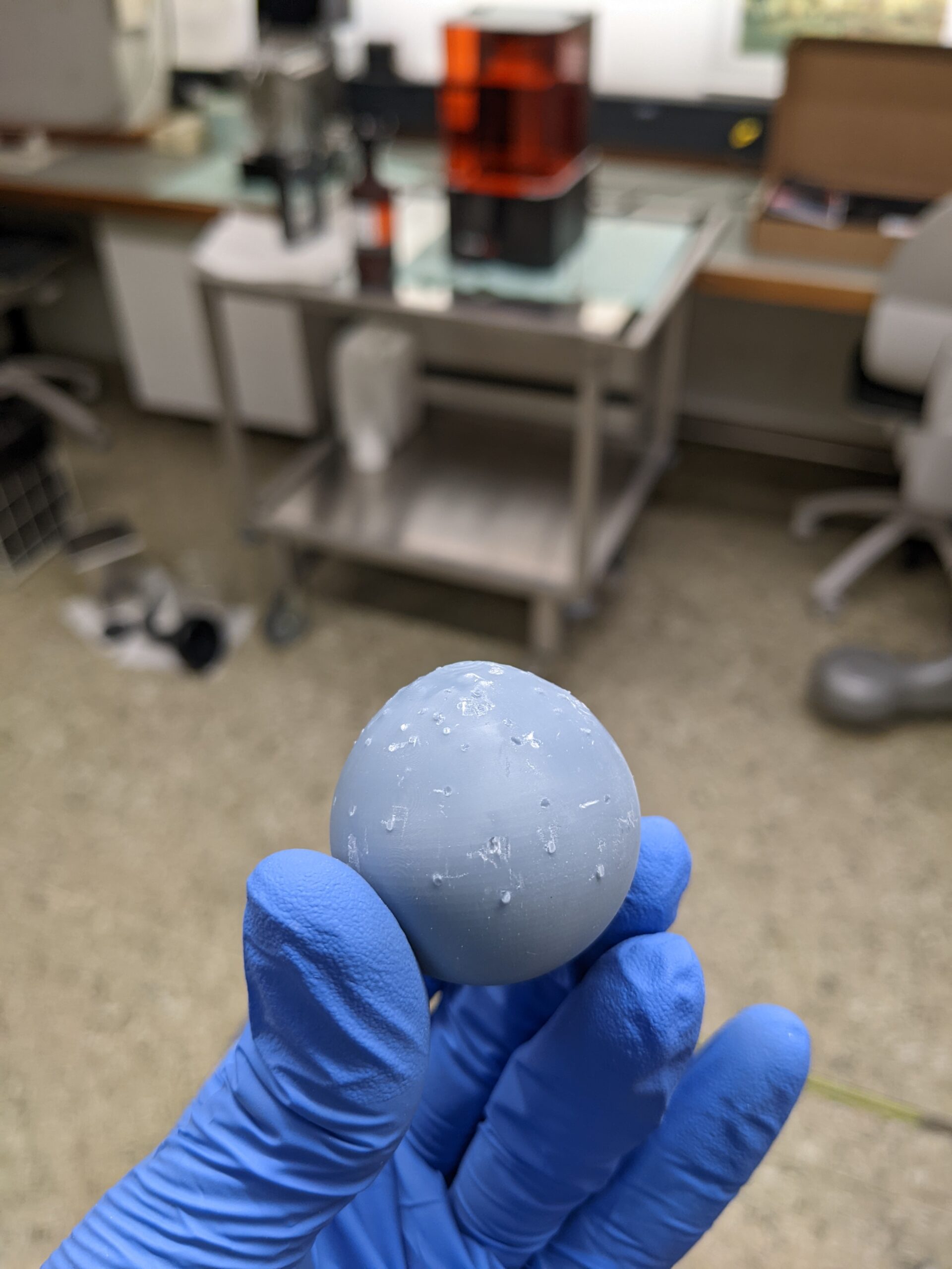

Hi guys,
I'm having the same problem with the SL1S and the Grey Tough Resin. All of my prints are deformed on the bottom half, while the top half comes out perfectly. At first I thought this was caused by detached by supports but I increased head diameter to 0.6mm and pillar diameter to 1.3mm and added supports manually and it still happened with all supports intact.
Im going to try to further increase support strength and exposure times because I can't think of any other reason for this problem. I mean it shouldn't be the resin or FEP film or a calibration issue etc, because the top half comes out fine, right? This is really frustrating, I just want to print spheres. I should be able do do this simple shape with a device like this...
top half looks nice bottom half looks like an egg bottolm half warped even on small part
This post was modified 4 years ago by adzounek
Posted : 20/12/2021 8:57 am
