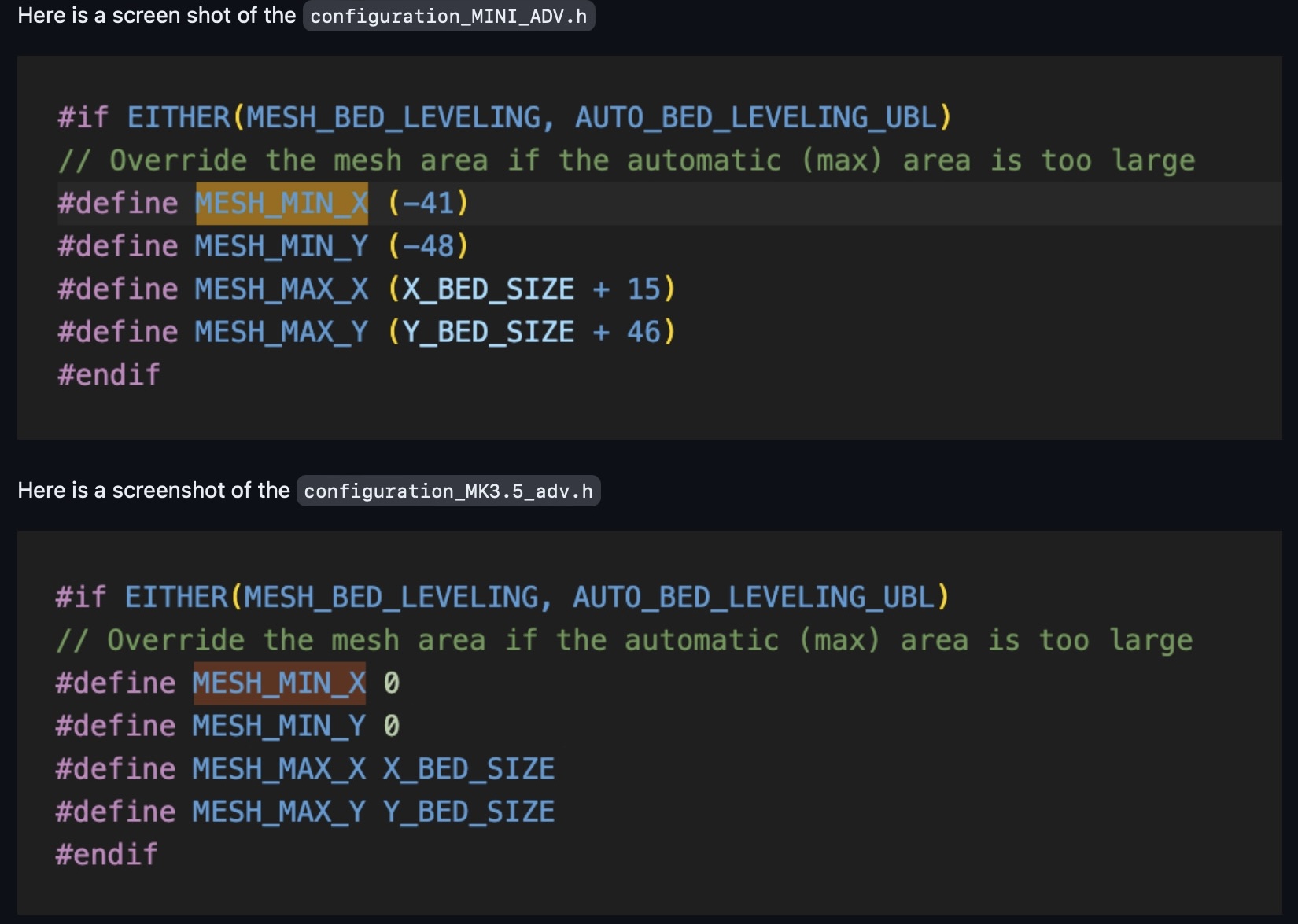

Today I tried to make a part that takes almost the full width of the build-plate and got poor first layer performance on the left side of the build plate, beyond where the mesh sensor measured (at approximately < ~55mm from the left edge of the plate). Observing the z-axis screws during the print, I could see that as the head crossed that x < 55mm mark the screws slightly raised the nozzle, so this seems likely to be a bed-leveling compensation issue.
What I suspect is that there's a mesh bed leveling extrapolation issue in the MK3.5 firmware. Because the inductive sensor is to the right of the nozzle, it can't get all the way to the left edge of the build plate to take a proper reading. Seems like something is going wrong which is causing the first layer's height to be incorrect outside of the leveling measurement area.

https://github.com/prusa3d/Prusa-Firmware-Buddy/issues/3772
There's a bug here where others have reported seeing the same behaviour. Might be worth bringing it to the attention of support too

My best guess here, but everything points to the lack of proper offset info being programmed in for the PINDA.  The MK4 uses the nozzle and does not require an offset.  If you look at the way the MK3.5 probes the bed, you can tell that the probing is off on the X axis by the same distance between the nozzle and PINDA.  This causes it to drop and entire row of probe points.  Also with what I've experienced the lack of a proper offset for the z-axis also causes the nozzle to end up a bit too high.

It looks like they put the offset into the firmware for the probe offset, but they might have left out extending the bed size for probing.  A friend of mine was helping me look through the firmware and this seemed like a likely culprit.  I don’t have the skills to compile a firmware so I can’t test it.  Look at the attached screenshot comparing the mini to the 3.5.

I have the exact same problem with a MK3S+ upgraded to MK3.5. The printer is pretending to do a 7x7 mesh bed calibration, but only actually doing a 6x7 calibration. The left 10% of the 3x3_cali_rl print is way too high, while the remaining 90% is way too squished.
My hypothesis is that the 7x7 mesh bed leveling is properly calibrating the right 6x7 grid and using a default -2.000mm offset for the left most column. I tried an experiment by lowering the SPINDA probe to the thickness of two sheets of paper instead of using a zip tie. The first layer calibration is consistent all the way across, although it is printing too high. This confirms that the suspicion that the uncalibrated left row of calibration points defaults to -2.000.
The printer would likely work fine if I had a taller nozzle and the SPINDA probe could be set for a calibration setting of -2.000. 🙂
It also means that the firmware should be easy to update. All they need to do is make the printer run a full 7x7 calibration.

Someone on the Prusa GitHub already opened the firmware, changed the offset parameters and recompiled it into a custom firmware that addresses this issue.  It seems to be an easy fix all things considered.  Makes me wonder why it's taking so long to get a patch or new FW release from Prusa to fix this.

FYI the 5.2.2 firmware is out which fixes this issue, https://github.com/prusa3d/Prusa-Firmware-Buddy/releases/tag/v5.2.2
I upgraded both of our mk3.5 printers and they are now printing the first layer calibration as usual and doing a 7x7 mesh level check.
