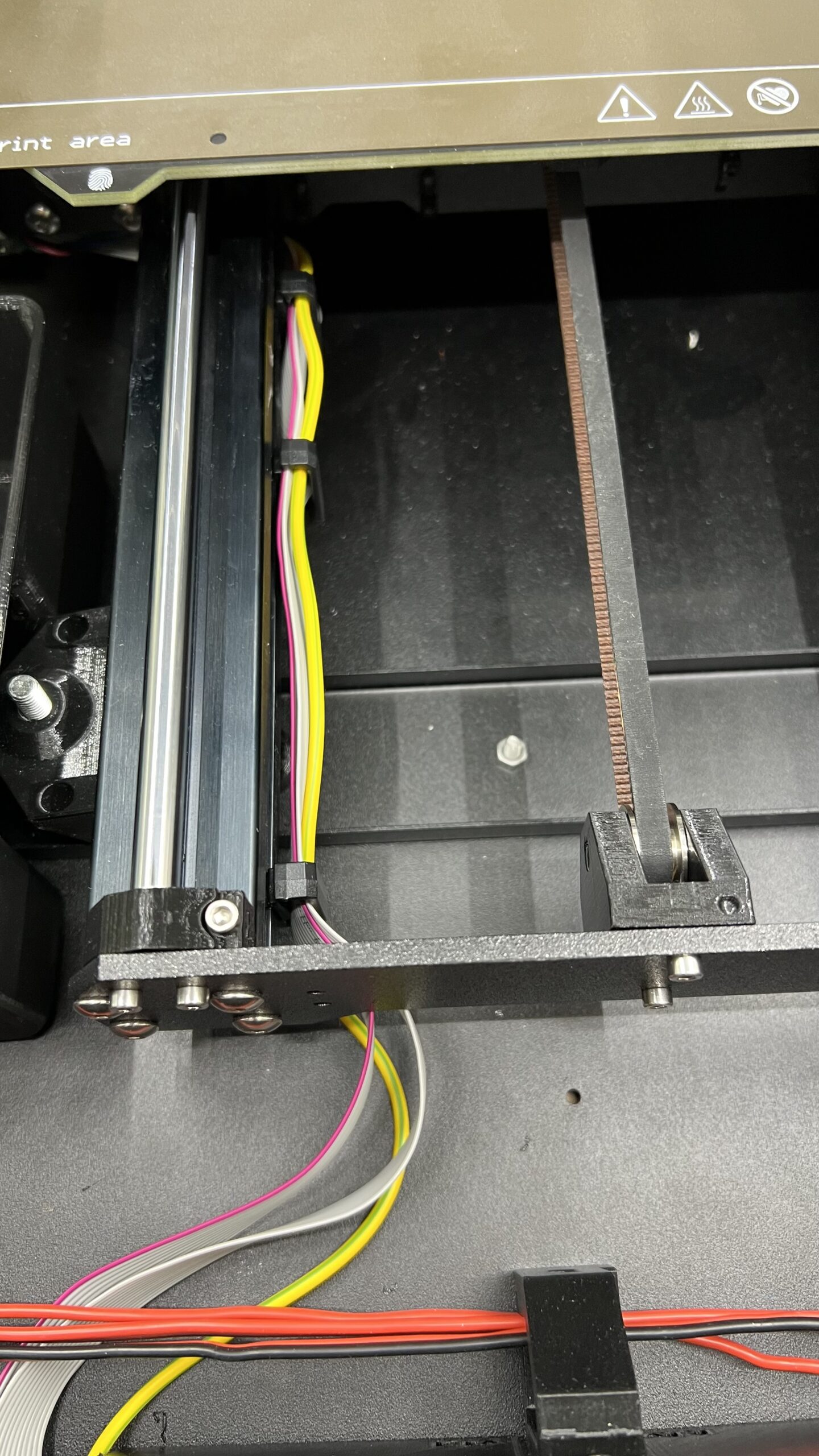

I can just give you the inside of a lack enclosure. There's more free space than the mk3 setup so you can do it. (the back of the bed (power cord) doesn't touch the glass wall)

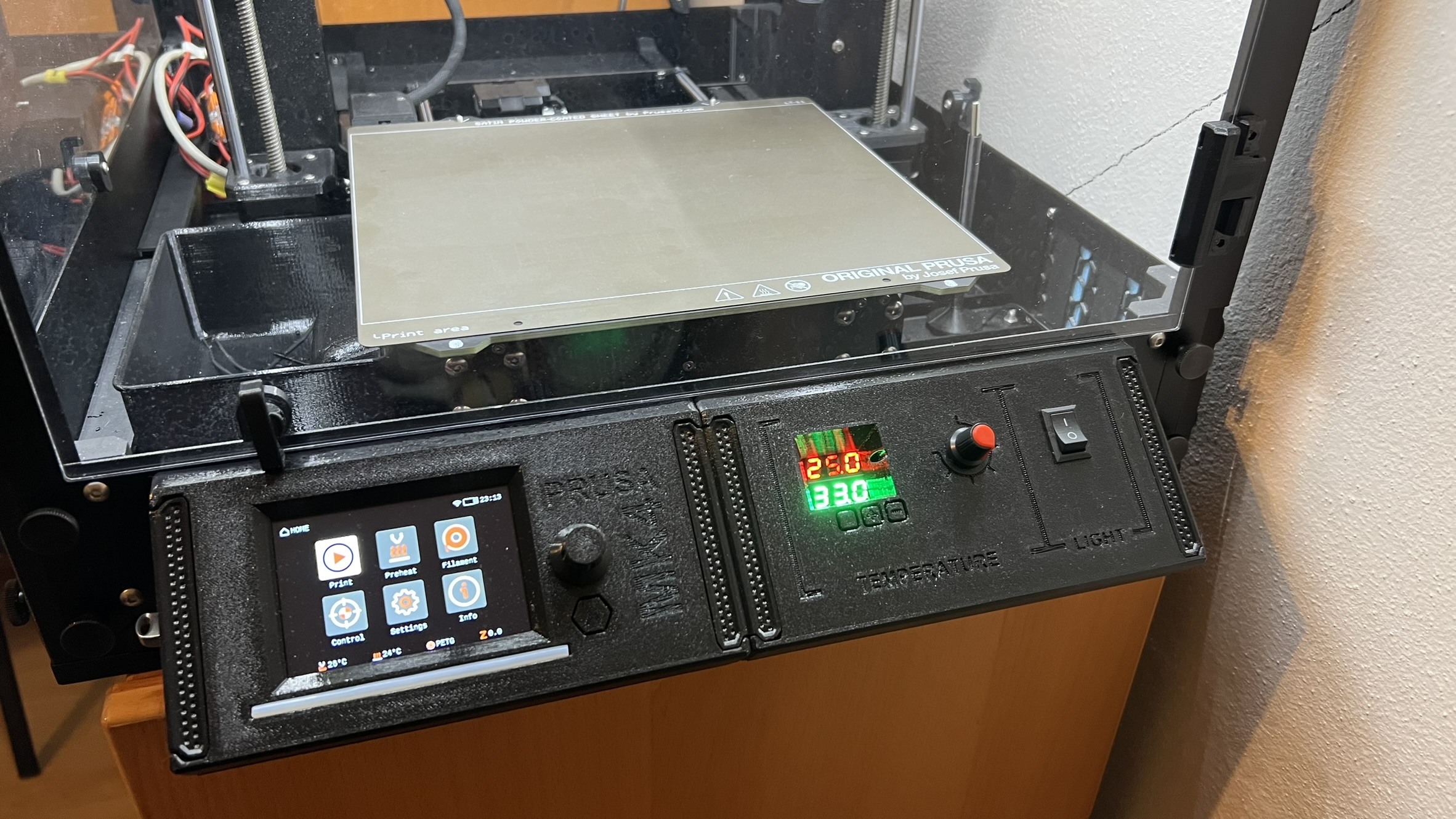

Well, what enclosure? I am using one from PrinterBox and the outside modular control panel works just fine (I have used the one for the new PCB version front).

Not sure why the image didn't stay with the first post, but I'm using a Lack enclosure as well.
Hiigara: Your setup looks excellent! I'm already space constrained in all dimensions, looks like you have a brick under yours? Does the new setup have longer legs to make it higher too?
Numo: Your setup looks sleek an beautiful. Are your panels attached somehow to the outside base of your enclosure? Where does the cable to the display run, is it protected or exposed? If I could make a setup like yours and drill the display to the base of the bottom Lack table and have the cable protected for the run to the printer I think it might work for me...

This is the product - the front base has cutouts where various variants of the panels can be mounted. The routing of the cable is the default mk3.5 one with clips; the cable is long just enough. It is unprotected but there is no stress along the path.
In your case the LCD would need to be below the base to be able to open the doors and the cable definitely does not have enough slack to go out, then down and still be routed this way. It most probably will be possible by routing it the shortest path and printing some clips/protection to attach it to the Lack table, if the panel is mounted on the left side. It will run very close to the left Z motor, which is kind of risky from the interference point of view, but well, just try.
Yes, got a brick under the printer.
I'used to have the MMU2S before and didn't need longer legs. (MMU3 upgrade ordered)
But! I have the top carved to place the MMU2S (as show on this one https://www.printables.com/fr/model/3673-prusa-enclosure-v2-mmu2s)
I don't think Prusa provide enough lengh to set up the panel outside (except using a weird path and NO concrete brick)

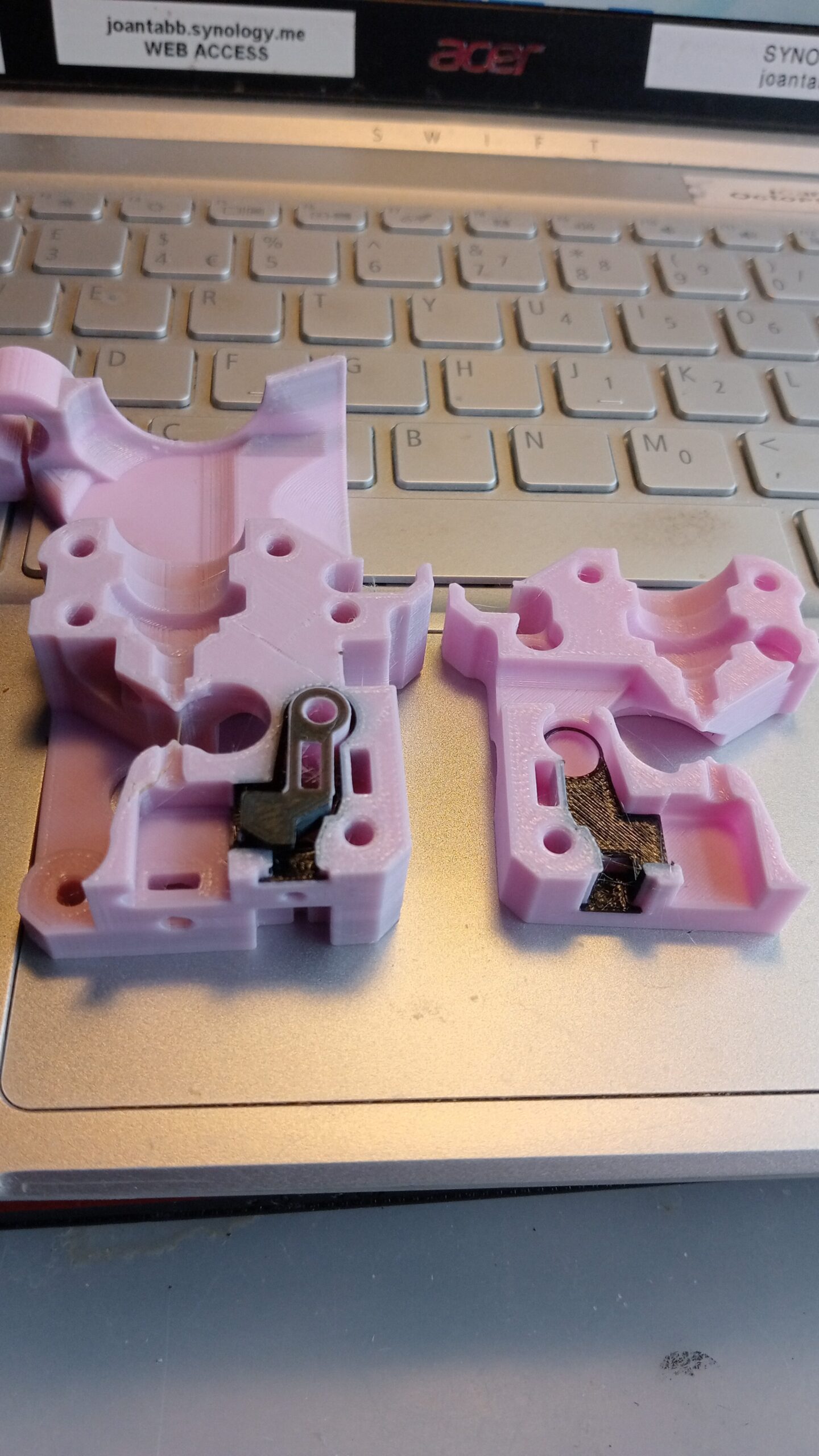

Hey I struggle a looong time with the mmu2s. Reprinting the idler did the trick.
https://www.printables.com/fr/model/19229-mmu2s-idler-improved-mounting-for-motor/comments/1517000
Print with 500 tool changes without any intervention.
Then did this upgrade. (sometime the finda think the filament is still engaged cause of debris or the Ball in the upper position.)
https://www.printables.com/fr/model/150514-prusa-mmu2-selector-with-magnet-and-opened-finda-c
After the first modification. The mmu2s was fully working.
I upgrade to mmu3 cause the mmu2s is not compatible with the mk3.5 (if I could. I'll stay with the mmu2s)
