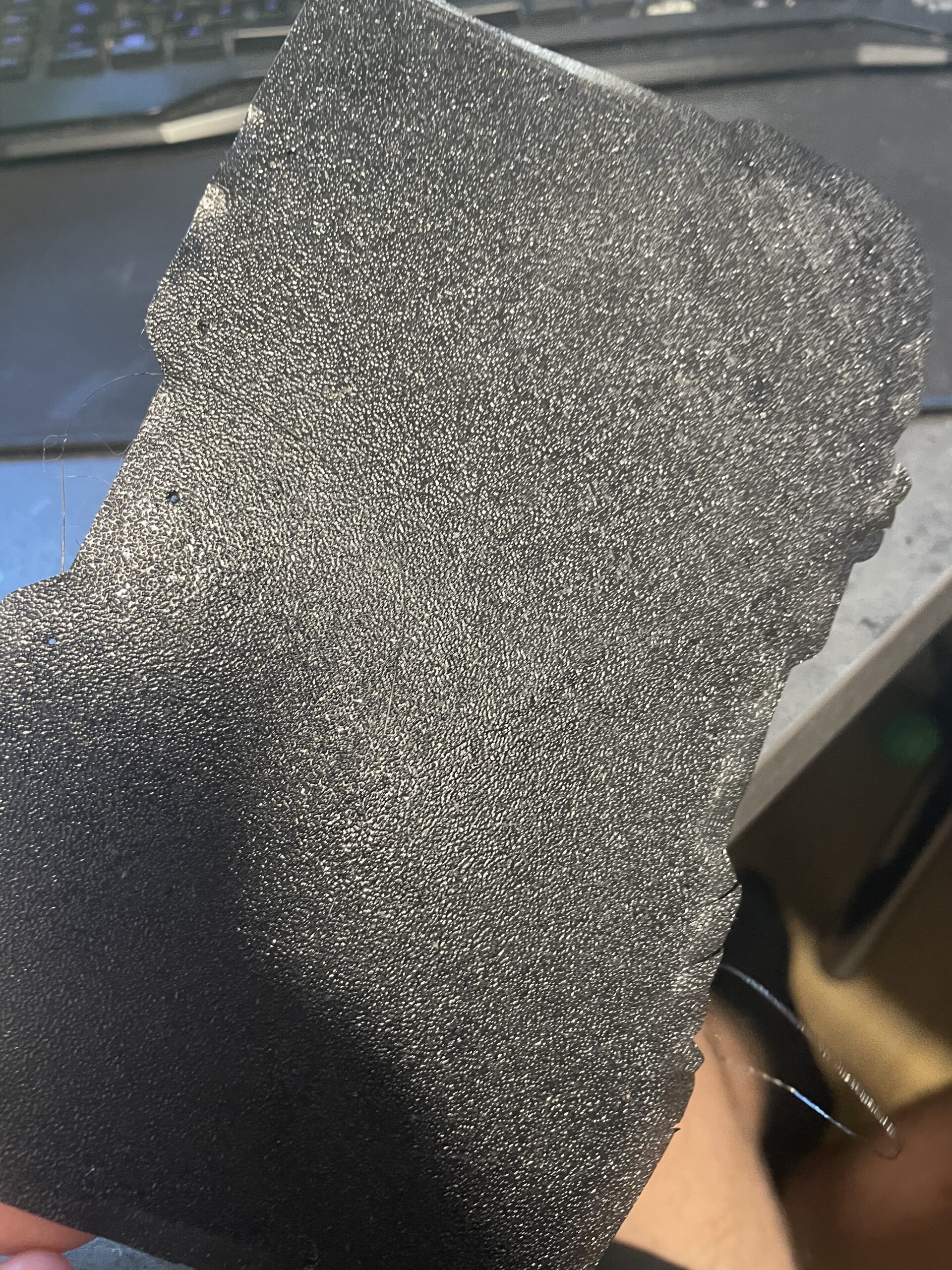

What could i do to fix this?
CoyDK
(@coydk)
So i recently bought amazons petg and have had a few good prints. then suddenly this happens. First layers are fine then it gets fuzzy.
0.6 nozze
240 Celsius
Posted : 27/06/2024 6:59 am
Eef
 Eef
(@eef)
Others will maybe have better ideas, but these are my thoughts: (underextrusion)
- temperature setting could be not fitting to the filament -> print temperature tower and check what is best for this filament
- could this filament be not dry enough? You probably got it in a closed plastic bag + box.
- could there be a partial clog in the nozzle?
Posted : 27/06/2024 8:10 am
