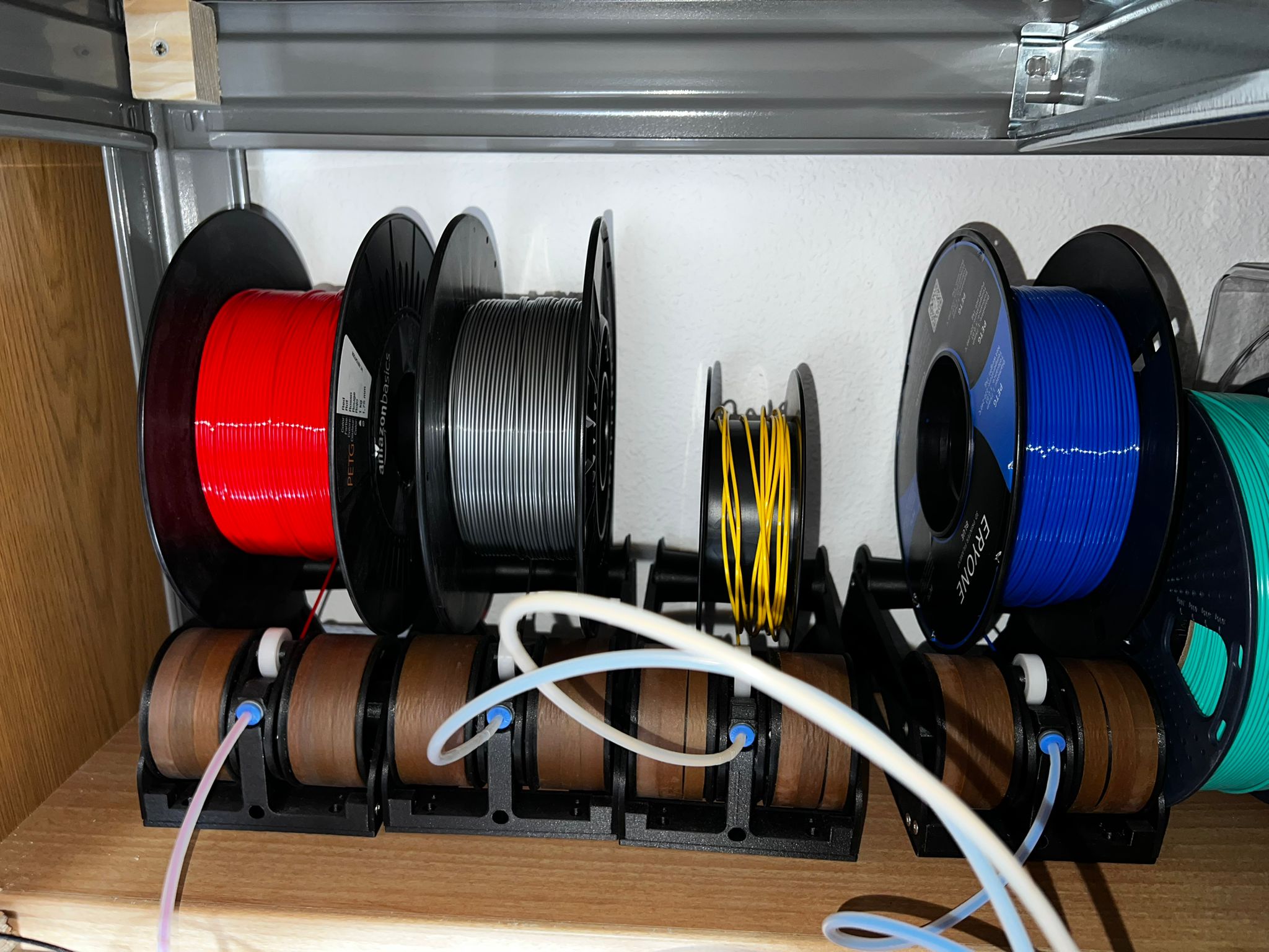

jrlebel
(@jrlebel)
RE: First thoughts on Filamentalist auto-rewinder
i just finished building and installing the filamentalist rewinders in an (un)original drybox. Still have some tuning to do but it works pretty well although I had to revert to a strait through ptfe tube to the extruder. It looks like going through the y splitter was creating too much friction and the MMU would slip not being able to rewind the filament at time. I’ll give it another try later as I like to by-pass the MMU when using ASA, ABS and such. I really only use the MMU for PLA.
IMG_1156
Posted : 08/12/2025 6:27 pm
Rainer
(@rainer-2)
That sounds promising. I've just ordered five kits. But I'm going to install it in these boxes.
I use these Festo connectors when I want to bypass the MMU.
Posted : 09/12/2025 7:49 am
