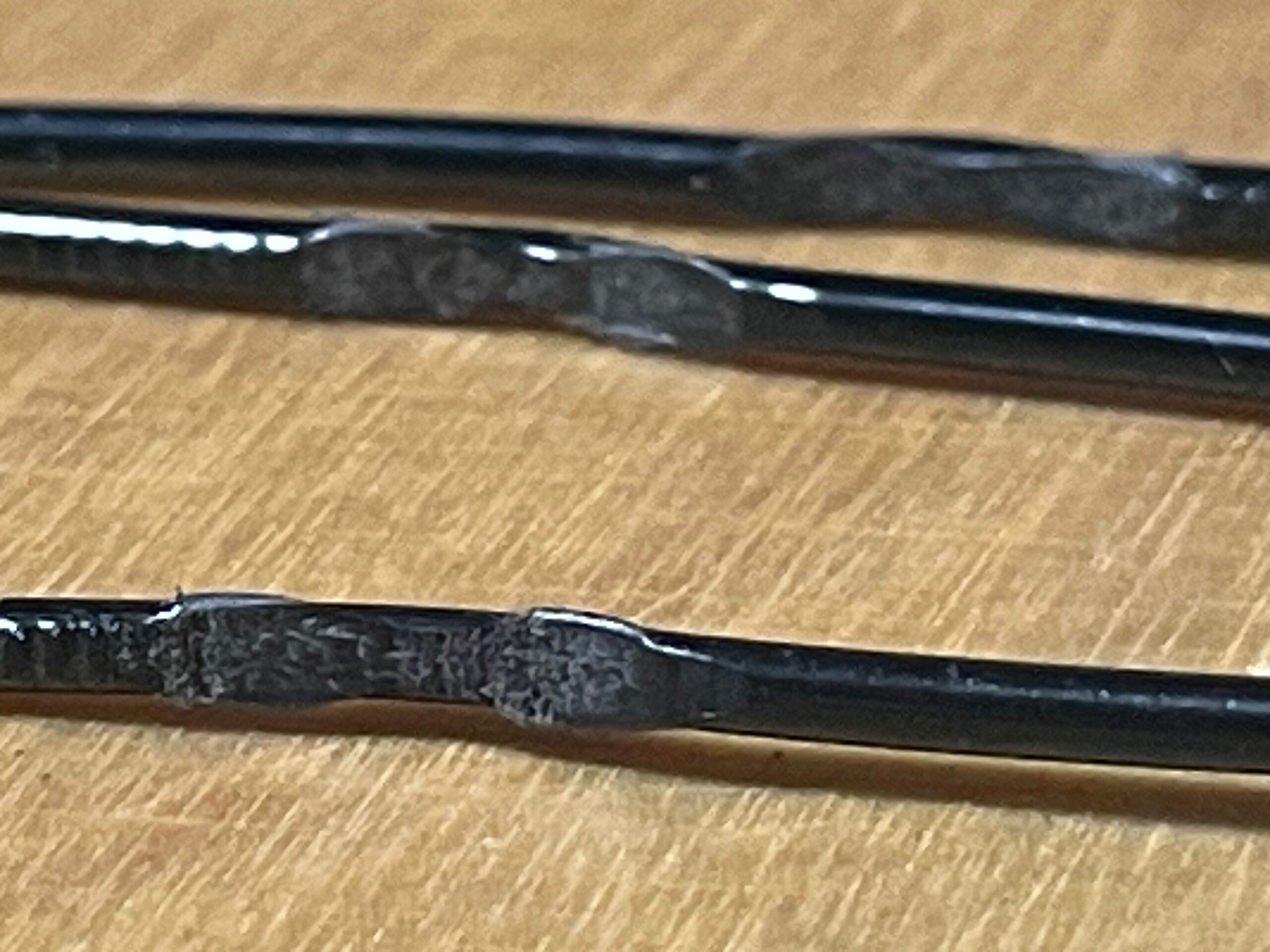

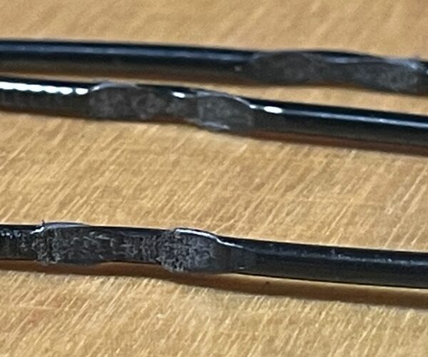

@willgiam,
understand.
You mean, after a certain time, the extruder stops to extrude filament, shows no error and Gear is still rotating? Yes, thats also covered by my solution, I also had that often...
your ejected filament looks like this?
the reason for that is the force, that needs to be applied to the idler to get it working, but that is the Problem, because the original R2 Mainplate has an design issue, close to the idler hinge is a edge that limits the idler movement. If you apply the correct force, the gap between Bearings and pulley is too large to apply the correct force, which results in grinded filament.
If you apply just a bit more, the Idler will be bend and twisted over that edge and results in sidewise bended filament, which then also results in grinded filament, espacially if you print in an enclosure where the ambietn temp is higher.
