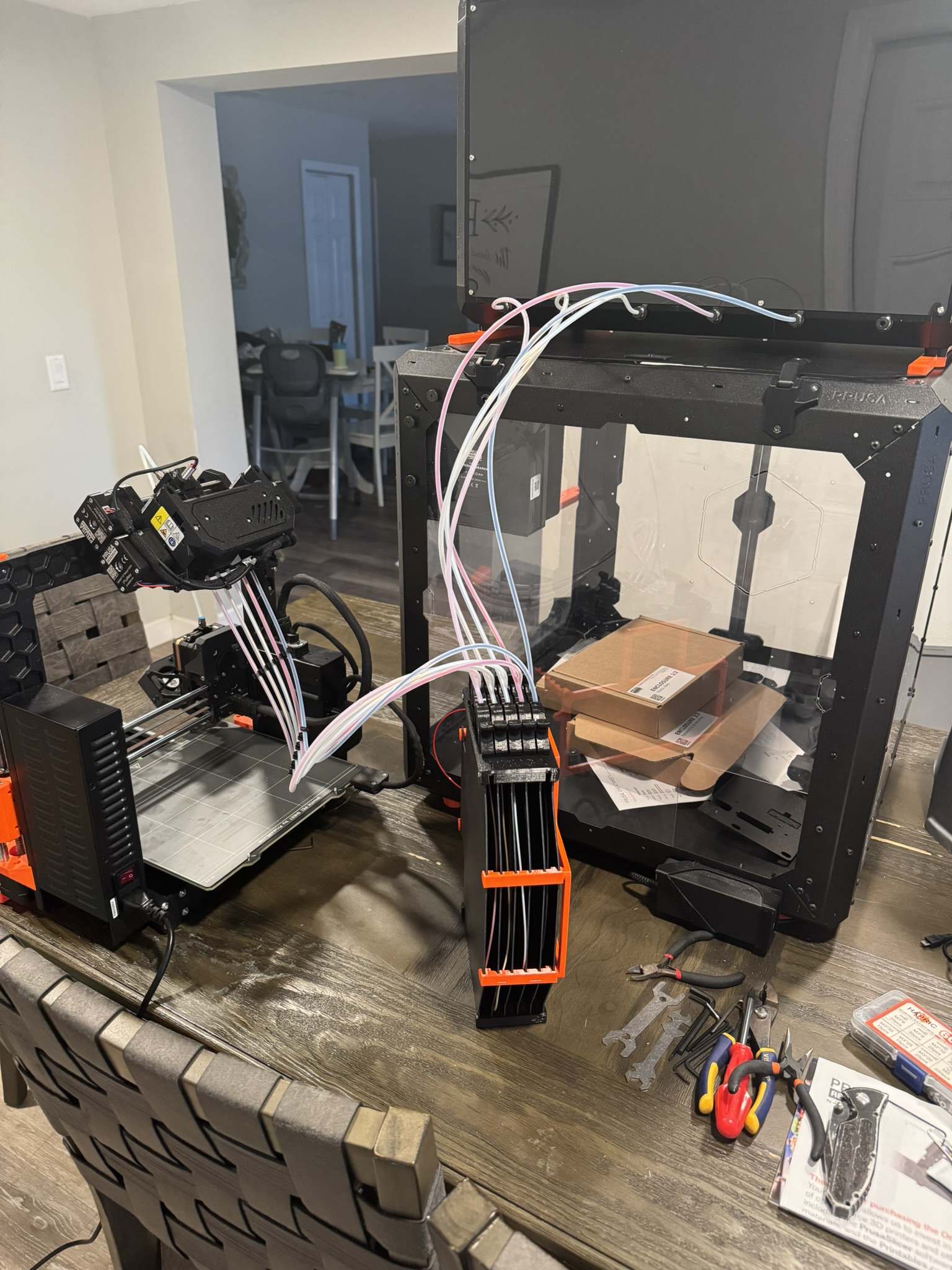

If you post a picture of your setup that might help find other potential issues.
RE: I am not sure what I am doing wrong with my MMU3 unit.
My end goal is to have the printer inside of the enclosure. This is obviously just testing functionality. But, I am currently printing the Auto rewind spool holders for the drybox now. I want to put those in the enclosure.
https://www.printables.com/model/702217-mmu3-mmu2s-5-spools-auto-rewinder-adapter-for-unor/files
Coming out of the back of the enclosure, through this....
https://www.printables.com/model/702362-guide-ptfe-mmu-top-on-prusa-enclosure
into the enclosure into the back of the MMU unit eliminating the buffer all together.
It seems to travel through them smoothly, loading and unloading it. The bearing and gears just seem to be struggling a bit.
Does the layout look as if it can cause problems or is it likely the filament choice? I just had these handy because i've used them lately just to throw in the drybox really quick to test this thing out.

Those filament paths look fine actually. Straighter than mine... 🙂 But to completely eliminate that concern, just open the idler completely and push the filament until you can grab it, and pull it a bit more. If it's not really easy then start looking for restrictions or binding spots.

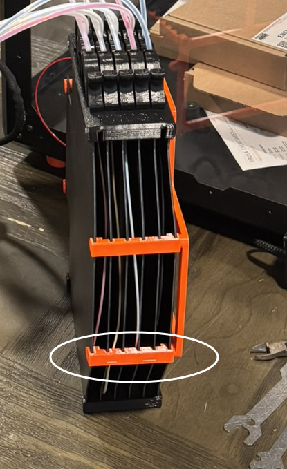

May or not be helpful, but my main issue with the MMU3 ended up being too many clips constraining the filament loops in the filament buffer.
I had rotated mine 90 degrees like yours using a modified base ( https://www.printables.com/model/680464-top-loading-buffer-segmenter-for-mmu3)
and ended up having clips at the front and back of the buffer. This caused an issue that the filaments not always retracted fully from the mmu3 unit. Removing one of the clips allowed the filaments to loop outside the bounds of the filament buffer just slightly (which was enough) and all my problems went away.
e.g. try removing the clip circled here
