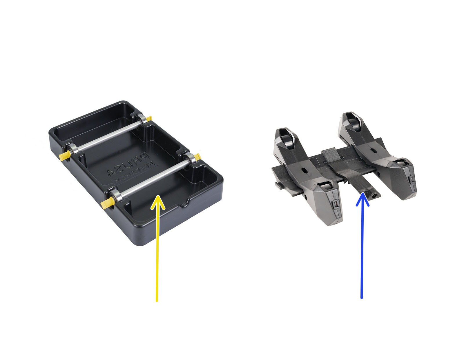

1. Spoolholders
The MMU3 was originally shipped with vacuum-formed spool holders, consisting of steel bearings and aluminum rods. These spool holders are compatible with all supported MMU3 and printer combinations. You can continue using them, even if you move your MMU3 to a different printer.
MMU spoolholders: Vacuum-formed (on the left, yellow arrow) and Injection-molded (on the right, blue arrow)
At the beginning of 2024, we introduced an updated injection-molded variant of the spool holders, offering improved spool arrangement and the ability to connect the holders together. These new holders are compatible with all supported MMU3 and printer combinations, with a small exception. After months of extensive testing, we found that worn wheels could potentially lead to loading issues specifically on MK4 and MK3.9 setups. As a preventive measure, we've upgraded the material of the wheels, and MK4/MK3.9 MMU3 packages will now include these updated wheels. If you're using MK3S+ and MK3.5 setups, there shouldn't be any issues. However, if you're upgrading your existing MK3S+ MMU3 setup to MK4/MK3.9, we recommend changing the wheels (wheels are part of the upgrade package).
Conclusion: There are no changes in the MK3S+ and MK3.5 setups. However, for MK4 and MK3.9 setups, it's recommended to change the new spool holder wheel for the injection molded variant (part of the upgrade package).
