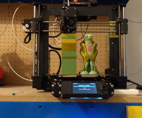

RE: MK3S+ upgrade to MMU3 first or MK3.5 first
I have been using Air Buffers for years...
on
MMU1,
MMU2,
MMU2S
MMU3 and Palette 2S Pro
This happens to be a mk3.9 but the same setup worked on my mk3 I just don't have pictures handy
MMU1 still in service, Haven'tused it since.... Last night...
Hopefully this diagram will help.
Hi Glenn
I am using Prusa MMU1 spool holders for the MMU1, and Prusa MMU2 spool holders for the MMU2... BUT I have added larger diameter rollers on the 8MM shafts, to reduce friction. rollers are about 25mm diameter, with a raised section at each end, to stop the spools falling off the rollers.  there is not a lot of space above the printer,
Yes, there is a shelf above the printer which is just wide enough for one spool holder, front to back, and  Nine spools along the shelf. four for the MMU1, and five for the MMU3
In a temporary location I Suspended the five spools of filament on a broom handle and that worked too  🙂 It was better with the filament coming off the bottom of the spools than the top of the spools,
when the filament came off the top of the spools there was more liklhood of the filament spilling over the edge of the spool and causing problems
