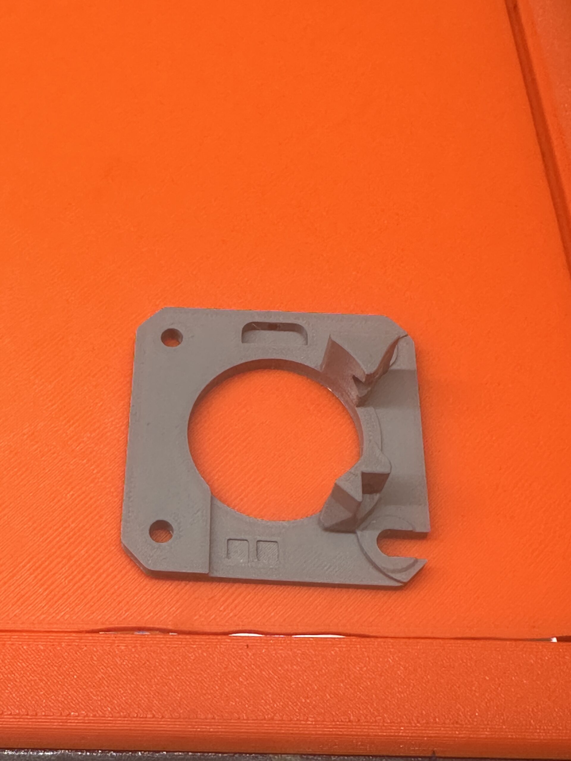

Another test, now with PrusaSlicer 2.7.3; MK4 FW 6.0.0 and MMU3 FW 3.0.3. In the first all mechanical parts where MK4 original.
First: the new ramming is a big game changer! The tips are more or less as cutted with a knife; no stringing.
In my last test (s. above) i was experiencing 3 problems:
- filament sensor stuck
- not correct loaded filament (sensor was triggered, but filament was not loaded into nozzle)
- high amount of debris.
With the new firmware a not correct loaded filament is detected. The MMU3 tries 3 times to reload, then you need to interact. This happened surprisingly a lot of times. But everytime I was cutting the tip with an angle, the load was without trouble. This leaded me to the assumption, that a perfect flat tip is creating another problem: the filament is not guided into the nozzle but stops at the edge.
I did a analysis of the main-plate-R2 and found, that the diameter of the lower filament guide was larger than the diameter of the nozzle entry. Therefore, by mechanical missalignment or tolerances, the filement could not enter the nozzle.
I did a small redesign of the main-plate-R2 an implemented a small funnel, so that the output diameter is now 2mm whereas the nozzle diameter is 2,5mm. By this measure the filament was guided 100% of the time into the nozzle. And as a side effect there were no debris in the nextruder!
I think the remodeled part from Prusa will just do the same.
I printed the part with PETG, 0,05 layer thickness. The whole needed a bit of rework (2mm drill of a round file will do it).
My modiefied main-plate:
The question will be how long the part can print (PETG) or if I have to order the spare part from Prusa.
Result with 480 tool changes without any interaction:
For now I'm sattisfied. Next test will be with supporting material.

the stl for the changed main-plate
This post was modified 12 months ago by Volker
Posted : 31/03/2024 1:39 pm
Volker
(@volker)
RE: Experience MK4 with MMU3
the upload did not work - another try:
Posted : 31/03/2024 1:49 pm
GerryPB liked
Witties
(@witties)
Very nice design !
I am going to try and print it in poly carbonate
Thanks

Witties
(@witties)
Perfect in PC Blend !
