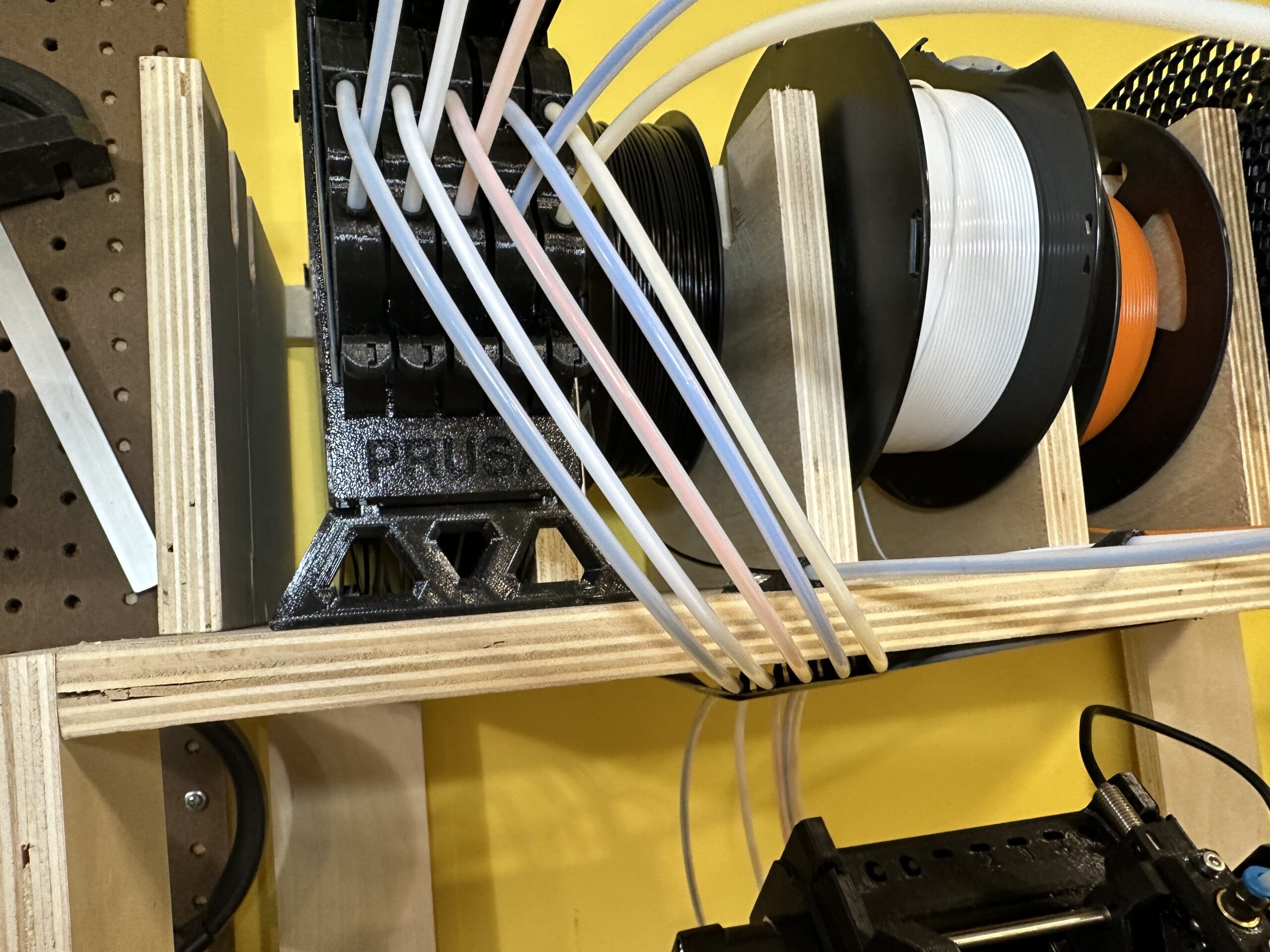

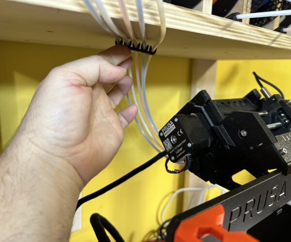

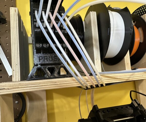

I don't think this is a resolution, since it's so finicky, but I've found a temporary fix - whether the filaments in slots 4 and 5 load properly has become extremely alignment dependent! If the tubes going into the MMU aren't aligned just right, then those two won't load. (And, yes, I've pulled the filaments out and cut the ends off at slants again, and made sure there are no divots or dents in the filament from the pulleys grinding against them. I've also opened up the MMU and cleaned the pulleys, blew out any debris, and so on.) This is a new development. It wasn't an issue a week ago and it is now.
I have a temporary solution, but I'd like to know what I'm doing or what changed that suddenly makes a perfect tube alignment so important. My best guess is that this is a high humidity climate, so if a filament has been out for a while, even in the tubes, that maybe the humidity is effecting it and that may change how it feeds into the tight area where the idler bearings push against the pulleys. I'd love to hear more if anyone has run into this or what I should do, other than re-aligning the tubes, to create a permanent solution.
This is how it's been set up since I finished installing it:
The PTFE tubes feeding into the MMU have been in this position since I stared using it. Then, while working on it, I took the MMU3 off the frame and set it to the side, where I could see what was going on more easily and so I could clean it out. Testing with the MMU to the side worked fine for loading all filaments. I put it back on, re-tested, and it wouldn't work for 4 & 5. After a few experiments, I found it was positional. Those filaments loaded fine with the MMU to the side, but would not load with it on the printer.
I've had to make an adjustment and both the trouble filaments loaded fine:
For now, this is my solution:
That's with duct tape holding it in place. There's a bit of pull on it from the tubes feeding out of the cartridge/buffer, so one of the first things I'll be printing while it's like this is a bracket to hold the tubes in place. I've found this is quite sensitive to whatever angle or position it's in, so I think I'm going to make a bracket that makes it easy for me to change the position easily if needed. Maybe even something like some kind of simple pegboard design that goes on the plywood and a bracket that plugs into it, so I can change the alignment if needed.

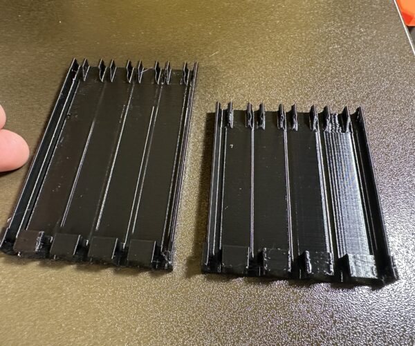

I downloaded the STL file. I made a 2nd and, instead of just changing the Z axis to 200%, I checked the total length and it's 26mm. I loaded it into Blender (my 3D editor) and extruded the end by 25 mm, so it's basically double length, without changing the ends to make it harder to snap the tubes in. I printed both the original and the longer one and tried the longer one. It helped, some. It didn't work in my preferred printer position, but did work close to that. I snapped the original length one on to the tubes right after it and that helped - still took a bit of jiggling to make it work.
I'm printing out a test part for my current project, but when that's done, now that I have a 1x length and 2X length, I'm going to print out a 3X and 4X as well and check to see if the 3X works. (I think the 4X will make it hard to fit in because it'll use enough tubing it'll make the curves from the buffer cassette a bit tough to do.

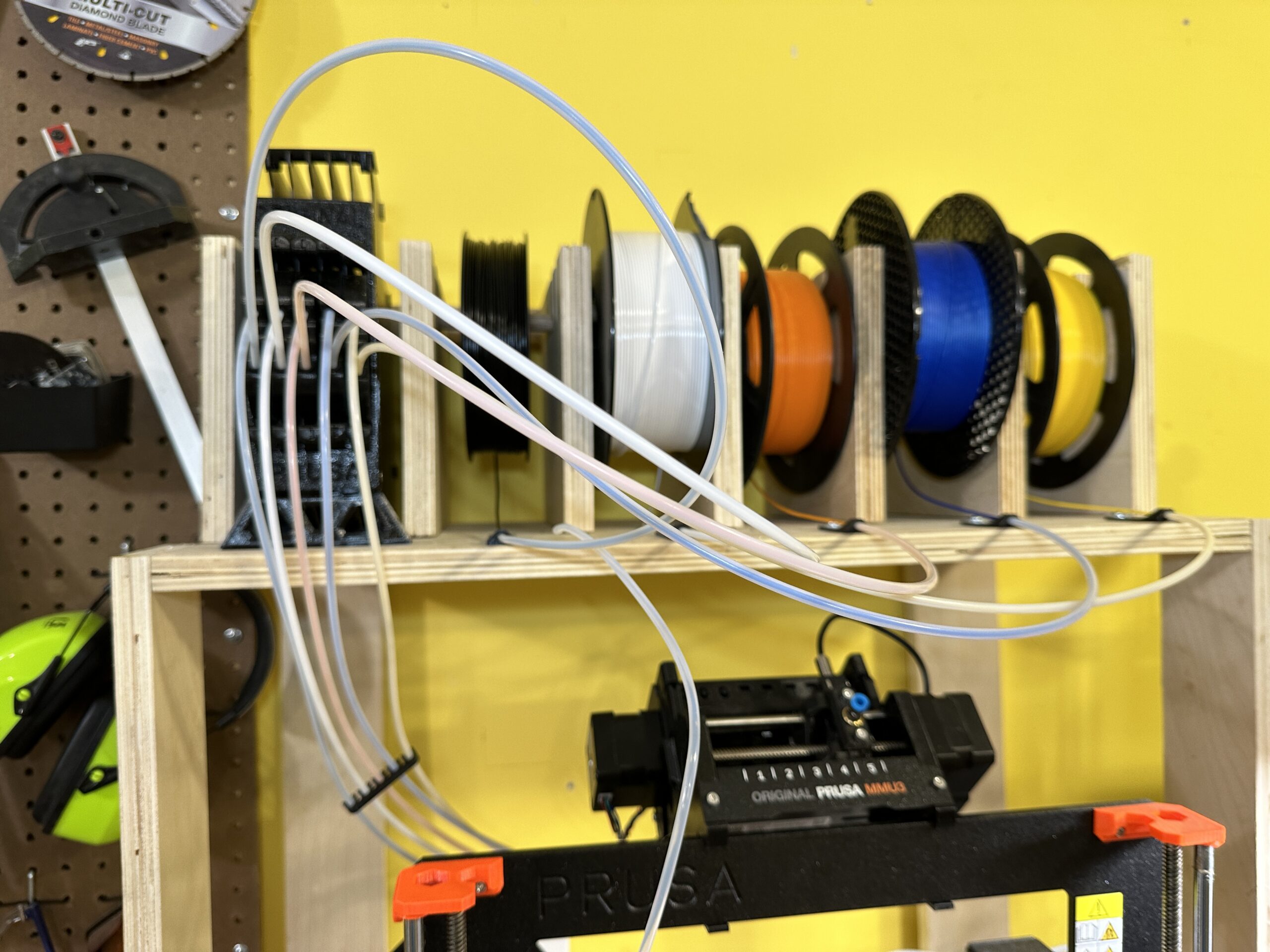

I'm going to provide updates until I feel 100% sure I have a 100% solution.

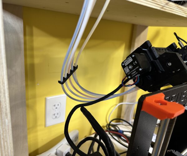

I printed out longer guides, the 3x and 4x I referred to in the last post:
I put my fingers in there for scale. I created these longer guides in Blender by just stretching the featureless middle part by 25mm for each longer version. I would have liked to have gone with the 4x version, but it looks to me like the distance in between the two ends is so long it's going to be easy for the tubes to flex more than I'd want in that long straight area, so I went with the 3x. It worked with simple tests.
I'd like to do a 4x version with another clip in the middle, like the one on the end, so the filaments are held in place for that long stretch of space. I don't know when I'll have time to do it. (But if the 3x doesn't work, you can bet I'll find time in a hurry to do the 4x with an extra guide!) I suspect the 4x one would eliminate this problem entirely IF it had another pinch point in the middle, or maybe 2 more of them, each 1/3 of the way along.
