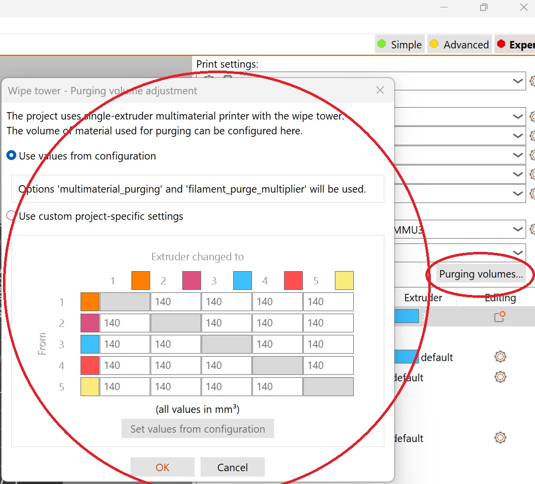

Good evening Rene,
some colours 'Bleed' more than others, so when you do a colourchange with MMU3, there is a default 'Purge Volume' allocated by Prusa Slicer,
If you find a colour pair which do not purge with the default 140mm/3 purging volume, you can alter the values in Prusa Slicer
Please be aware that if you use two different materials, e.g. PLA Supports for PETG Models, you also need to increase the purging volume to ensure the mixed filaments do not weaken the model in the vicinity of the support elements

As a test, I increased the purge volume from 65 to 150 and the results were identical. As a definite test, I split my Prusament black spool filament into two spools (to make sure the properties of the filament were identical in the two spools). I then proceeded to print the part (black background with black X), once again, the results were identical (you could see different black color bands in the picture below).
So the black on black test rules out any kind of color blending. So if this is not a color blending issue then why is this happening?
