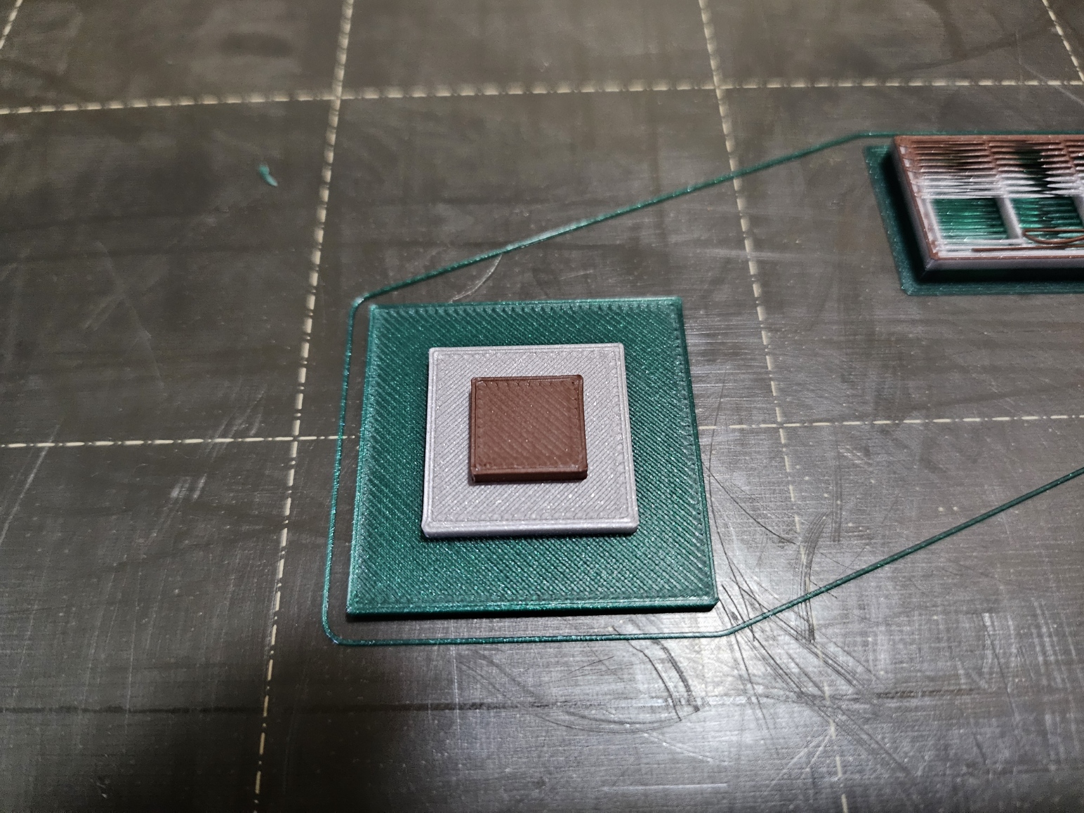

I was able to create a MK4-MMU3 profile. Loading and changing of Filament is working. But nothing is extruded.
I tried a gcode created with the MK3-MMU3 profile. It started as expected. Sometimes the first layer is printed correctly. The Filament is changed as expected and the second filament is loaded - but nothing is extruded.
I think the filament is not pushed in the extruder enough after the sensor has detected the filament. So the gear is not catching the filament.
Any idea how to get the filament pushed in? Or is this parameter hard coded in the firmware?

Actually I'm using the same tube and I think the length of the tube will not make any difference. The MMU is feeding the filament up to the point when the filamentsensor of the extruder is triggering. Then the extruder has to take over. At the MK3 the filament sensor is triggered by the extruder gear itself. So if the sensor is on, the filament is in the extruder gear. At the MK4 there is a bit of distance. So the MMU has to feed a couple of mm more to give the extruder gear a chance to grip the filament. If there is no way to force this by gcode there might be no chance to make it happen with the actual firmware (MMU and MK4).

There is a gcode for "extra load distance":
M708 A0x0b X10
With this code in the start gcode section I was able to load the filament. Now I'm fighting with the tool change during the print.

I just printed in two colors on my MK4 with an MMU3. I used the MK3s+ with MMU printer profile. When I sent the file to the printer via Prusa Connect, the display said the gcode isn't fully compatible and the printer model doesn't match. I was offered the option to run the printer in MK3 mode, I did. Next on the tools mapping page the two filaments I picked in prusaslicer (2 and 3) were displayed with question marks beside them. I selected print. The next screen said, detected mismatching filament types. I selected print anyway. After the usual delays the printer printed the item in the attached photo. I'm going to try three next.

MK4 firmware 5.1.3, Prusaslicer 2.7.1, MMU3 3.0.1
I was able to print a simple piece in 3 colors last night. I used the MK3S+ MMU3 printer profile. In the printer start gcode, 3rd paragraph I removed the line above {endif} G92 E0.  Just printed the attached three color piece.
