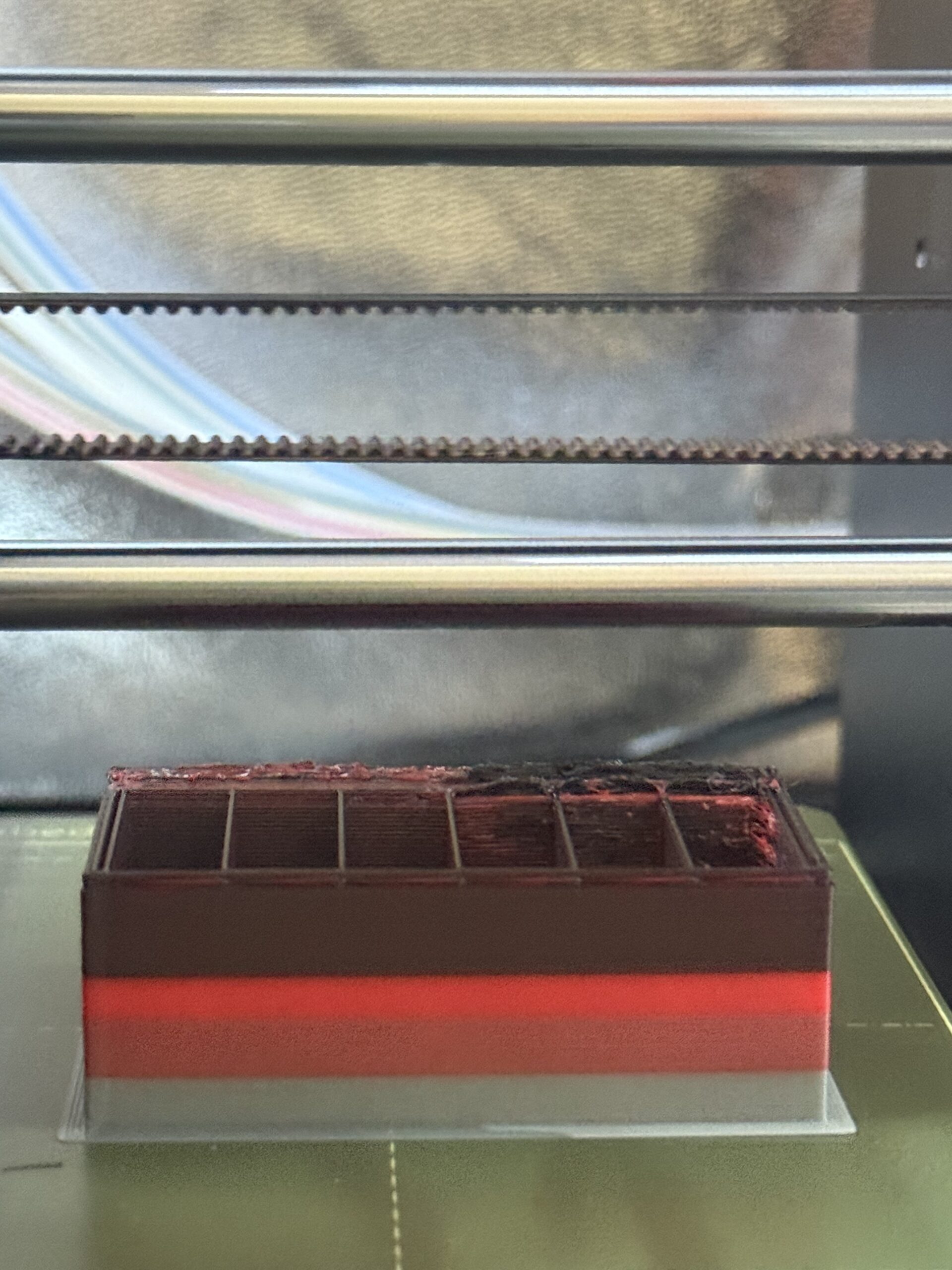

Wipe tower issues - Jumping

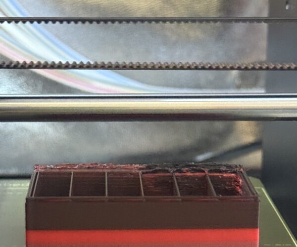

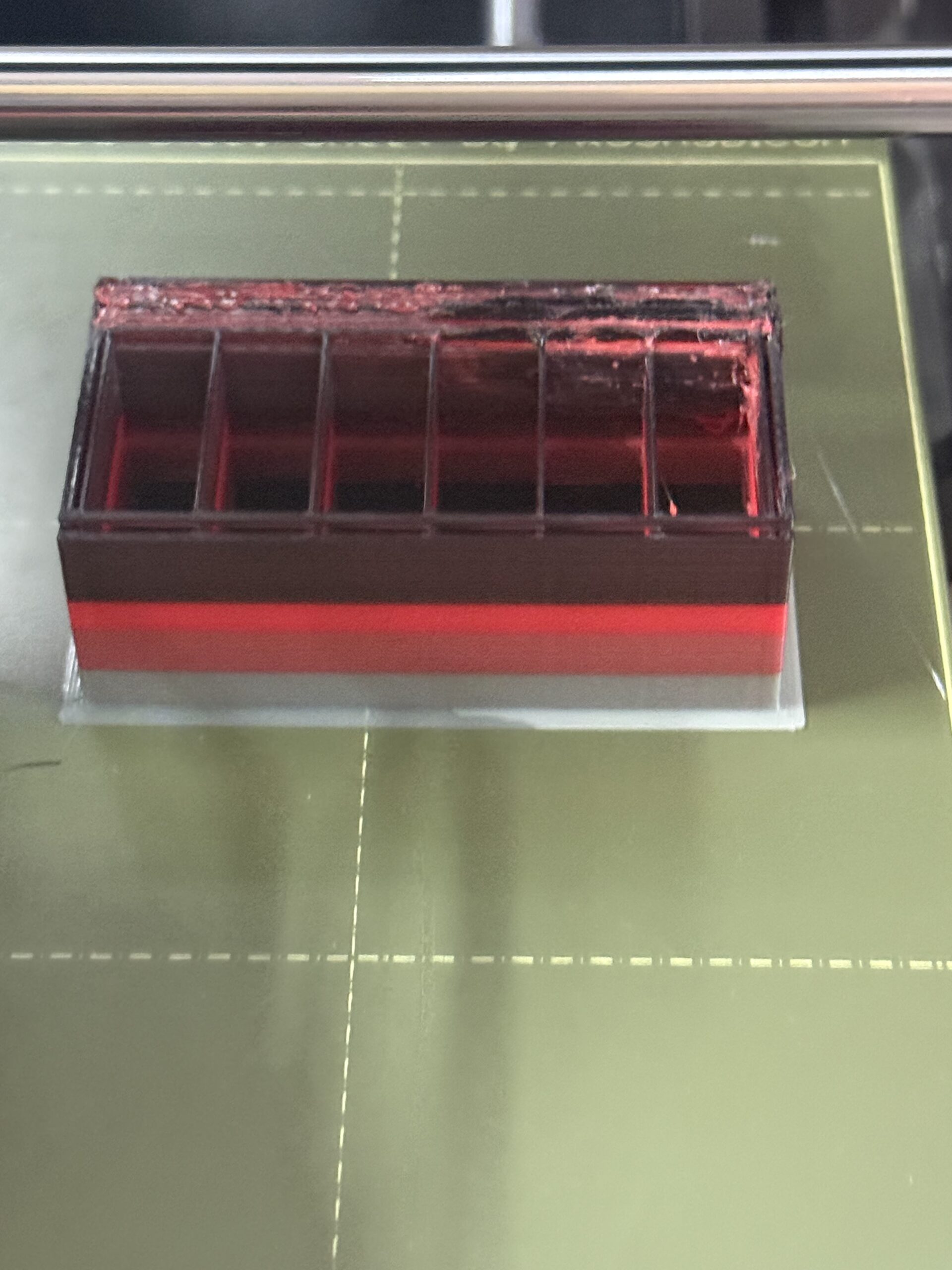

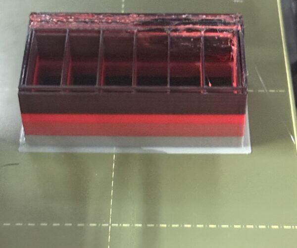

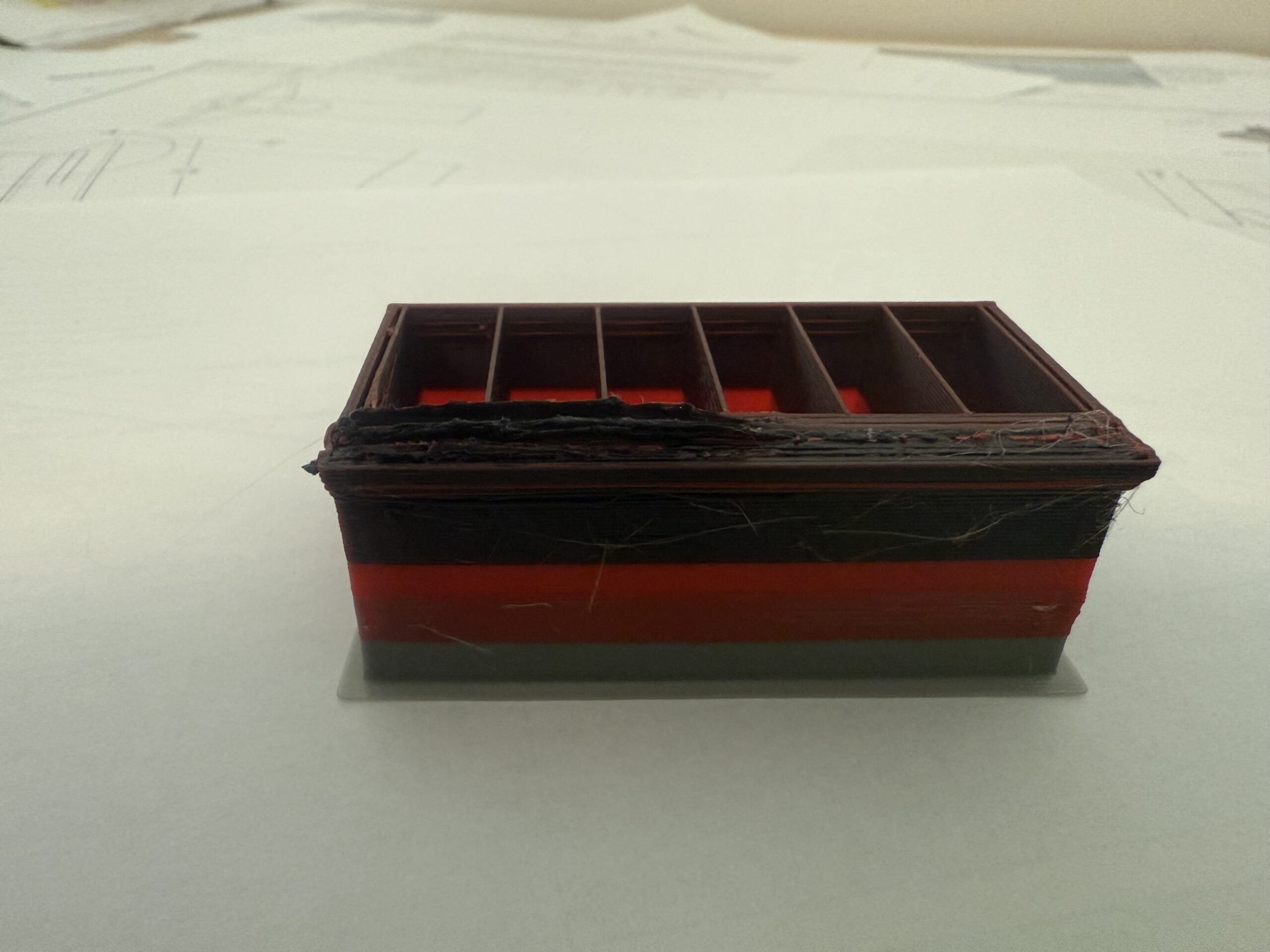

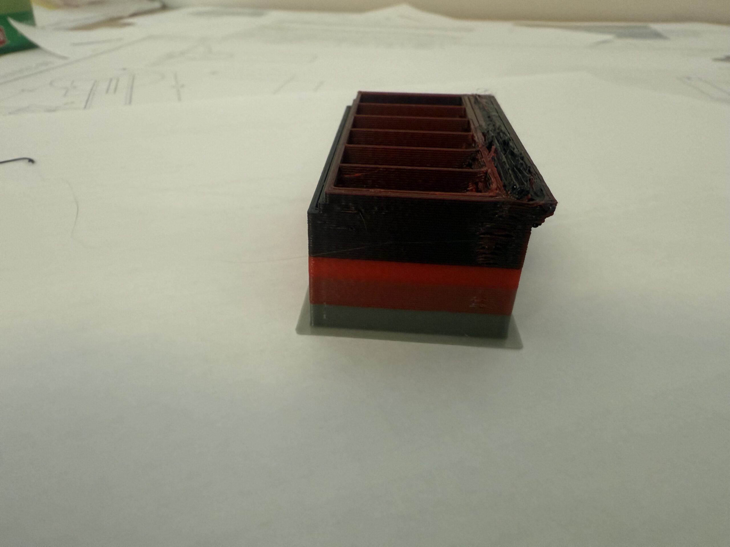

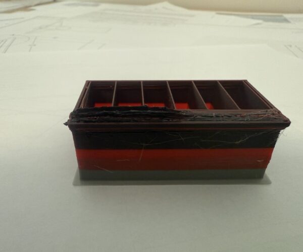

why does this keep happening?
Not sure what needs to be changed, prints work sometimes but not others
printing with PETG @ 230

I have the same issue on some prints. Have you determined what the cause was?

+1.   I've seen the same lumpyness "issue", sometimes its impactful, sometimes its not.   Its obviously where the filament change occurs, but I've got nothing...

Stumbled across this while googling..
https://github.com/prusa3d/PrusaSlicer/issues/14784
Seems relevant, haven't tried the cooling moves recommendation at the end however.

One similar problem I've seen repeatedly: The nozzle stays too close for the wipe tower during filament change, melts the material, causes lumps and eventually gets stuck.
Result: Layer shift.
Solution: Put this into Printers / Custom G-code / Tool change G-code:
G1 X10 Y100 F5400
and make sure X=10 Y=100 (e.g.) is an empty spot (use toolpath previewer to confirm, avoid traveling over objects).
I've seen the above failure mode with all-stock settings and consider it a bug.
