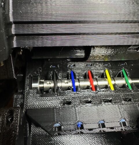

Clark Moore
(@clark-moore)
RE: MMU3 Doesn't accept filament
I had this issue..., still have it since I'm waiting for PRUSE to send the missing parts. I opened the idler door and inspected the assembly. It came fully assembled so I didn't do this at the start. Two of the five pullies were loose and missing their grub screws. Those are what are coming from PRUSE.
