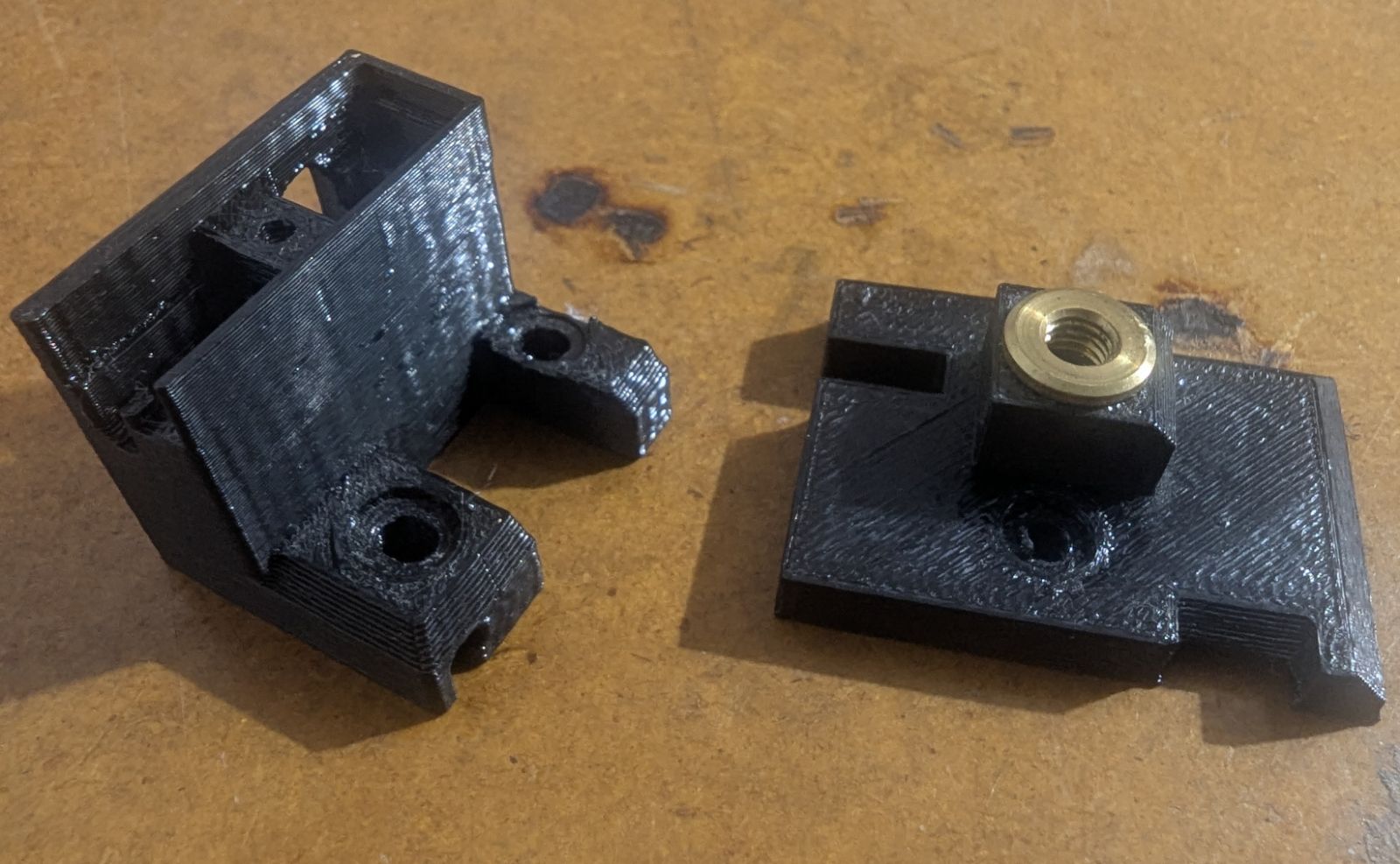

I got the upgrade kit from Prusa a long while back and just getting to actually installing it. Was it supposed to come with an upgraded chimney base? The one I have from the MMU2 as shown in the attached photo does not match the upgrade manual.
Did I misplace the base? Or is it recommended to print a new base and extract the brass insert from this old chimney?
I have already completed the MK3S+ upgrade and been printing with it for a while, and am now trying to finish the MMU3 upgrade.
Best Answer by Charon:
I removed the brass insert from the mmu2 chimney, and am printing the mmu3 extruder chimney, hope it works out.

Seems to have worked. Used a panavice to press the brass insert into the new part.
