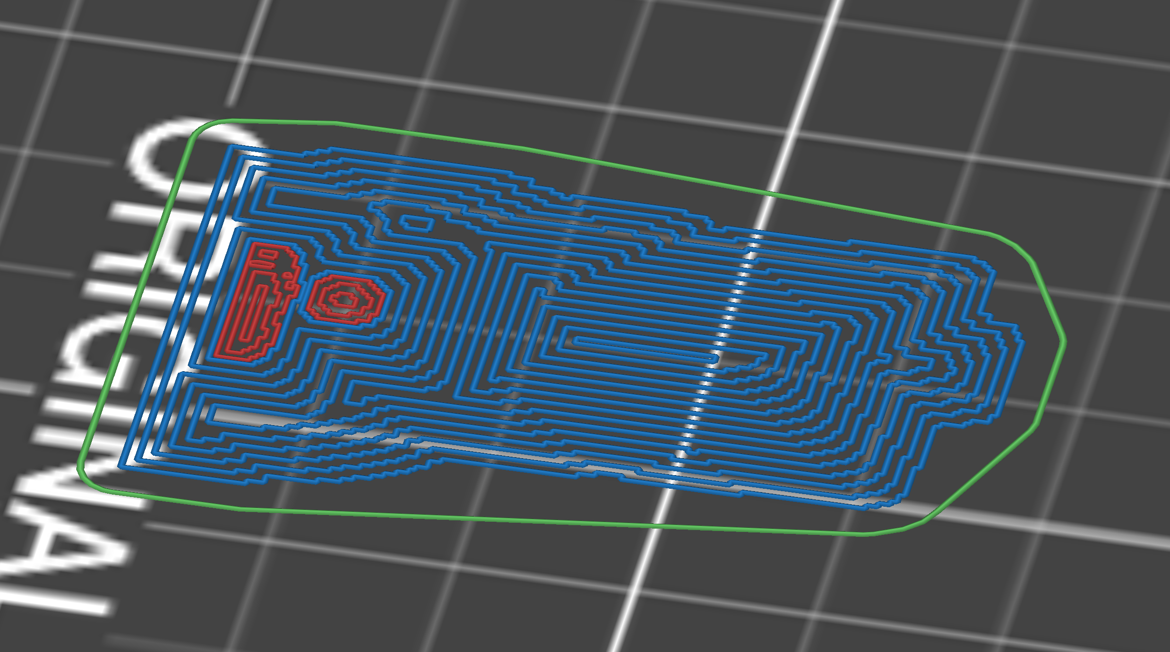

When trying to use soluble support with MMU2, the base turns out like this:
this means that if the nozzle touches anything, it will start to unravel everything from the hotbed, in a long string. This happens without failure...
How do I make the first (support) layer solid so it sticks to the bed?

you have to use the glue stick if i remember. and the BVOH has to be REALLY dry, it sucks in water fast and usually you have to bake it for a few hours to dry it back out. even NEW in the bag it can be too wet.

Oh, it sticks just as well as PLA, that is - it's fine if it's making a solid wide base. I guess the answer is that this is a slic3r bug, so I'll file that as an issue.

https://github.com/prusa3d/Slic3r/issues/1445

I've seen the same thing, no matter how dry I keep it, things seem to go better after getting baked. 🙂
I use wood glue diluted in alcohol in a spray bottle and it gives me a nice thin coating that dries quickly and evenly.
