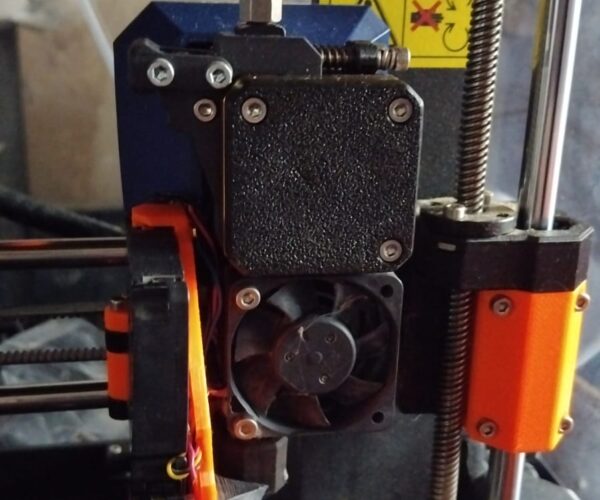

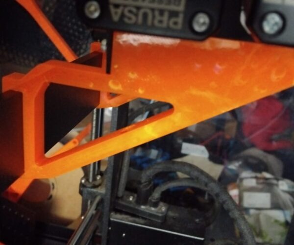

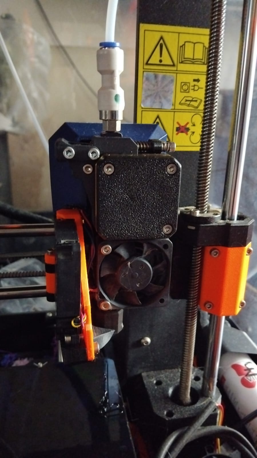

I have just gotten a mmu2s second hand, for my mk3s+, but it is barely used. I have now set it up, but when i try loading the filament, the mmu pushes the filament throgh the tube from the mmu to the extruder until the filament activates the ir sensor, and then the mmu disengages. Then the extruder bondtech gears first pull the filament a bit down into the extruder, then pushes it up, to a point where it sometimes cant grip it again, other times not the case, then pulls it a little bit down again, and then pushes it up again, where the mmu takes the filament back, and gives me the failed to load message. Sometimes, the gears grind so much on the filament (im using PLA), that it gets stuck, and i have to disassemble it to get the filament out. (and i have made sure to cut the filament tip correctly before loading)
I have calibrated the ir sensor and the FINDA and they seem to work fine, i have tightened the screws like prusa says to, but nothing works. I have also tested there is almost no friction in the setup, and i also tried to remove the ptfe tube from the extruder, loosened the idler door screw  (i think that is what its called - correct me if im wrong), and then tried manually inserting filament while the printer was hot, and there was absolutely no problems. The filament just went straight down and out of the nozzle.
My theory is that the mmu isnt pushing the filament far enough, but im not sure.
I also tried calibrating the bowden tube length but i cant find anything on how to get that to work.
If anyone knows something i would really appreciate it, becuse i have spent several frustrating hours on this, but nothing seems to work.

I have found the problem: The spring in the idler door in the extruder was too tight, so i replaced it with a more loose spring, and it seems to work.
But, i am still thinking of doing some upgrades. Is the mmu3 really so much better than the mmu2s, that it is worth 60 euros.
Otherwise, i was thinking if it was possible to print a mmu3 selector and put it on the mmu2s. Or if there are other parts that i can print, to make it function better. If anyone has any suggestions i would be happy.
