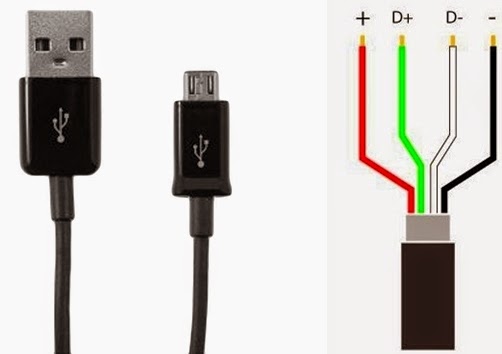

In some other printers that I had this is also an issue. The Artillery LCD even gets turned on from the power from the Pi. I didn't do such a deep research but I suspect that in the PCB, the 5V supply for the electronics is shorted to the 5V in from the USB, so althought the printer PSU is disconnected, everything connected to that rail is still powered up by the Pi.
Since the connection only uses the data pins of the USB and ground (not sure of this last thing, but it's a good practise to keep it), I was able to solve the problem just by cutting the +5V cable of the USB. Normally it's red colored. However there's also models out there which are "inserted" on the USB plug in order to block only the +5V contact.
You can try with and old cable if you wanna keep the original intact. Here's a pic:

There is a thread on the Octoprint forum called something like "Put tape on the 5v pin".
RE: Turn off USB when Printer is off?
That does not work on the Prusa because the Atmega32u2 that is the USB-Serial bridge is powered only from the USB bus. So if you cut the 5v or put tape over it the USB port in the Prusa has no power at all.
