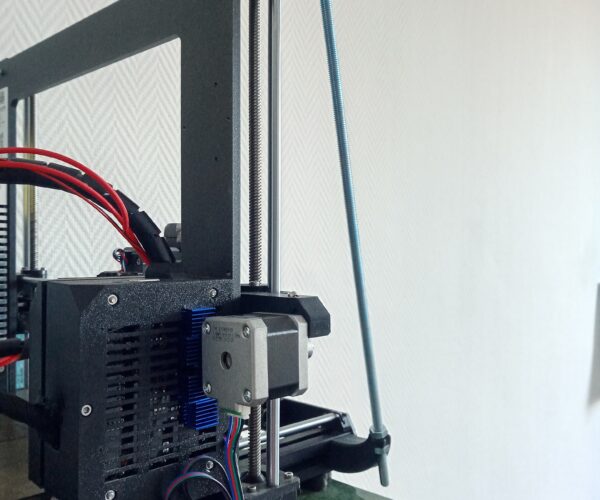

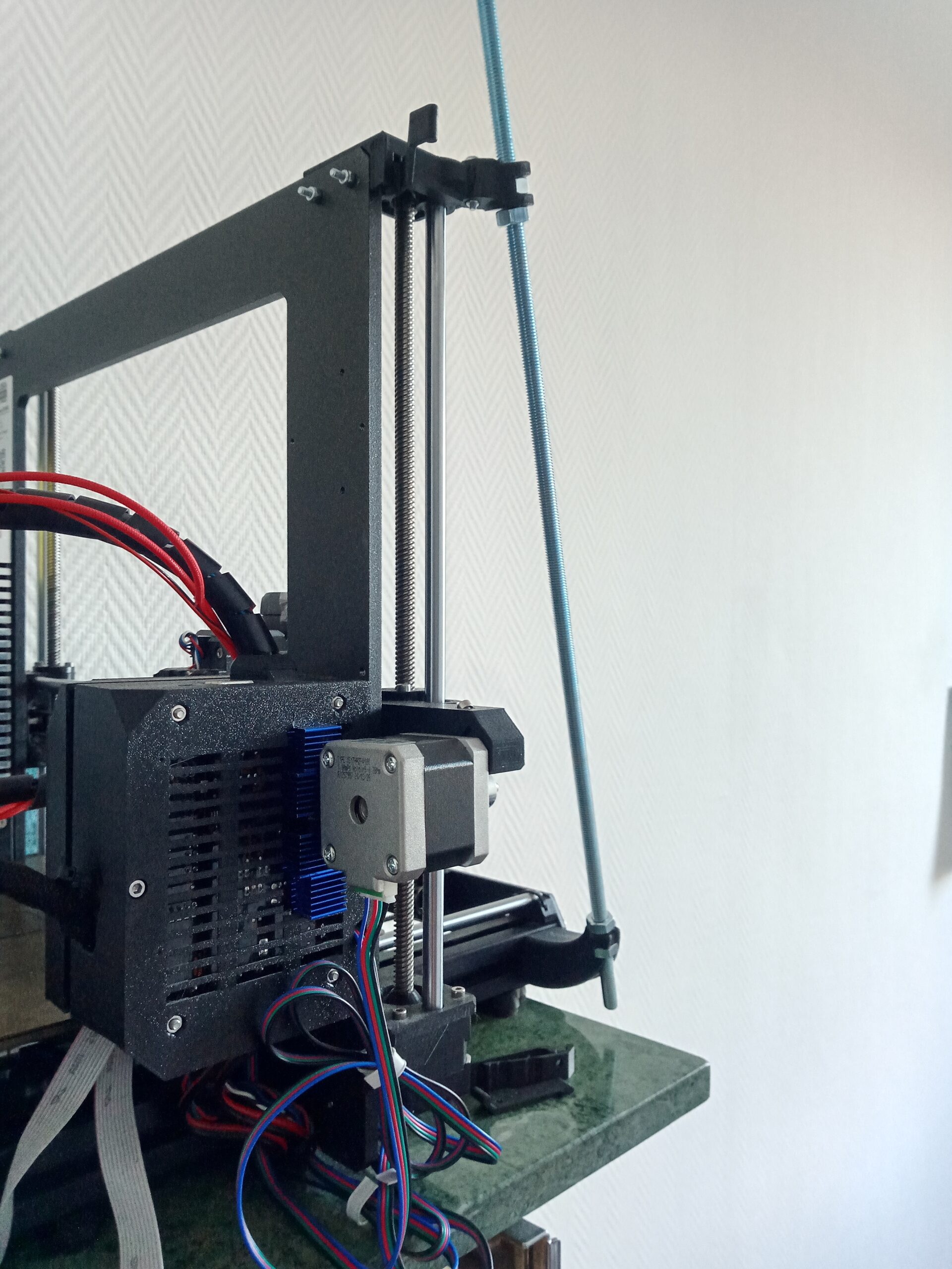

Now, I am changing all the other hardware components involving axis movement. I decided to go with Taurus Prusa axis parts and changed the z-axis including the extra stabilizing z-rods so far without problems. Printing the parts is done with greentech pro material from extrudr. On paper it has better mechanical properties than PLA, but it will be interesting to see how the parts will handle the extra heat from the moon stepper motors and heatbed. So in the future I would like to heat treat PLA after printing, but it will be difficult to retain the right dimensions of the parts I think. Next, I would like to put the bondtech LGX extruder on there with taurus x-axis, misumi parts and a reinforced belt.
If I understood right it should be possible to take the latest prusa firmeware and compare the code with guy´s 3.8.11 firmware and replace the lines commented with KUO right? Since I have the moons and next a bondtech LGX extruder I would then just uncomment the specific lines for moons and bondtech? How would you compare the two firmewares and make the right adjustment, would comparing be possible directly in Audrino? I am sorry for all the questions, but like I said I don´t habe alot of experience with coding, so I can totaly understand if this is too much to ask for.
Attached are some pics of the rebuilt and a comparison of the z axis top printed on stock MK3 in red and with stock + moons below in black. hdr
