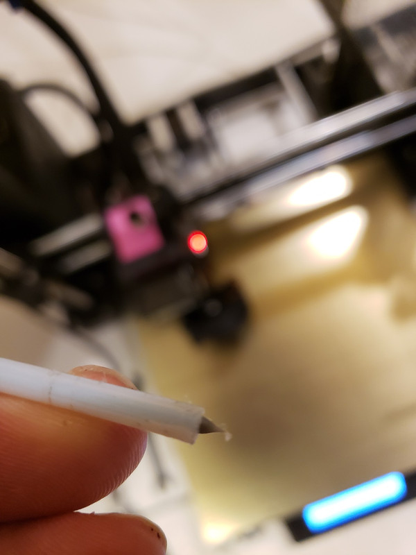

I downloaded the firmware again and redid the needed uncomments, etc, like normal.  Here is a picture of where the filament stops for me, just barely peeking out of the PTFE tube.
I use a pass through PC4-M10 Festo, so the tube touches the top of the sensor, ensuring the filament does not get lost trying to enter the little hole for the sensor - which it enters without any issues (sensor triggers properly).  But then when it backs up, it pushes it too far out and it is no longer near the teeth, so it never pulls it back in.
I did a factory reset before the last update, but I will do it again now just to be sure.  But here is the picture.

I assume this is the top one feeding into the FESTO?
We should probably reduce the distance for the retract move. BUT....
What I don't understand is the filament tip in your pict is well above the Bondtechs. If it was just the Bondtechs retracting resulting in that position is would be about 1 cm out from PTFE end. The Bondtechs themselves can't drive the filament up further by themselves. Is the MMU2S also pulling back or did the filament simply shift position when you pulled it for the pict.
Posted : 03/09/2019 8:16 pm

Cybersage let's have you do some adjustments to can_load in mmu.cpp
Where it now says...

Reduce the retract distance for Skelestruder until it no longer does excessive retraction. Something like...
    #elif defined(SKELESTRUDER)
      current_position[E_AXIS] -= 30; //was 42
If doing that or an even shorter distance doesn't change anything, there is something else that is causing the excess retract. If you find a good distance, let us know here and we'll update my firmware repository.

The hard reset did not change anything.  I will make the edits, and this time I will pay attention to what the MMU does.  You are right, it is surely being moved by the MMU since it is quite a bit above the gears.
I do not have the skelestruder, I have the Bondtech MK3S full upgrade (including the new body, filament sensor, etc.).  I will make the changes to the MK3S parts instead.

My fault, I should have told you which I had.  Easy for me to remember only one, but hard for you to remember many.  My bad.
I already tried adjusting it to -30 and it still failed.  This time, I watched everything that could move.  It appears to stop being pushed by the MMU once it hits the sensor, which (by design) is a bit above the bondtech gears.  At this point, the gears should be pulling it but cannot.  The gears are on the entire time the MMU is pushing it, so it is ready to receive.
I just changed the settings for the += portion to these and am about to test (while keeping the -30, simply because I forgot to change it).
#elif defined(BONDTECH_PRUSA_UPGRADE_MK3S)
current_position[E_AXIS] += 86;  //was 66
Posted : 03/09/2019 8:47 pm
